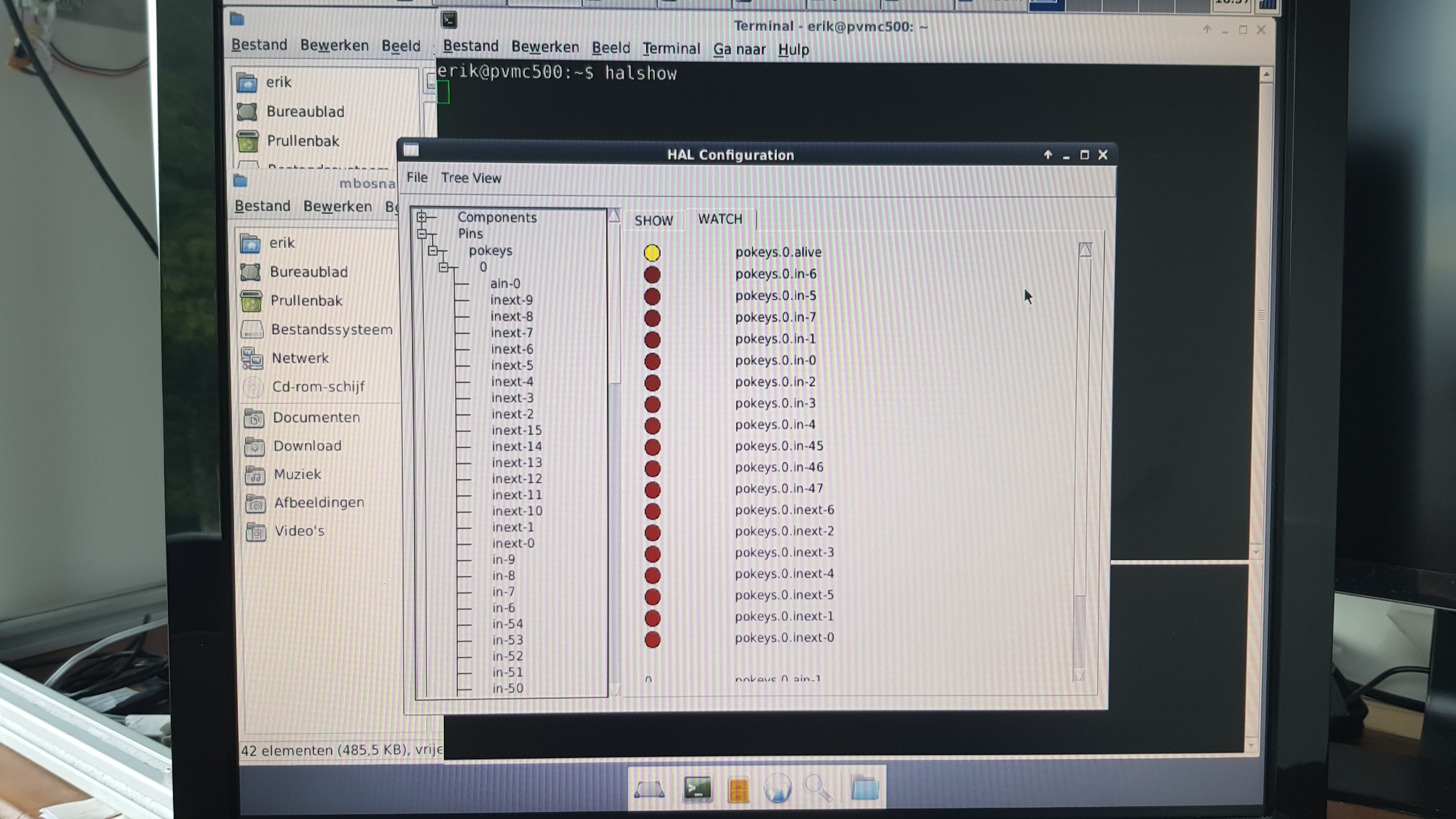

Well...thats clear, i know how to show them. Of i understand, pokeys.0.alive should be blinking?
Noting blinking and no respons of the button.
I whas searching though some photos, saw that the pokeys.comp nstalled i think.
Last lines says; collet2: error: ld returned 1 exit status.

Replied by andypugh on topic Pokeys
"alive" doesn't blink, it just shows true or false (yellow is true, an odd colour choice I agree)
It looks like the install failed because the driver isn't installed.
Can you try re-compiling the driver and show us the result of that command?

I did what you said and it works!!!! I see the dot change collor if i push the button!! Can't see changes on the analog ports if i turn the potentiometer but they are active though.
Thank you for your support!!!
Now search to define pin to do lets say nc start.
Last edit: 30 Jul 2018 21:24 by Erikcnc.

After re-installing my linuxcnc my machine is working.
Unfortunately i had to do the pokeys installation all over....
Yesterday i did that in 1 hour or so. Now in halshow its working again. I can see the pins changing if i push a specific button.
Now i struggle with getting it working in linuxcnc.
I got the setp pokeys.0.devSerial ***** in costom.hal and Loadusr -W pokeys in my_mill.hal with the first pin i want to test.
Still...i got nothing. not even in Halshow in linuxcnc.
net all-home pokeys.0.in-4 => halui.all-homeStill...i got nothing. not even in Halshow in linuxcnc.

I am confused, first you say it is working in halshow, then you say it isn't ?

Yes.
If i do:
And in a 2nd terminal
I can see the pins and see them active if i trigger them.
But, if i open halshow in linuxcnc, nothing happens.
If i do:
halrun
loadusr -W pokeys
Halshow
- Thank you received: 4654

Does moving the "setp" into the my_mill.hal help?
If you start linuxCNC from the command line (command "linuxcnc") is there any helpful output in the terminal?

if i put all the commands in my_mill.hal file i got a error.
this is the (test) code
if i start linuxcnc (program) , the error says:
parameter or pin 'pokeys.0.devSerial' not found
posting 'setp pokeys.0.devSerial 38163' in costom_postgui.hal linuxcnc starts, but no respons from the pokeys
loadusr -W pokeys
# --- ALL-HOME ---
net all-home pokeys.0.in-2 => halui.home-all

You will need to load the component before you try to set any of its hal pins.
Swap the order of those two lines.

Do you mean this?:
Or swap the pin command?
I tried the first one though. Didn't work.
loadusr -W pokeys
net halui.home-all => pokeys.0.in-2
