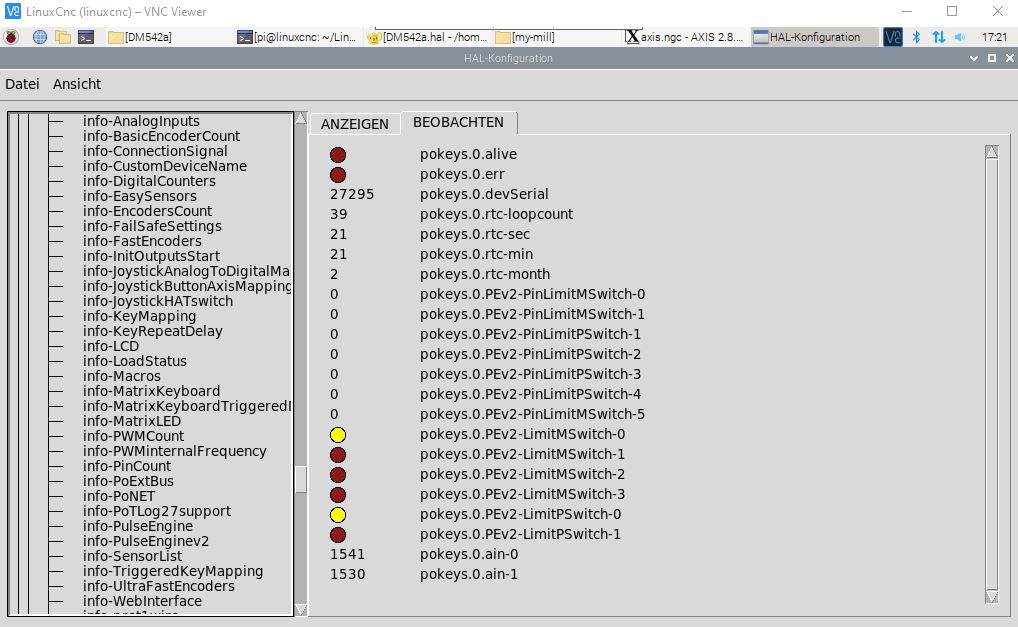

29 Apr 2021 20:52 #207397
by MATZE-ATZE-SCH
Replied by MATZE-ATZE-SCH on topic Pokeys
Hello,
I have LinuxCNC 2.8.0 on Debian 10 and try to install the Pokey57U.
I have followed the steps from Andy on page 10.
In the Halshow I see the Pins, but the pokey.0.alive isn´t blinking and the IN0 isn´t respnse to a switch I connected to the Pokey for testing.
Is this a error because LinuxCNC 2.8, or Debian 10?
In the Terminal with "lsusb" I see the connected Pokey.
Also the compile of pokey.comp seems correct...
Maybe an error with RW permission for the Pokey caused by Debian10?
Best regards
Marcel

- MATZE-ATZE-SCH
- Posts: 51
- Thank you received: 6
30 Apr 2021 18:06 - 30 Apr 2021 18:13 #207473

- MATZE-ATZE-SCH
- Posts: 51
30 Apr 2021 20:26 #207482
by MATZE-ATZE-SCH
Hello,
I have now try a few thinks:
On a different HDD I have installed Debian 9 with Linuxcnc 2.7,
there it works.
Then I have upgrad LinuxCNC to 2.8,
there it worked also, the alive pin is blinking and the switch on in 1 is toggeling.
So I think it is no issue of Linuxcnc or the version of it,
I think it is an issue with the Debian 10?
Best regards
Marcel
there it works.
Best regards
Marcel

30 Apr 2021 23:05 #207506
by MATZE-ATZE-SCH
OK, finally I have got it to work!
I have set in the
90-usb-pokeys.rules
the Mode to 666
SUBSYSTEM=="usb", ATTRS{idVendor}=="1dc3", ATTRS{idProduct}=="1001", GROUP="plugdev", MODE="666"
Then, while LinuxCNC is running, I have unpluged and replugged the Pokey, and then it works, even when I replug it or restart the PC...
I have set in the
90-usb-pokeys.rules
the Mode to 666
The following user(s) said Thank You: andypugh, robins, LAUSCH

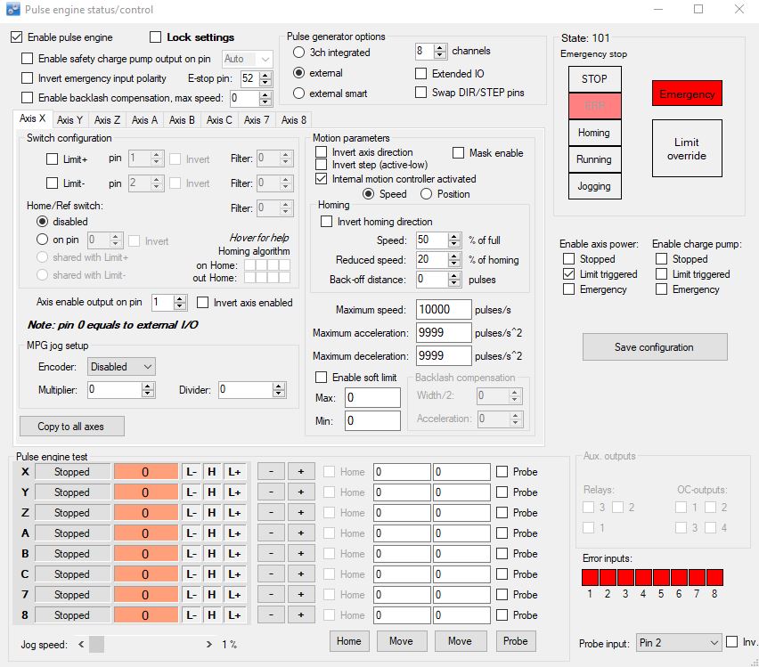

- to be able to use the pokeys PulseEngine instead of Dir/Pulse signals (due to limitations of updatefrequency ). as a sideeffect i can also use PEv2 channels for E-Stop,Enable,Limit
has anyone already tried to use the pulseengine directly?
i assume as a first step i would need to somehow translate the stepgen interface
to PEv2
these channels are available (1:1) already in the comp, but besides the pins i'm currently investigating on how to use them.
some parts might be just a kind of unitconversion [m/s] to [pulses per ms], others might be more complicated (eg. until now i did not find any good explanation how to use MotionBuffer correctly).
Any tips, hints suggestions are welcome.
BR
Dominik
i want to thank you for all the work and investigations done so far on this topic.i'm currently running a RasPi4 on latest build of LinuxCnc and added the pokeys.comp attached to this thread.
To contribute i'm currently extending that comp-file ( github.com/zarfld/LinuxCnc_PokeysLibComp.git )
- i already use the info parametrized on the dev, to see if the Pin is used as DIN, DOUT or AIN
- it should work with both USB and NET devices (i could test with 57E only)
- RTC is being read

int32_t CurrentPosition[8]; // Current position
int32_t PositionSetup[8]; // Position to be set as current position
int32_t ReferencePositionSpeed[8]; // Reference position or speed (position or pulses/s)
int8_t InvertAxisEnable[8]; // Invert axis enable signal
int32_t SoftLimitMaximum[8]; // Soft limit maximum position
int32_t SoftLimitMinimum[8]; // Soft limit minimum position
uint8_t HomingSpeed[8]; // Homing speed per axis (in %)
uint8_t HomingReturnSpeed[8]; // Homing return speed per axis (in % of the homing speed)
int32_t HomeOffsets[8]; // Home position offset
uint8_t HomingAlgorithm[8]; // Homing algorithm configuration
uint8_t FilterLimitMSwitch[8]; // Digital filter for limit- switch
uint8_t FilterLimitPSwitch[8]; // Digital filter for limit+ switch
uint8_t FilterHomeSwitch[8]; // Digital filter for home switch
int32_t ProbePosition[8]; // Position where probe detected change
int32_t ProbeMaxPosition[8]; // Maximum position to travel to until stopping and returning error
float MaxSpeed[8]; // Maximum axis speed (in pulses per ms)
float MaxAcceleration[8]; // Maximum axis acceleration (in pulses/ms/ms)
float MaxDecceleration[8]; // Maximum axis deceleration (in pulses/ms/ms)
int32_t MPGjogMultiplier[8]; // MPG jog multiplier value
uint8_t MPGjogEncoder[8]; // MPG jog encoder ID
uint8_t PinHomeSwitch[8]; // Home switch pin (0 for external dedicated input)
uint8_t PinLimitMSwitch[8]; // Limit- switch pin (0 for external dedicated input)
uint8_t PinLimitPSwitch[8]; // Limit+ switch pin (0 for external dedicated input)
uint8_t AxisEnableOutputPins[8]; // Axis enabled output pin (0 for external dedicated output)
uint32_t HomeBackOffDistance[8]; // Back-off distance after homing
uint16_t MPGjogDivider[8]; // Divider for the MPG jogging (enhanced encoder resolution)
uint8_t reserved[8]; // Motion buffer entries - moved further down...
uint8_t ReservedSafety[8];
uint8_t PulseEngineEnabled; // Pulse engine enabled status, also number of enabled axes
uint8_t PulseGeneratorType; // Pulse engine generator type (0: external, 1: internal 3ch)
uint8_t AxisEnabledStatesMask; // Bit-mapped states, where axis enabled and charge pump signals are active
uint8_t PulseEngineStateSetup; // Pulse engine new state configuration
uint8_t PulseEngineBufferSize; // Buffer size information...
uint8_t motionBufferEntriesAccepted;
uint8_t newMotionBufferEntries;
uint8_t HomingStartMaskSetup; // Bit-mapped axes indexes to be homed
uint8_t ProbeStartMaskSetup; // Bit-mapped axis indexes for probing
float ProbeSpeed; // Probe speed (ratio of the maximum speed)
uint16_t BacklashWidth[8]; // half of real backlash width
int16_t BacklashRegister[8]; // current value of the backlash register
uint8_t BacklashAcceleration[8]; // in pulses per ms^2
uint8_t BacklashCompensationEnabled;
uint8_t reserved_back[3];
BR
Dominik
