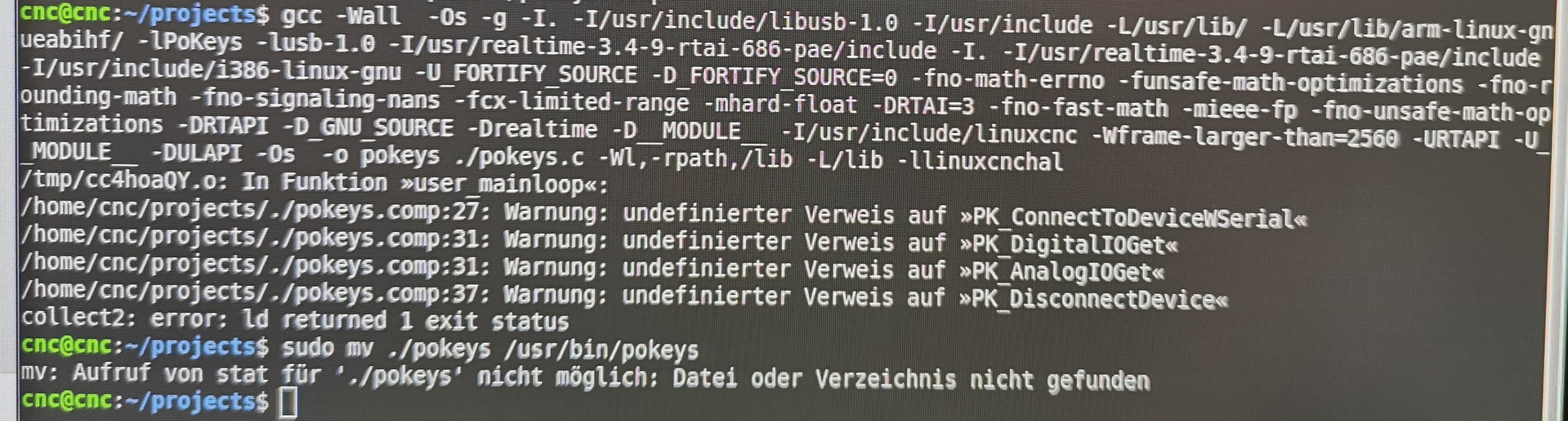

05 Apr 2020 12:12 #162762 by KRAD-AT
Replied by KRAD-AT on topic Problem after compiling pokeys.comp
Hello,
I am trying to get a pokeys 57e to work as my bob.
I have set up a linux mint with a master branch of linuxcnc and i am tryling to make the component for pokeys.
I am following the instructions in the first post of this topic and it works including the halcompile.
But the next step does not work:
gcc -Wall  -Os -g -I. -I/usr/include/libusb-1.0 -I/usr/include -L/usr/lib/ -L/usr/lib/arm-linux-gnueabihf/ -lPoKeys -lusb-1.0 -I/usr/realtime-3.4-9-rtai-686-pae/include -I. -I/usr/realtime-3.4-9-rtai-686-pae/include -I/usr/include/i386-linux-gnu -U_FORTIFY_SOURCE -D_FORTIFY_SOURCE=0 -fno-math-errno -funsafe-math-optimizations -fno-rounding-math -fno-signaling-nans -fcx-limited-range -mhard-float -DRTAI=3 -fno-fast-math -mieee-fp -fno-unsafe-math-optimizations -DRTAPI -D_GNU_SOURCE -Drealtime -D__MODULE__ -I/usr/include/linuxcnc -Wframe-larger-than=2560 -URTAPI -U__MODULE__ -DULAPI -Os  -o pokeys ./pokeys.c -Wl,-rpath,/lib -L/lib -llinuxcnchal
I have no Idea what to do next. Can anyone help me?
Thank you!
