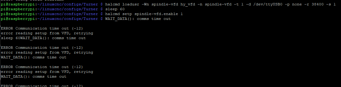

Here is what happens when I unplug the twisted pair cable to the vfd, the usb dongle is connected to the computer. The comm errors come at the enable point. The sleep is there just to show there are no errors from the loadusr line.

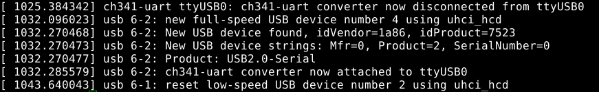

Ok so I unplugged and plugged the USB converter into multiple USB ports and got USB0 everytime. Screen shot below of running the, dmesg | -i usb, command. I am not exactly sure what I am looking for in the dmesg file other then it tells me what that usb device is. I tried a different cable connected to the VFD as well. I have attached the hal files as well.

Put that "-n spindle-vfd" back and see if things don't change.
