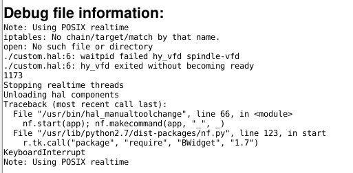

I am setting up another huanyang VFD with a 7i96 and 2.9. I have been following the above and my previous build. So far I can run the "halcmd loadusr" command and the "halcmd spindle enable" and when I use the "halcmd show pin" I can verify that it is true. So I think I am good with the USB to VFD connection. However when I go to open my config I get error on spindle waitpid and then hy_vfd has been exited without becoming ready. Any ideas?

Replied by andypugh on topic usb485 to huanyang vfd
You may need to configure the VFD for ~modbus communications.
Can you paste the exact error messages?

- tjones
- Posts: 69
05 Mar 2020 00:16 #159231
by tjones
Replied by tjones on topic usb485 to huanyang vfd
Attached is a picture of the error messages, as well as my cusom.hal file and custom_postgui.hal
- Thank you received: 4654
05 Mar 2020 20:54 #159279
There should be a button at the bottom of the error dialog that lets you copy all the text to paste into a text editor, or directly in to a message here.
But if I had to guess I would say that the driver is not finding the VFD.
Are you sure you are configuring the serial port correctly?
Last time when I set up the VFD once I has able to run the following (which is just straight copied from the custom.hal file) in the terminal and verify the connection was good, I was able to get axis to load. But this time I can run the following in the terminal just fine. Seems like every other time I plug in my USB it switches between USB0 and USB1, so I have been updating that before I start, just using ls /dev/tty* to verify I am on the correct port. I will post the entire error message next time I try it.
- halcmd loadusr -Wn spindle-vfd hy_vfd -S 24000 -F 400 -n spindle-vfd -t 1 -d /dev/ttyUSB1 -p none -r 19200 -s 1 -g
- halcmd setp spindle-vfd.enable 1
- halcmd show pin
- halcmd show pin
