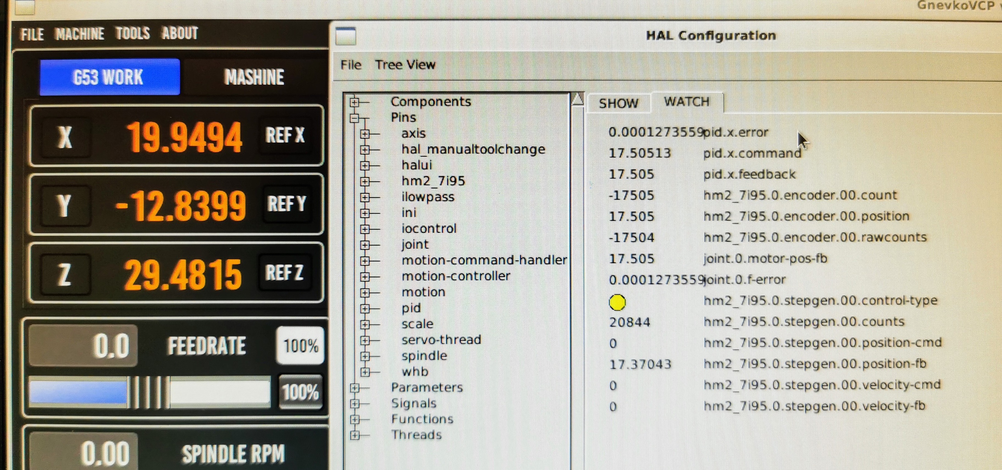

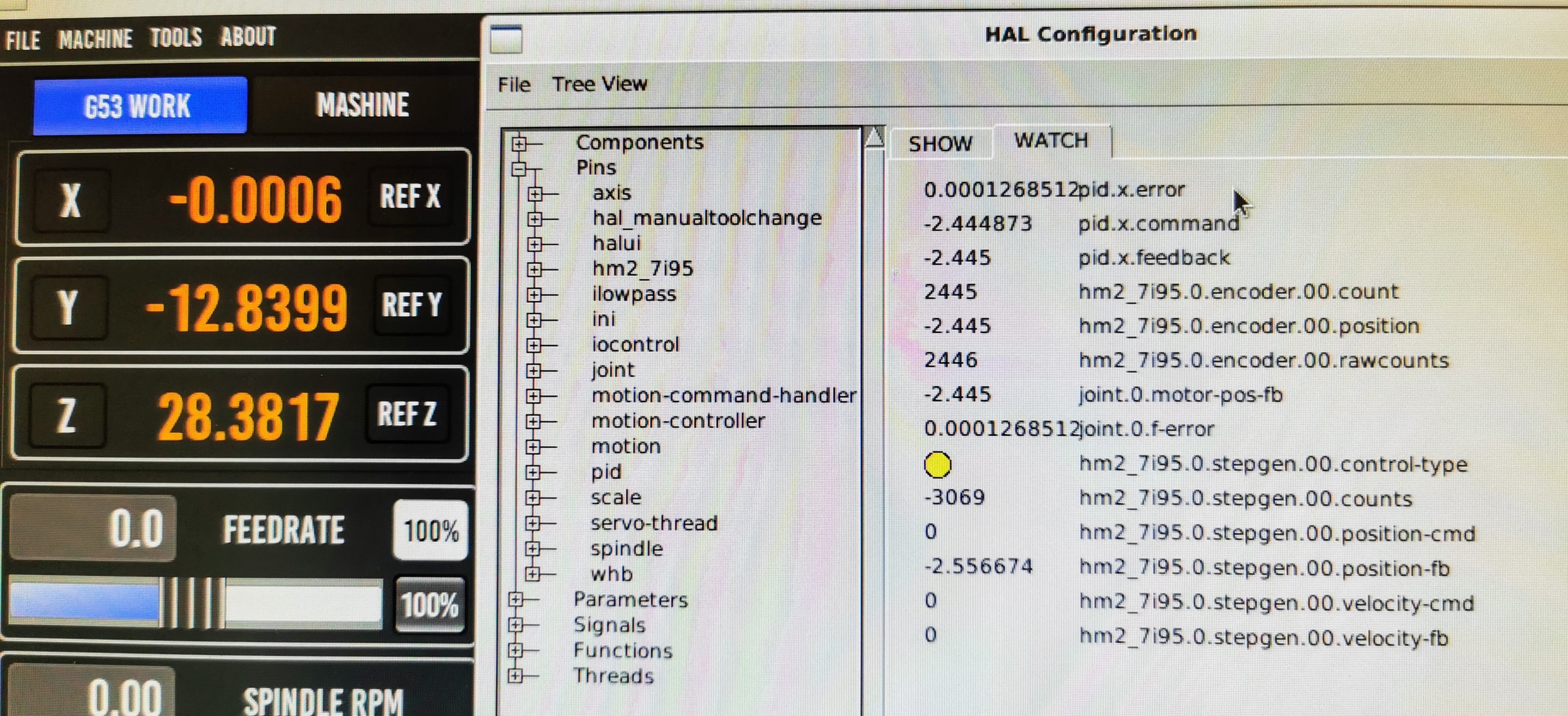

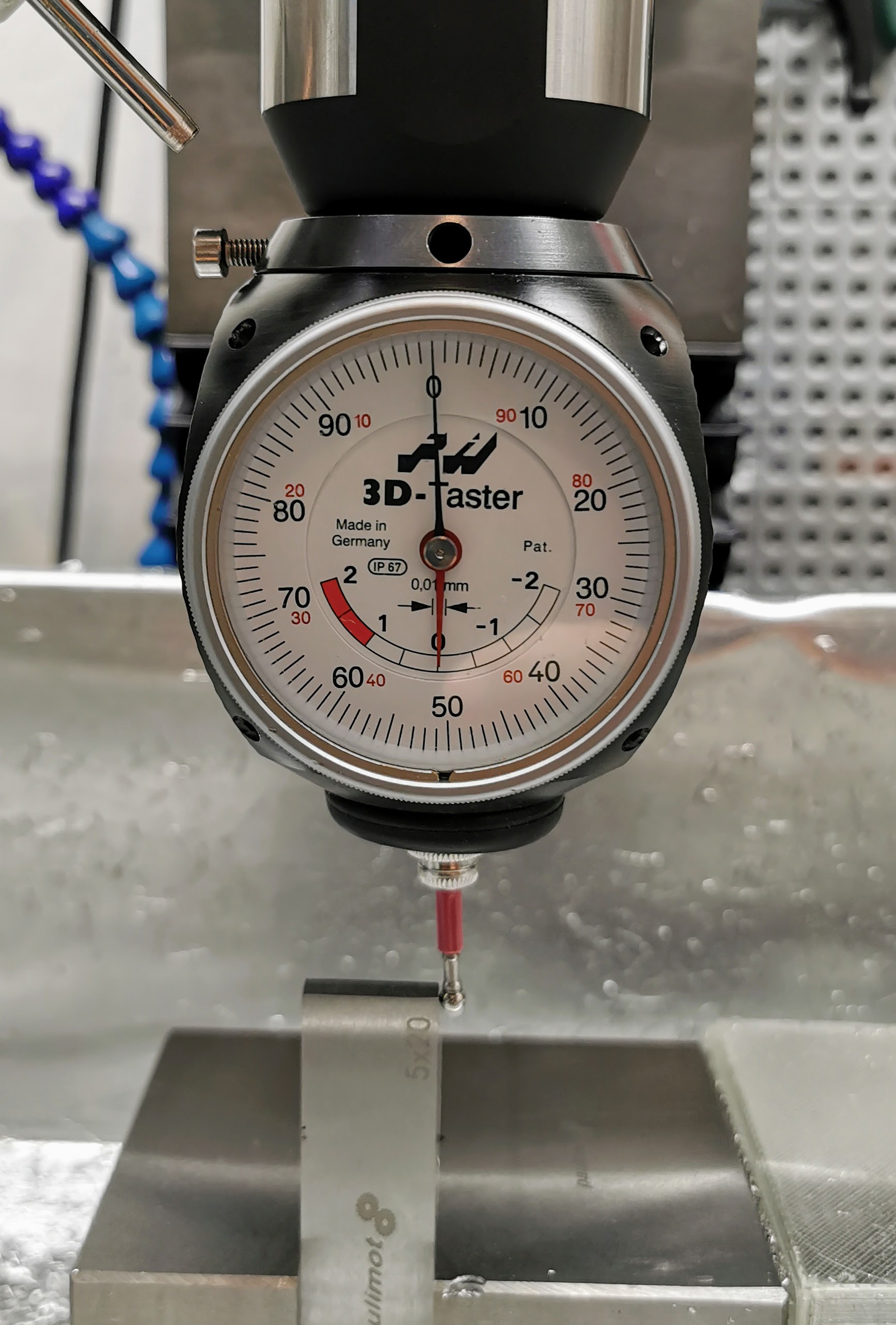

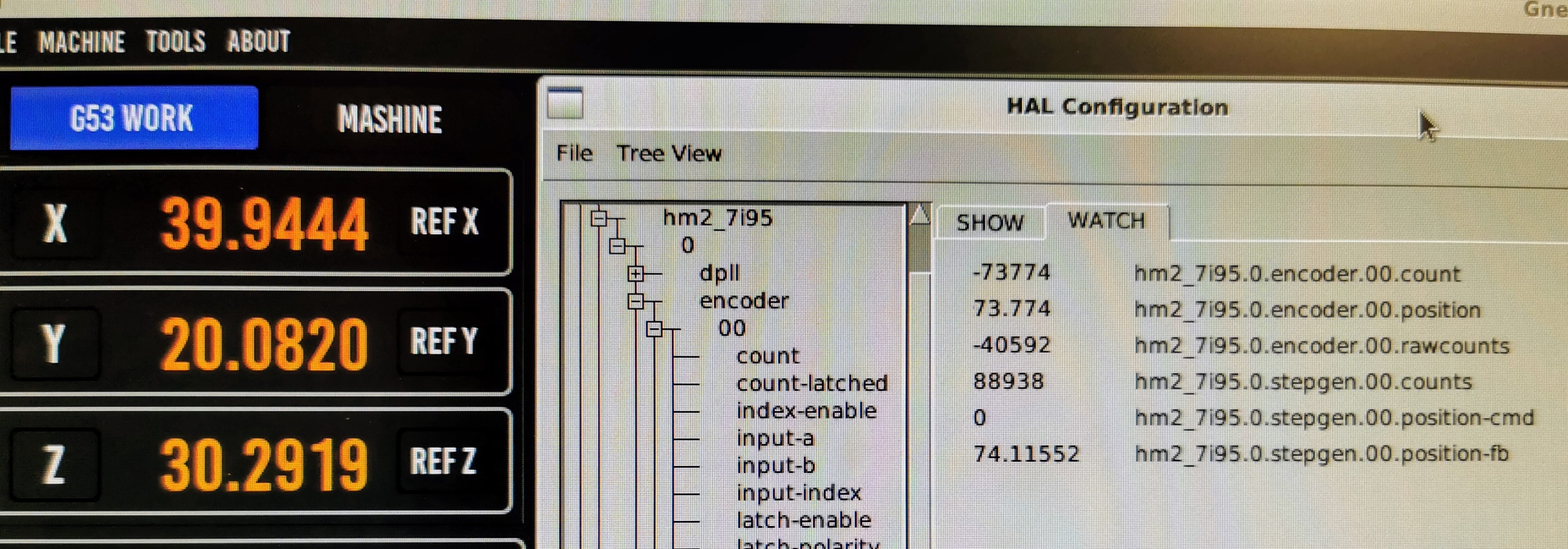

Today I had time to make some more additional tests on my machine. And of course as usual I am a little bit confused. The test is very simple:
1) to take a parallel with exactly 20.00 mm wide and set X axis to zero on the left side:
2) after that navigate to the right side of the parallel and read the value from DRO.
I expected to see something about 20.00mm (+- 0.01) but as you can see it is only 19.945mm
With is also very strange - the encoder position is not the same as stepgen.position-fb.
HAL Configuration for X:
MPG Configuration (because I made the navigation with it):

23 Jan 2020 20:09 #155570
Replied by Todd Zuercher on topic Closed loop with linear encoders but still backlash?
What was your following error on the X axis at both those points? The PID may need more tuning.
2nd how much do you trust your edge finder gauge? It might be informative to find one side of an edge, then turn the spindle 180 degrees and check the gauge again.

23 Jan 2020 20:49 #155572
by Gnevko
Position 1
Position 2
I made this test already more times
Deviation is something under 0.01mm and not only for 180 degrees, but also for 90 and 270 degrees.
Replied by Gnevko on topic Closed loop with linear encoders but still backlash?
Position 1
Position 2

23 Jan 2020 21:28 #155576
Make sure you don't have backlash compensation enabled.
Double check your encoder scale is correct.
It looks like your stepgen position feedback is closer to correct than your linear scale.
Can you measure some other sizes to see if the error is static or linear or something else? (Does the error get twice as large for double the length or is it the same?)

24 Jan 2020 06:34 - 24 Jan 2020 06:37 #155633
by Gnevko
I have BACKLASH = 0 in the config ini file for the X and Y joints.
The encoders have 0.001 resolution, 1000 counts per 1 mm and it seams to be correct.
and as you can see, the error is the same, not double.
Some additional observation: I know that the machine has physically ca 0.06 mm backlash. I move an axis with MPG (0,01 mm steps) in one direction and can see that the value on edge finder gauge also change. Then I reverse the direction of moving and ... encoder.counter value reacts immediately on it but the value on edge finder gauge - not (ca first three steps). But how it could be? If I move the encoder per hand it reacts also linuxcnc really reads the correct value from it.
Of course I checked it too: just added second 20.00mm parallel:Can you measure some other sizes to see if the error is static or linear or something else? (Does the error get twice as large for double the length or is it the same?)

24 Jan 2020 15:14 #155652
Replied by PCW on topic Closed loop with linear encoders but still backlash?
Can you measure the motion near the encoder?
it sounds like lost motion in the linear mechanics
(loose gibs etc)
(loose gibs etc)
The following user(s) said Thank You: Gnevko
- Todd Zuercher
- Posts: 4786
- Thank you received: 1476
24 Jan 2020 15:16 #155653
Well that seems to point at a problem with the ways, like Peter mentioned. Somehow the table is moving (twisting, tilting) in such a way that your movement at the piece is not the same as the movement at your linear scale.

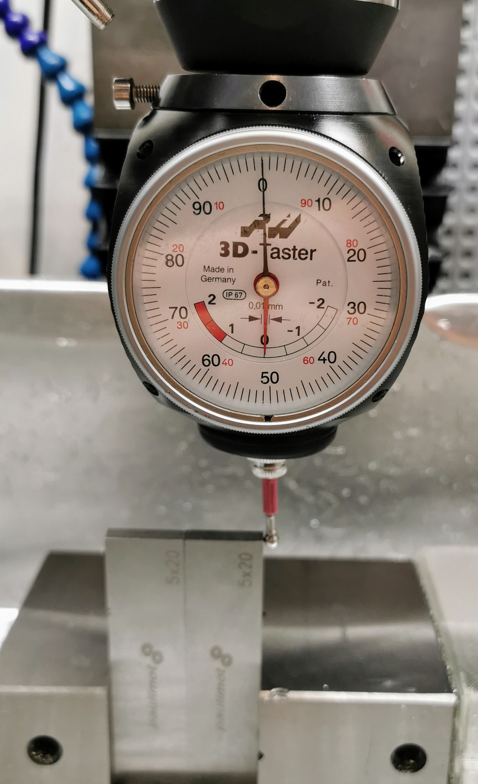

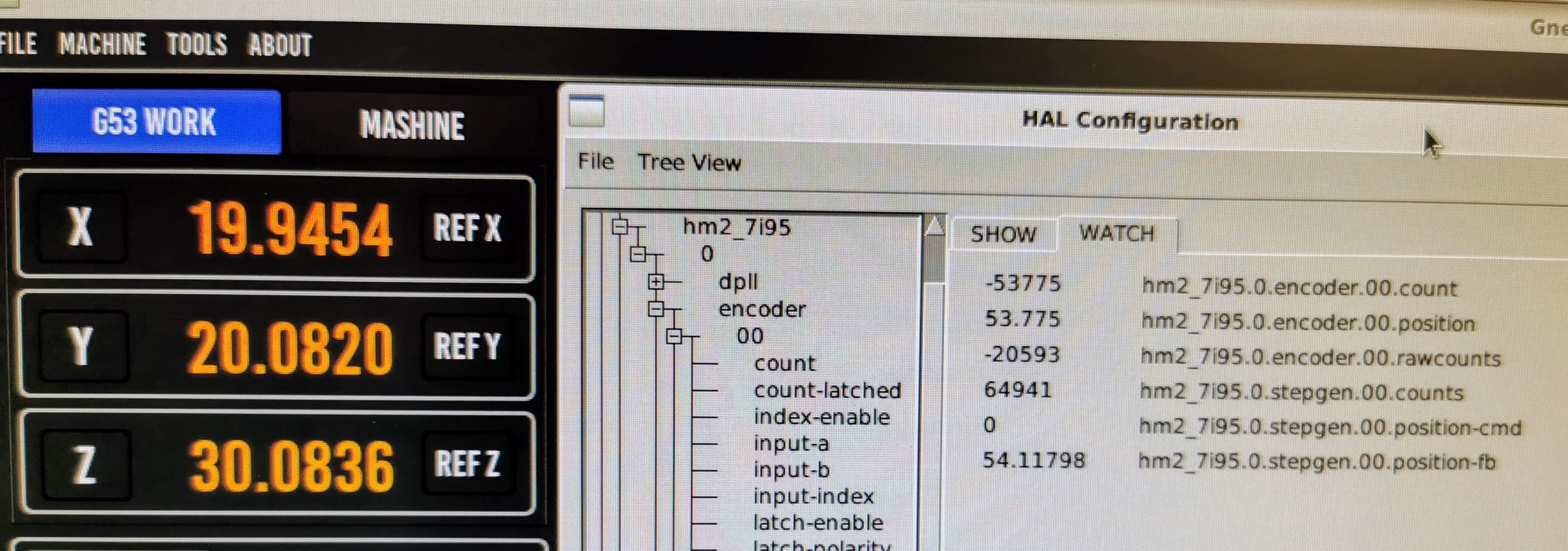

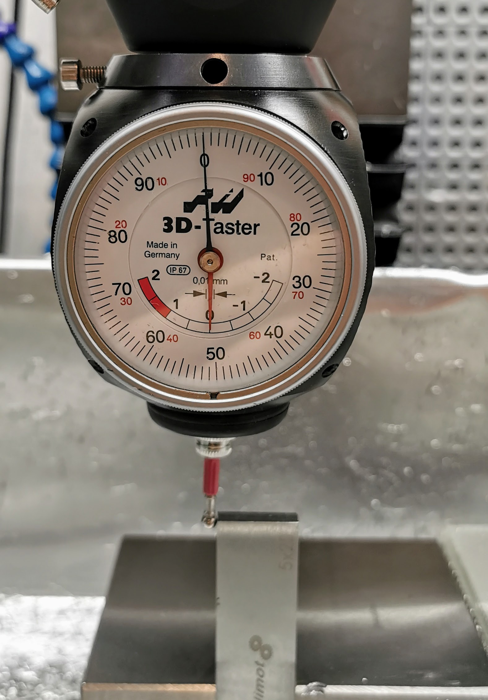

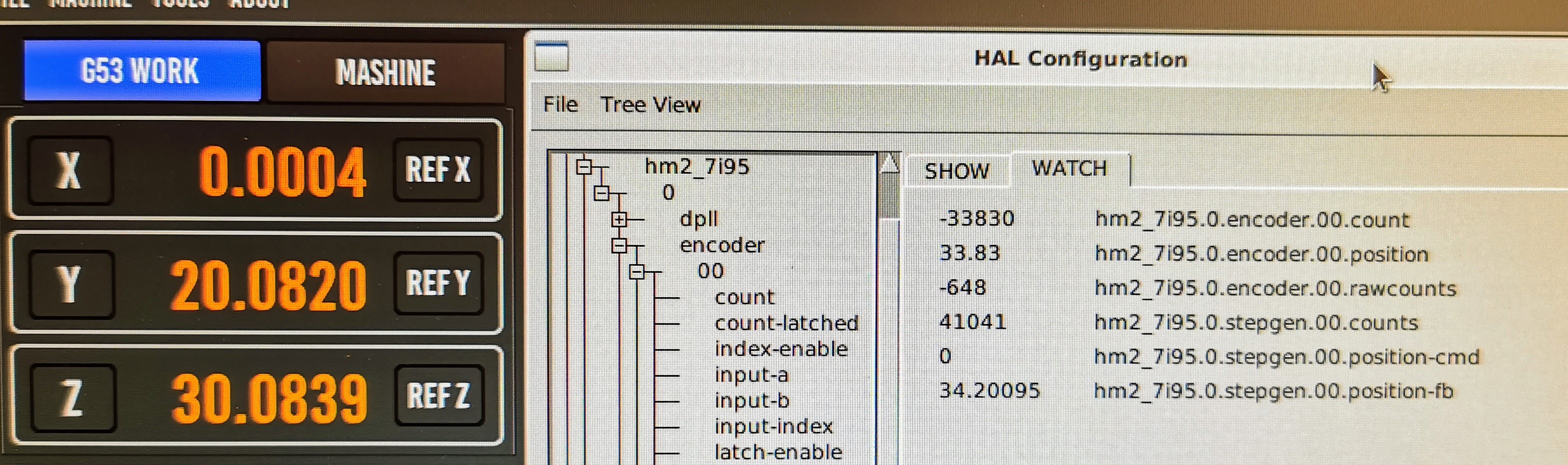

- Gnevko
- Posts: 59
- Thank you received: 10
26 Jan 2020 11:08 #155785
by Gnevko
At first - thank you, guys, for the trying to help! Yesterday I spend a lot of time and check all possible mechanical parts, but without susses, It seams that mechanics work correctly. But ok, if mechanics are ok, than I need to search the problem by the edge finder gauge. One more tests with the following results:
As you can see I used 10.01mm parallel, because my digital gauge can only 12,5 mm. At first I found Zero Point on the left side, set the machine and digital gauge also to Zero, and as usual tried to measure the parallel from right side. And ... the result on the digital gauge is the same (deviation is only 0.003 what it pretty cool) as the linuxcnc displays and it has the same error as by other tests with 20mm parallels.
