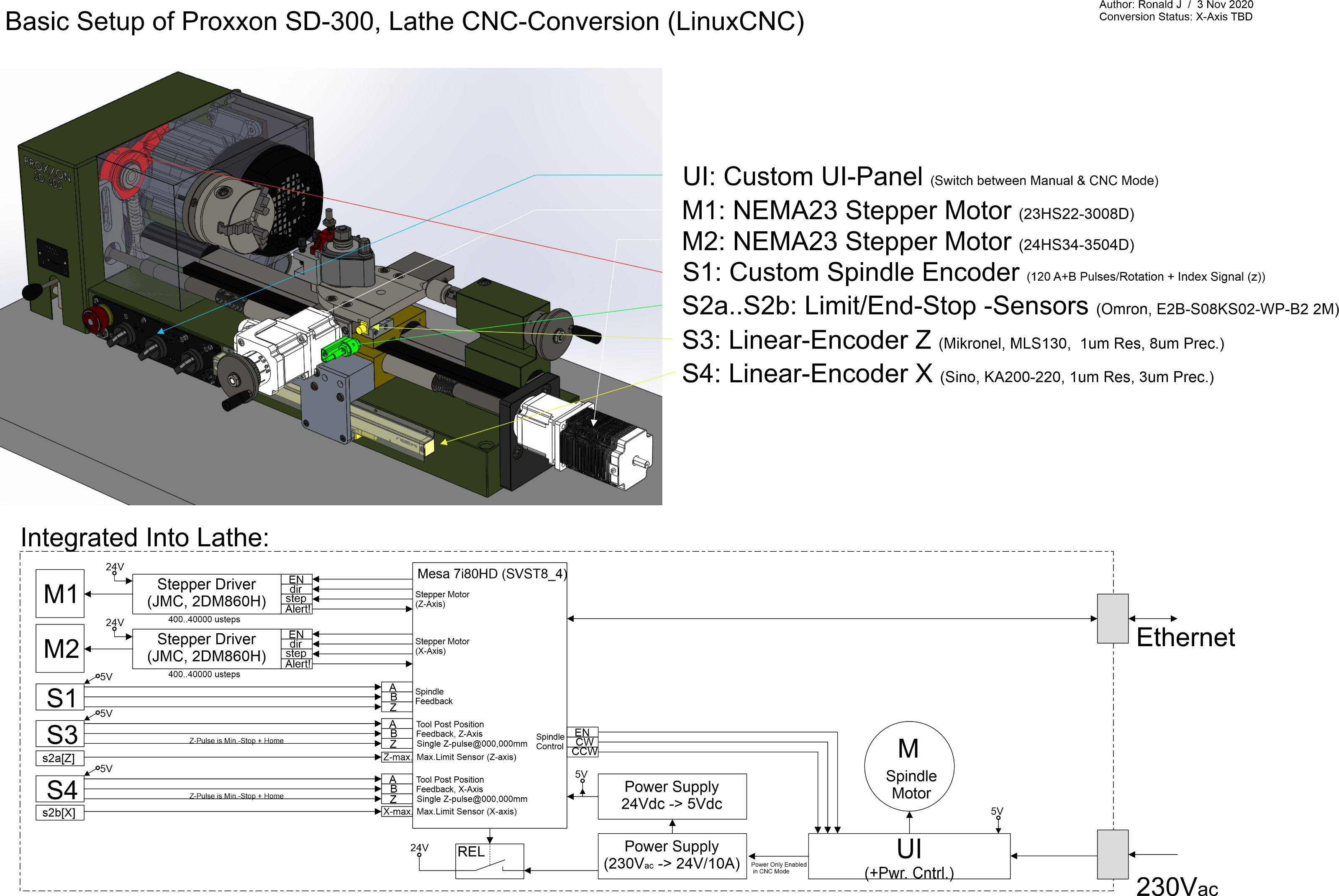

Dear Gnevko,
I reach out to you, as you are one of the few users who have found a way to make LinuxCNC work using Linear-Encoders as part of the feedback loop.
I am in the beginning of converting my Lathe, but simply can not find any guidance in what steps/sequence one should start configuring LinuxCNC when adding Linear-Scales to your CNC-Setup.
If you had to do it all over, in what steps would you recommend, editing/changing/adding what to the LinuxCNC configuration, to get the feedback-loop working & Tuning of that loop ?
I would love to find a basic manual on how this process looks like (for dummies & beginners), or even create one for this forum, once I can gather all the feedback from the best experts in these rounds, and then tried it out for myself.

Thank you AndyPugh for your reply.
I added a functional Diagram to my initial post, so the basic info is there.
If any other questions pop-up, please let me know.

Adding the scales to the system might be very easy in this case.
PNCConf will probably add a PID component to the system (because that helps absorb the effects of jitter on an open-loop stepper system.
All you need to do is change the HAL to disconnect the PID feedback from the stepgen position feedback pin to the scale position pin.
And then add a small amount of P and I to the PID until the following error disappears.
The axis.L.motor-pos-fb and joint.N.motor-pos-fb pins also want to become connected to the scale output rather than the stepgen internal feedback too.

I see that you are using velocity-mode stepgens. Have you tried position-mode with added PID for corrections only? A tight position loop in the drive might be better than the velocity loop in the drive (or, quite possibly,not)
I have forgotten what the PNCConf setup for Mesa stepgens uses.
I imagine that both will work well, but one or the other might be subtly better on some machines.
Replied by andypugh on topic Closed loop with linear encoders but still backlash?
I use a closed loop stepper with glassscales on my mill.
