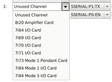

Thanks again Andy, great to hear that the 7i96 + 7i85 seems to be a good fit for a Full Feedback (or Closed-Loop) CNC-Retrofit for a Lathe.
I see the SW-package for the 7i96 supplies a BIT-File for the 7i96 + 7i85 Combination (7i96_7i85d.bit), which is great. However, if you try to do the configuration using Pncconf, you find that you cannot select the 7i85 from the drop-down list (Picture from Message #188431)... so how can one now assign the needed LinuxCNC-Signals to the 7i85 Card ?
06 Nov 2020 13:09 #188499
Replied by andypugh on topic Closed loop with linear encoders but still backlash?
You need to look at the 7i85 manual (google for 7i85man) and then allocate the 7i96 pins to match the 7i85's expectations.
(Probably)
The 7i85 is just a passive break-out board really.
(Probably)
