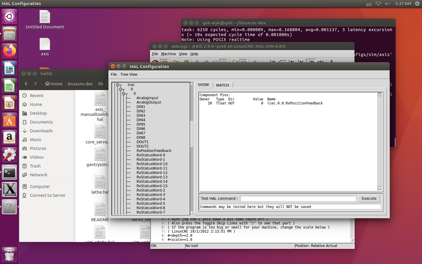

first check the feedback...
open hal show (Menu -> Show hal configuration) navigate to pins -> lcec > 0 > 0 > your feedback pin and check if the value changes, while turning the motor shaft.

30 Jun 2021 21:41 #213381
by wang
Replied by wang on topic linuxcnc+ethercat drives the AKD servo motor it cannot be moved
- wang
- Posts: 85
30 Jun 2021 21:50 #213385
by wang
Thank you...
I modified the hal file, and now there is feedback, but the parameter is too large to exceed the stroke
