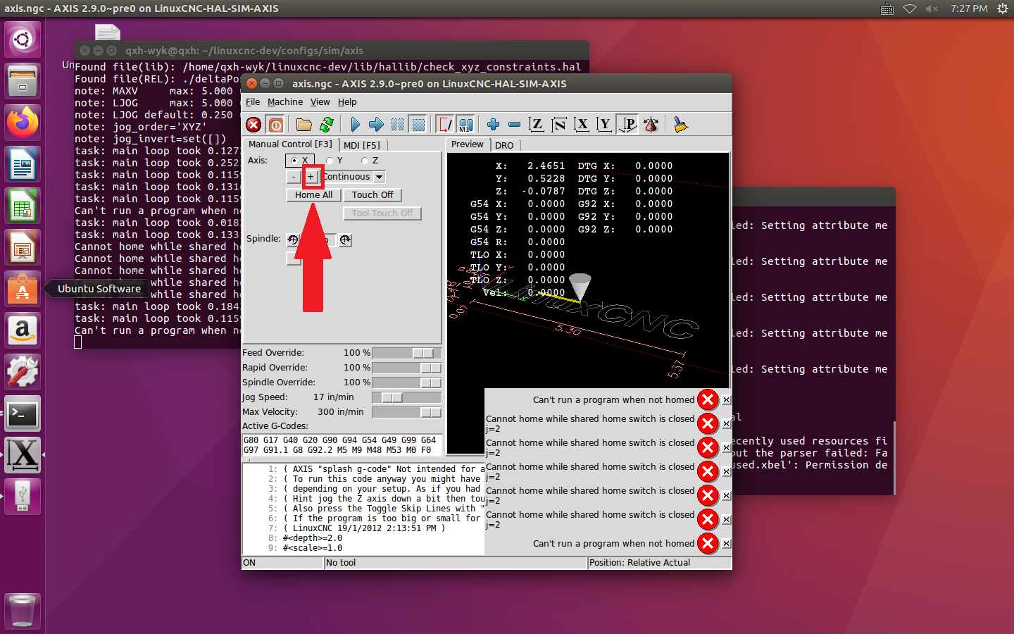

linuxcnc+ethercat drives the AKD servo motor it cannot be moved was created by wang
hi everyone
linuxcnc+ethercat drives the AKD servo motor. After configuring ini, xml, hal files, it cannot be moved and the following deviation level fault occurs.
I think that because the motor cannot be rotated, but the position command can be executed, there is a deviation between the two (F439 follow-up deviation level fault)
Below is my configuration file

I know my configuration is a bit simple, because I am a novice and need some help
At present, I can use the axis interface of linuxcnc to control the switch of AKD through ethercat, but I cannot control the motor rotation freely.

Although the rotation is not controlled, it is obvious that the shaft is braked. This is different from the previous feeling. Thank you for your guidance.
For single-axis testing, should I click this plus sign to see if the motor turns
According to your guidance I will
