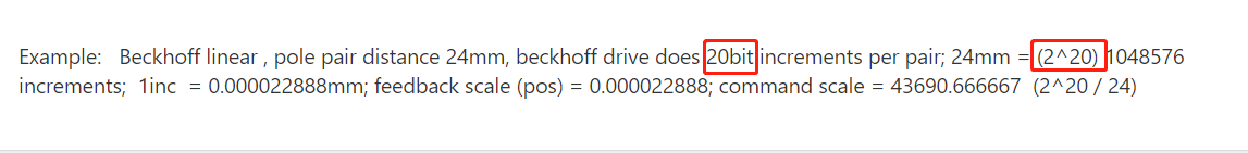

Example: Beckhoff linear , pole pair distance 24mm, beckhoff drive does 20bit increments per pair; 24mm = (2^20) 1048576 increments; 1inc = 0.000022888mm; feedback scale (pos) = 0.000022888; command scale = 43690.666667 (2^20 / 24)

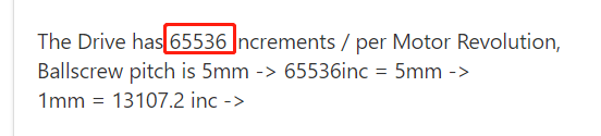

For this you also need to know resolution of the Drive/motor...
example:
The Drive has 65536 increments / per Motor Revolution,
Ballscrew pitch is 5mm -> 65536inc = 5mm ->
1mm = 13107.2 inc ->
feedback scale (pos) = 1 Machine Unit / 13107.2 inc = 0.000076229 mm/inc
command scale = 1 Machine Unit = 13107.2 increments

- wang

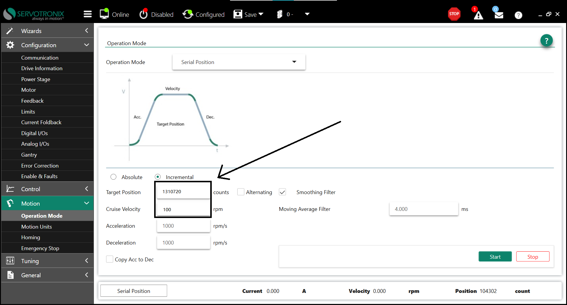

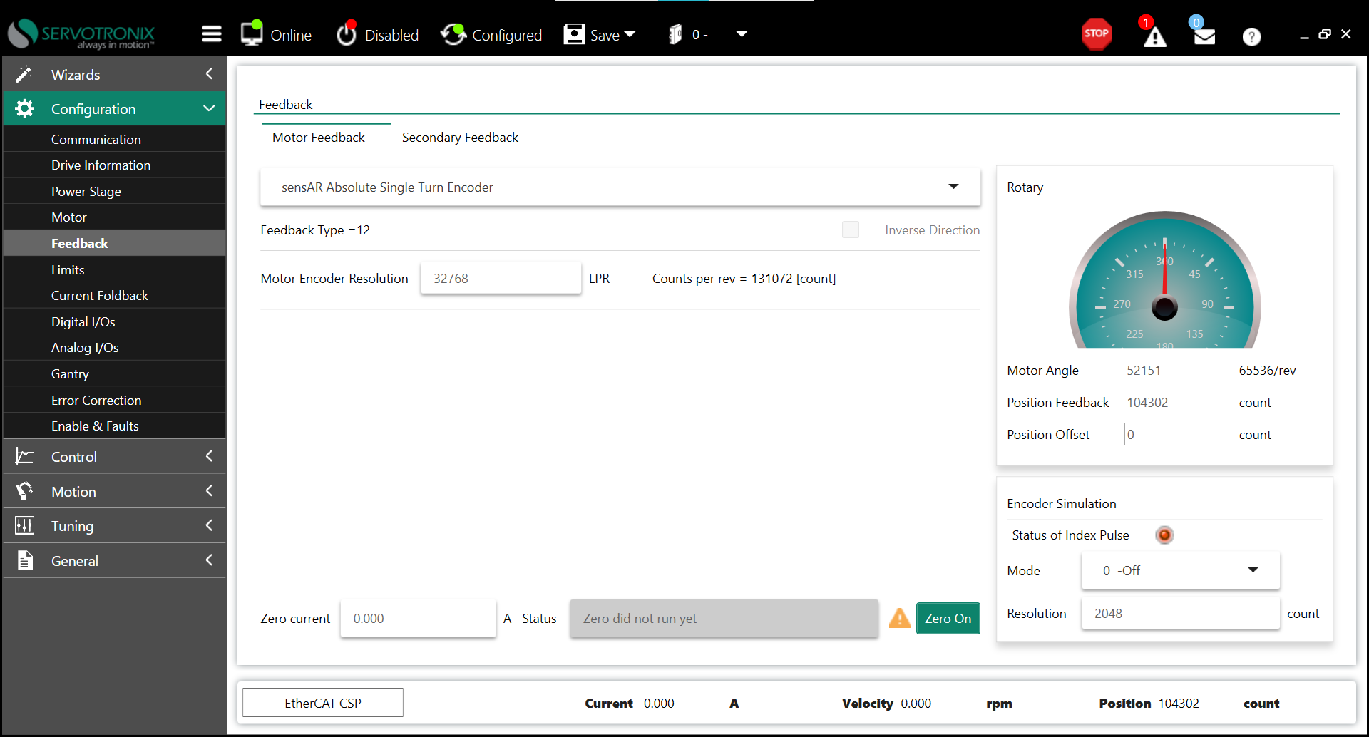

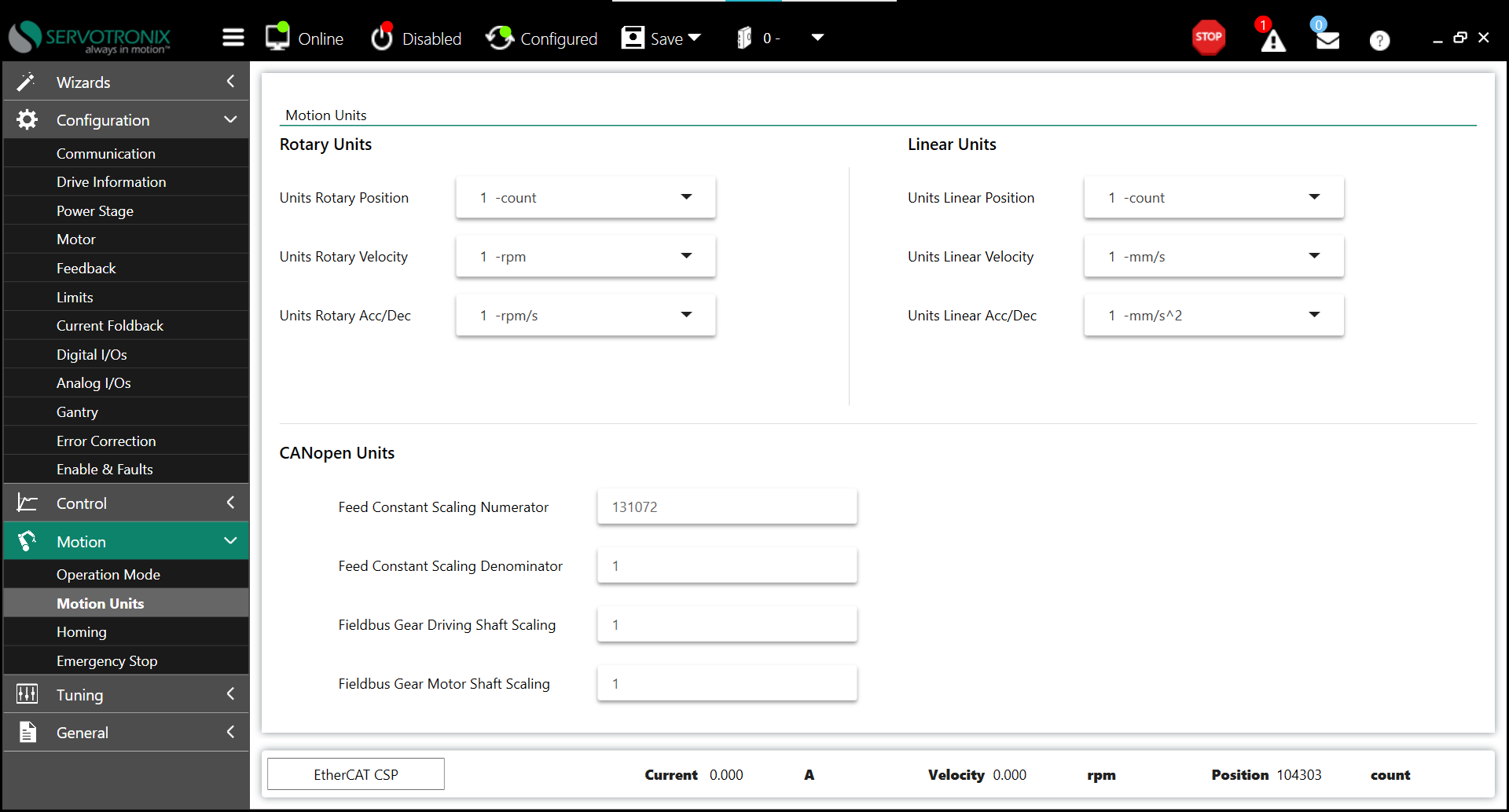

01 Dec 2021 08:50 #228099
by wang
I am currently controlling a five-axis machine tool and ran into this problem again. I found that I still have a lot of questions. My AC-axis drive is a BDHB servo drive from SERVOTRONLX.
This is my drive configuration interface
And motor units
I tried to input 131072 in the control interface (because I thought it should make it make a full circle), but then I tried to make the C axis make a full circle when the number 1310720 was reached.I don't understand why there is a 10 times difference?
Because the units of AC axis are all degrees when we write G code for processing, so I hope that the 1 that I send through PosCommd is 1 degree. You can control the A or C axis to rotate one degree.
Can you tell me how I should set this scale now? thanks
