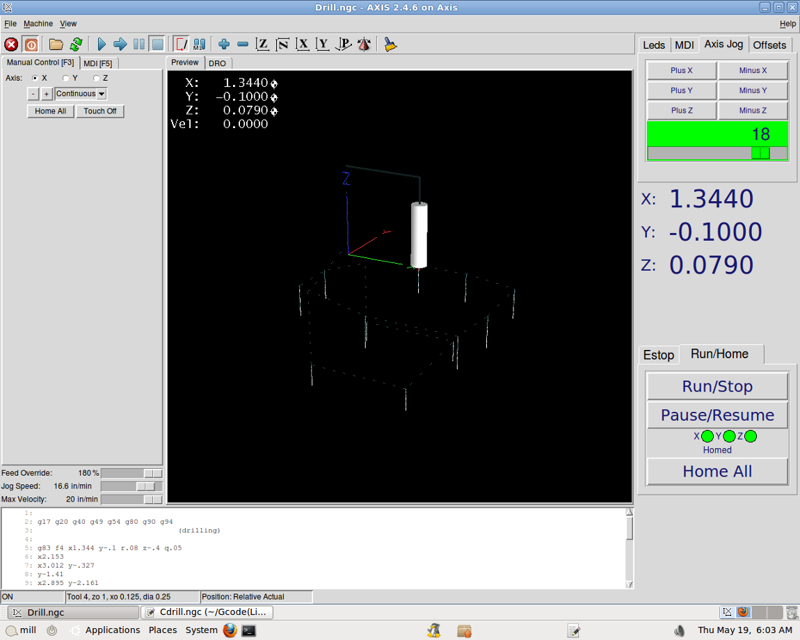

found below online (www.anderswallin.net/tag/halui/) and works.
it doesn't get emc out of sync. it doesn't work on run/stop

However it will get out of sync if you press the button when a program is not running. What I came up with prevents the button press from getting to the toggle if the program is not running or paused by adding a couple of and2's and an or2.
John

Thanks. been playing with it but never tried pausing when no program running.
it makes me hit stop to get back in sync.
