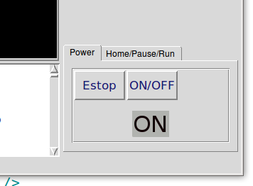

28 Apr 2011 10:10 - 28 Apr 2011 11:27 #9445 by piasdom
Replied by piasdom on topic Re:How to right sequence run - pause -stop
Thanks, didn't know about the pyvcp section.
got this to work, but it bypasses the estop. when starting emc i could
just use the on/off button. when emc starts on is displayed. i clock on/off and it
turns to off. click on/off again and on is displayed. and machine is on.
net off-btn toggle.1.in == pyvcp.mach-on halui.machine.on
net on-off toggle.1.out halui.machine.off pyvcp.selectimage
Last edit: 28 Apr 2011 11:27 by piasdom.

28 Apr 2011 11:56 - 28 Apr 2011 12:19 #9456 by piasdom
i've got the below to change the image from on to off(two images)
but the first click turns the machine on and if i don't click and wait
a second or two, it turns off by itself. but after that, it works like it should.
click = on(image "on") click again = off(image "off") it's just that first click.
and i had used not.n for estop, but it made emc start slower. changed
it back to toggle.n and it start as usual. wouldn't know why :)
net off-btn toggle.1.in == halui.machine.on
net on-off toggle.1.out pyvcp.selectimage halui.machine.off
and from what i understand, the below is the same as the above ? :)
Last edit: 28 Apr 2011 12:19 by piasdom.
28 Apr 2011 13:09 #9459 by piasdom
i thought i would be able to click on the image to change the on-off position,
right now i have tow click on the on-off pyvcp.button to do that. the image
changes(after the first click and wait) to on and off as it should. but i was looking to
get rid of the button. Thanks, this is fun :)
