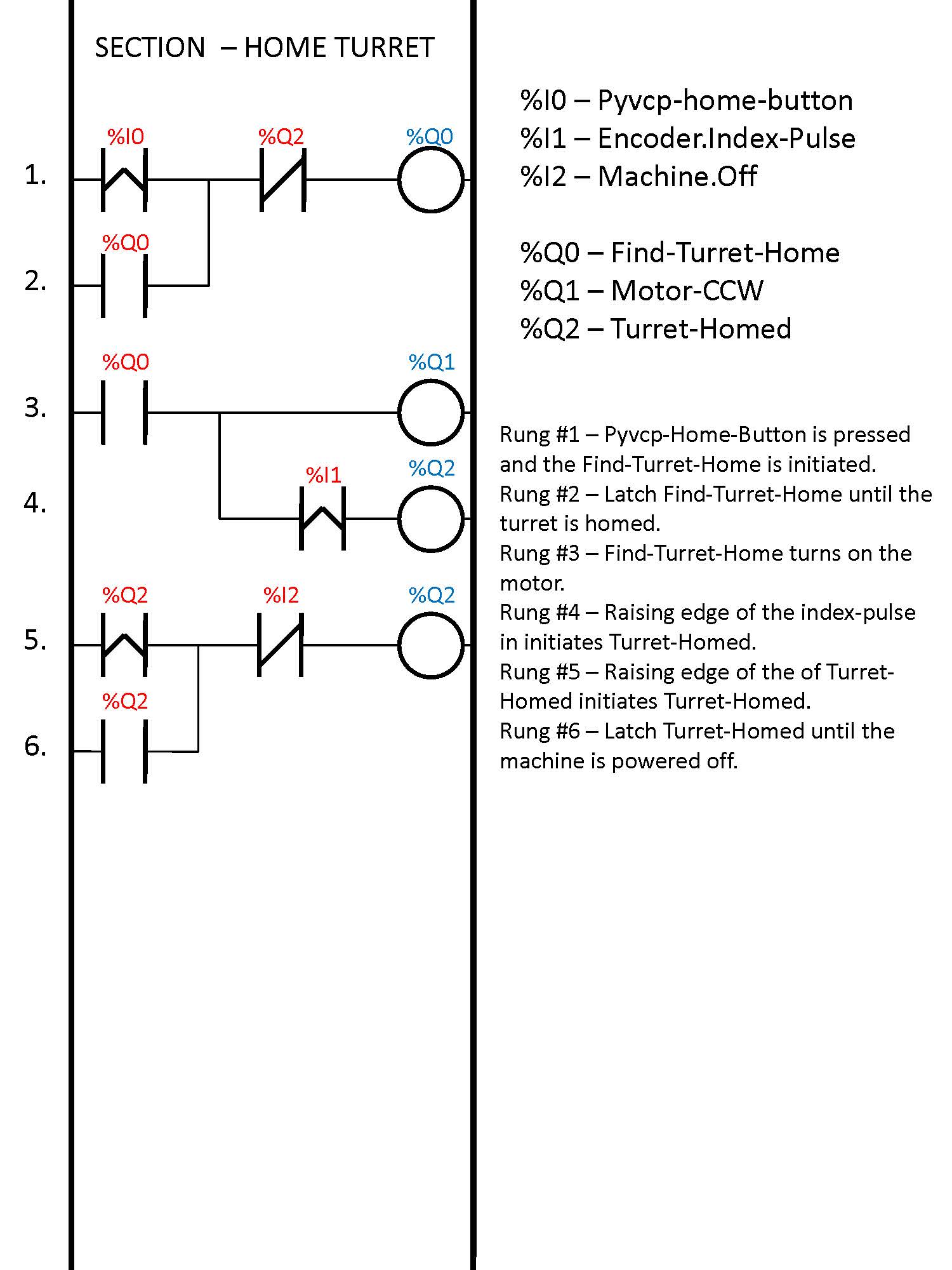

Hey Mac,
Here is an example of sequencing in ladder that is pretty bullet proof.
Step 1 starts and stays in step 1 until step 2 trigger comes on for one scan
Step 2 trigger starts step 2 and until some condition is met then step 3 trigger is on for one scan
JT
ok to start sequence --- not step 2 trigger ---- step1()
step1 ----------------|
step1 ---- do stuff()
|---- stuff done ---- step 2 trigger()
step2 ---- not step 2 trigger ----- step2()
step2--|
step2 ---- do more stuff()
|---differnet stuff done ---- step 3 trigger()Step 1 starts and stays in step 1 until step 2 trigger comes on for one scan
JT

by MacGalempsy
Replied by MacGalempsy on topic Benchman XT 20 tool ATC
these attachments are obsolete. please check the next post down.
Last edit: 29 Jan 2017 01:37 by MacGalempsy. Reason: updated with a full program attempt

by BigJohnT
Replied by BigJohnT on topic Benchman XT 20 tool ATC
You can only have an output one time, you have Q2 twice. What will happen is only the logic in line 5 will set the state of Q2.
JT
JT
The following user(s) said Thank You: MacGalempsy
- bevins
- Posts: 1947
- Thank you received: 338
28 Jan 2017 18:37 #86846
by bevins
Does this work?
Remove rung 6, change %Q2 rising edge to %Q2, remove %Q2 output on rung 5 and finish that rung up one rung in between %I1 and %Q2 output.
So when you press Pyvcp-home-button, you start-find-turret, motor turns until you get your index, then turret is homed, and gets latched by rung 5. Once you get %Q2 that drops out %Q0 which stops the motor turning %Q1. And your homed.
Replied by bevins on topic Benchman XT 20 tool ATC
JT
Does this work?

by MacGalempsy
Here is the first full-go attempt at the entire ladder program. It may not be fully optimized, but it is my best shot. Please feel free to let me know what needs to be changed.
Thanks!
Thanks!

by bevins
WOW, nice job.
Still trying to figure out the logic...... lol

by MacGalempsy
The only way I was able to go thru it was buy printing it out, then manually coloring the contacts and outputs. There are a few errors in that revision, which were figured out after the coloring episode. Once I get the chance to test the programming, the pdf will be updated. Thanks for taking the time to check it out.
