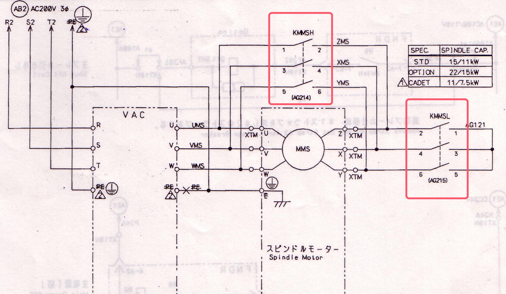

The motor is also responsible for moving the C axis, so maybe AC servo. I think that it must have a lot of torque at very low speeds. I must say that I never saw the machine working.
I have no idea and I also do not know how can I figure it out. Never less I think I cannot buy such a servo drive (almost 100A) to test it. I simply have no means to do such an insane thing (€ $)
My simple approach was to take out the motor and do not use the C axis. But of course using the main already mounted motor would make the machine much better.
From the electrical schematic there are 6 wires that are leaving the motor. The wires are for connecting the Y or delta, to achieve two range speeds (commuted by either KMMSH and KMMSL (high and low)), for this reason I think it is a "standard induction motor", as those 6 wires can be compared as the connection box of a standard induction motor but my knowledge on this matter is low. I have attached a picture from the schematic. Previous, when I was trying to use all the hardware I posted in CNCzone, but I had no clear reply about what motor is it or if I could control it. Most reply's were negative.

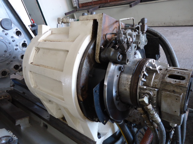

31 Jan 2013 19:34 #29361 by emcPT
Replied by emcPT on topic Current turning capabilities status
And here it is the built in splindle. Not showing the actual machine but it is from another sister machine (a bit more modern) that we are cleaning.
At 5000rpm almost no vibration, it is quite amazing. It is also oil cooled for tight dimension work.
31 Jan 2013 22:57 #29378 by andypugh
Replied by andypugh on topic Current turning capabilities status
That does seem likely, looking at the diagram.
One way to tell might be to connect a low current supply to two of the wires (say 1A between U and V) and see if you can feel any "notches" as you rotate the motor.
I don't think you will feel any with an induction motor, whereas you will with a permanent magnet motor.
Does the rest of the wiring diagram show any more wires from the motor/spindle to the drive? If the only other wires from the spindle are an incremental encoder then I think it probably is just an induction motor.
This does mean that just about any VFD will work.

01 Feb 2013 01:37 #29395 by Kirk_Wallace
Replied by Kirk_Wallace on topic Current turning capabilities status
Looking at the schematic, AG215 looks like it shorts X, Y, Z. This would brake? AG214 parallels U, V, W to X, Y, Z, and as mentioned, changes speed? I wonder what XTM means?
I'd sure like to see the rest of the dashed (actually ghost lined) box labeled spindle motor to see what else is considered part of the motor.
There are not that many ways to tell a VFD what you want, +/- 5 or 10 Volts, PWM/Direction, Modbus, maybe one or two more, but LinuxCNC covers them all so far. Finding the rest of the VAC box in the schematic might help. Also, looking at all of the connectors going to the VFD -- the number and size of the pins on a connector can indicate its function. Getting the make and model number on the VFD can lead to a manual down load from the manufacturer's website. One just needs to be in Sherlock mode.

01 Feb 2013 03:13 - 01 Feb 2013 03:18 #29400 by PCW
Replied by PCW on topic Current turning capabilities status
I think emcPT is correct, the relays select delta or wye connections for different speed ranges.
To determine whether it is a PMSM servo motor or induction motor, you can also short out one winding (probably you would have to short U to X? if the relays are disconnected, in any case use an ohmmeter to find a winding to short) and turn the spindle. It will have a lot of resistance to turning if a winding is shorted and its a servo motor, but shorting will not make any difference if its an induction motor.
