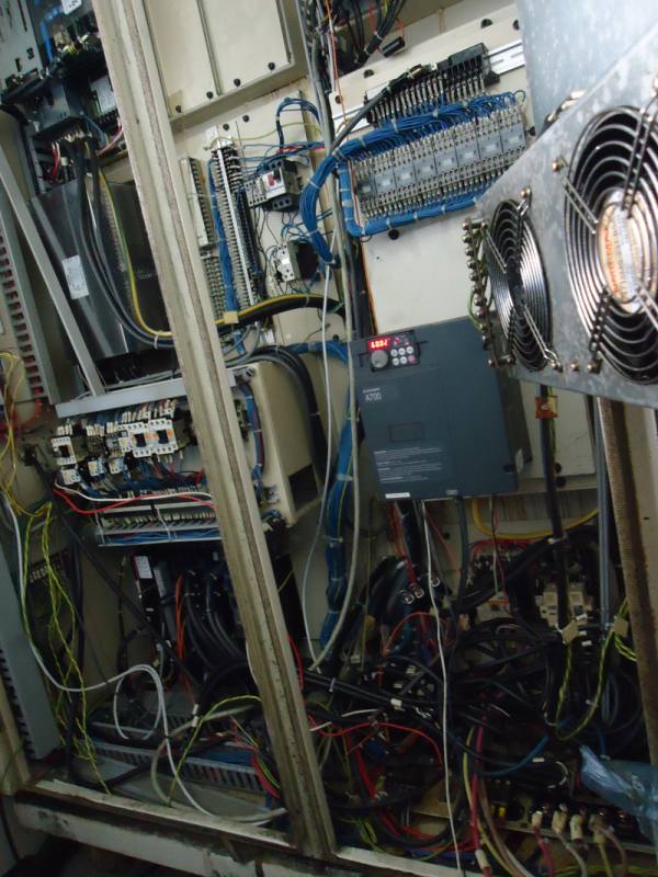

My hardware is arriving. I got the VFD today and I installed it.
The motor runs only for a brief period (also with noise) of time and the inverter gets in error mode. For sure a tuning issue that I will try to work out. All this controlled manually = no linuxcnc yet.
I also got a touchscreen that in Windows works great, lets see if I can use it in Linux.
I will keep updating my progress.

I have tuned the motor as best I could. I can run it from 1Hz up to 100Hz (maybe more but I did not tested).
Now comes the hard part for me as all linuxcnc is new to me. I don't want to damage the mesa hardware so it is better for me to test.
I want to control the spindle using the 7i33 and 7i37 that I have. I read a lot, but I am afraid of doing some mess here, so I need to confirm a few things.
The part in the hal file that have the spindle connected:
# SPINDLE S
# ---PWM Generator signals/setup---
setp hm2_5i20.0.pwmgen.02.output-type 1
setp hm2_5i20.0.pwmgen.02.scale [SPINDLE_9]OUTPUT_SCALE
net spindle-vel-cmd => hm2_5i20.0.pwmgen.02.value
net machine-is-enabled => hm2_5i20.0.pwmgen.02.enable
# ---Encoder feedback signals/setup---
setp hm2_5i20.0.encoder.02.counter-mode 0
setp hm2_5i20.0.encoder.02.filter 1
setp hm2_5i20.0.encoder.02.index-invert 0
setp hm2_5i20.0.encoder.02.index-mask 0
setp hm2_5i20.0.encoder.02.index-mask-invert 0
setp hm2_5i20.0.encoder.02.scale [SPINDLE_9]ENCODER_SCALE
net spindle-revs <= hm2_5i20.0.encoder.02.position
net spindle-vel-fb <= hm2_5i20.0.encoder.02.velocity
net spindle-index-enable <=> hm2_5i20.0.encoder.02.index-enable
net spindle-vel-cmd-rps <= motion.spindle-speed-out-rps
net spindle-vel-cmd <= motion.spindle-speed-out
net spindle-on <= motion.spindle-on
net spindle-cw <= motion.spindle-forward
net spindle-ccw <= motion.spindle-reverse
net spindle-brake <= motion.spindle-brake
net spindle-revs => motion.spindle-revs
net spindle-at-speed => motion.spindle-at-speed
net spindle-vel-fb => motion.spindle-speed-in
net spindle-index-enable <=> motion.spindle-index-enable
sets spindle-at-speed true
So the spindle generator is located in 2 and the spindle encoder should also be connected to nº2 of the 7i33. I think I got this right.
Now the output signals to start the spindle. From the file it seams that motion.spindle-on will start net spindle-on (or the reverse?!), so were this is related with the hardware part? In my case I need that spindle on is ON when spindle reverse or spindle forward gets on. Lets say that I want to the forward signal be the output nº1 in my 7i37 and spindle reverse output nº2.
I am very sorry if this was asked or covered before.

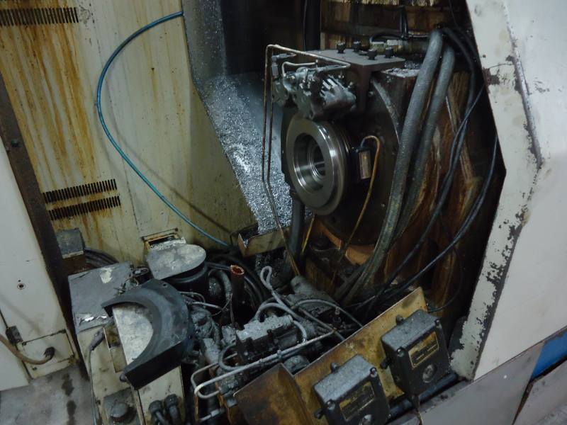

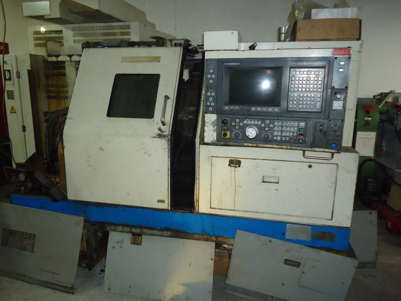

I also added images from the machine, with the inverter installed and also the full hal file.
Thank you
