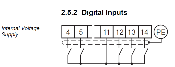

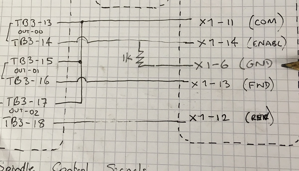

Do I need to add pull down resisters? There is no information in the VFD manual on the max Voltage threshold before it triggers, so I don't know what to plug into the formula provided here
I have a large selection of 1/4W resisters. I tried adding a 1kOhm resister between VFD X1-14 and GND, but it didn't change the state of the VFD Enable. It stays on.
</faking knowledge>
... or do I have a completely different problem?

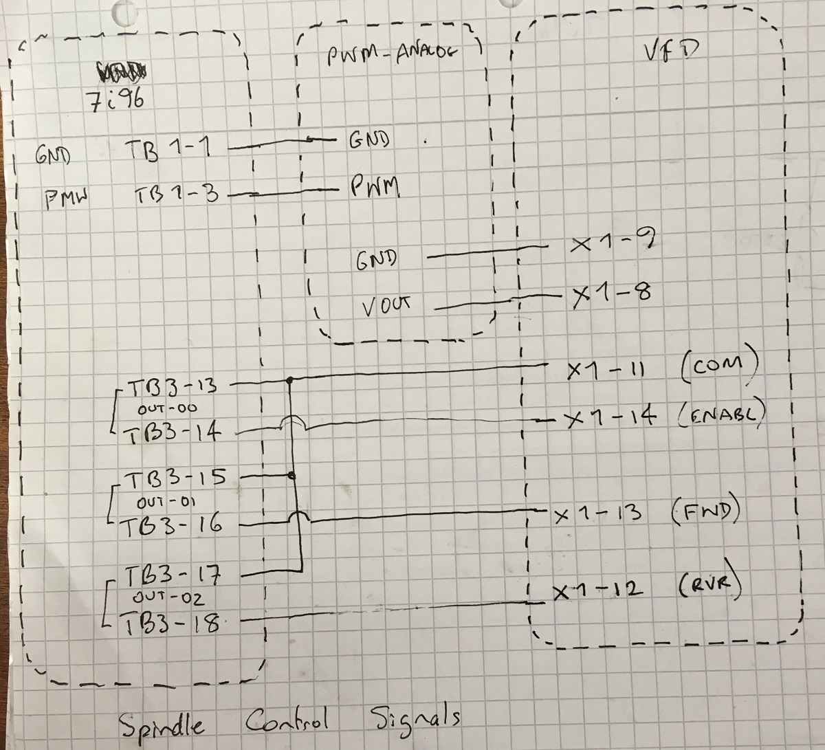

The next issue is the VFD FWD/REV and Enable signal wiring. Three of the 7i96 outputs are hooked up to the VFD .
I can control the 7i96 switches on and off through the HALshow. However, I can't control the VFD, as there is enough leakage current for the VFD to detect them as always on, as the 7i96 output relays are only 15MOhm when off.
<fake know stuff about electronics>
</faking knowledge>

If the 7I96 outputs seem to be always on, its likely you have the polarity backwards
- RotarySMP

Thank PCW. The polarity of the 7i96 switches? I thought these didn't matter. Would you mind taking a quick look at this latest video, at around minute 13:00 I show the behaviour.
Edit.
The 7i96 seems to switch properly, but "off" is a 2MOhm resistance, not an open circuit.
Mark

I can actually see from your wiring that its backwards
( +15 from VFD pin 11 goes to output- pins but should go to output+ pins )
