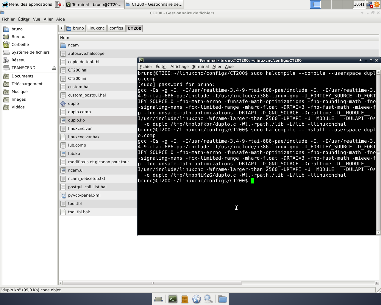

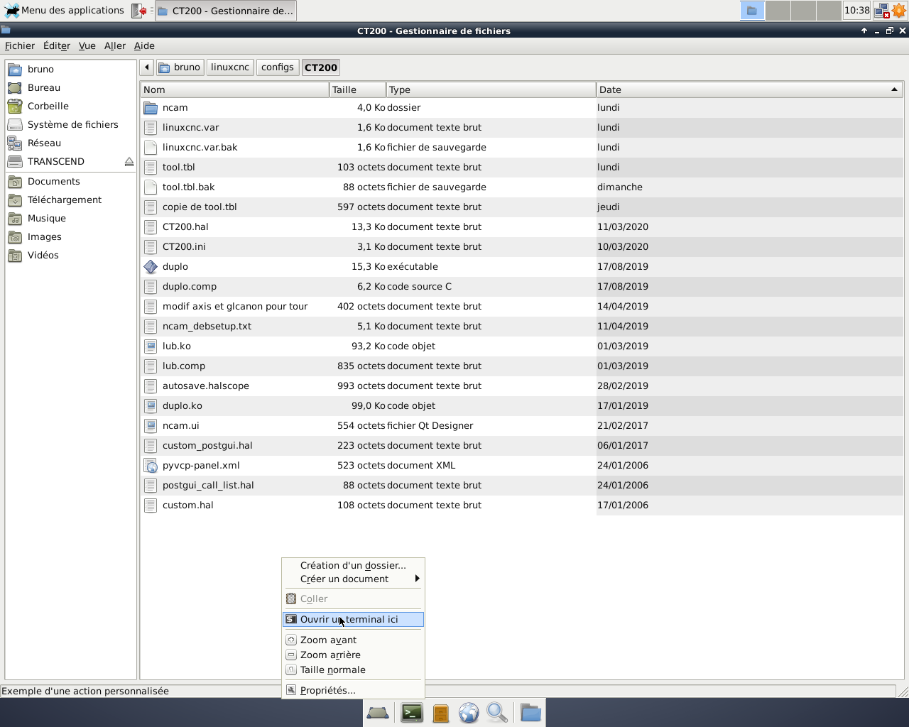

Sorry when I ask again because of compilation. When I made that with halcompile, then I get I entry in /usr/bin with name duplo. And that is all. Is that correct or have I to copy manually the duplo.comp in specific directory? Maybe to /usr/lib/linuxcnc/modules. Maybe you can take a look at your directories.

I tried to compile the component on a 2.8-rtpreempt system and it does not compile. Well it does, but only creates duplo file in /usr/bin and not a .so in /usr/lib/linuxcnc/modules/ like other comps.
I see in your output that you have a rtai setup. Did you ever try with rtpreempt?
Is there a reason that you use the option "option userspace yes", it doesn't seem to be so common anymore.
when a component has a lot of time-delayed logic, it is not reliable in realtime, code parts are not taken into account.
In userspace, we are free to do what we want.
