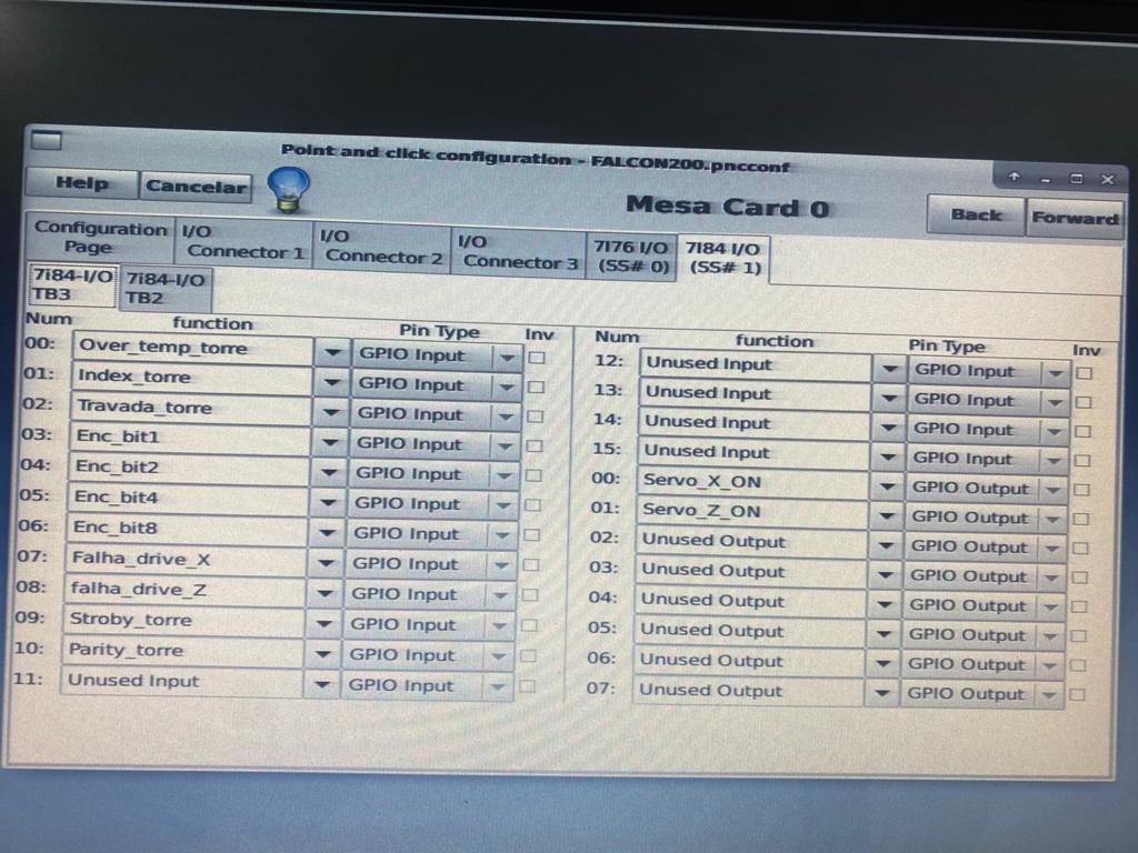

09 Jun 2021 04:49 #211586
by Ingo
Replied by Ingo on topic Duplomatic BSV N 160 Werkzeugwechsler / Turret
Hi guys, I was reading, looking for something about the model of my Turret (BSA 200 12/20), but as I'm nob here I'm suffering a lot..., actually I was very confused. First of all, I don't know if I can take this model from you because you are different. Another thing, my 12-position turret, I use the inputs, Bit1,2,4 and 8 I know it also has Parity and stroby (I don't know what it's for, how do you use it), it still has over temperature, index and locked... ., how I use all this, could someone clarify me, show me the way, because I'm using 7i76E and a 7i84 daughter (including all turret entries are on it).
Thank you very much
Ingo

Replied by andypugh on topic Duplomatic BSV N 160 Werkzeugwechsler / Turret
"Strobe" is used to indicate that all the position signals will have settled and can be trusted.
"Parity" is a check that all the signals are working properly. (It basically will show a 1 if an odd number of sensors _should_ be triggered and 0 if its an even number. By comparing the parity pin and the actual pins you can check the sensors.
The HAL "carousel" module can handle all this.
