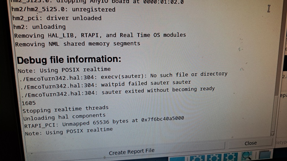

Hi All,
I've started working on the turret on my Emco lathe too.
It's a Sauter turret and there are many simularities with the Duplomatic turret described in this topic.
I connected all signal pins, like encoder and proximity detector, and if I manually turn the turret I can monitor the signals with Halshow in Linuxcnc UI.
Now I modified the duplo.comp file a little to match my signals.
From this topic I understood I should compile this sauter.comp file like this from within the config folder of my linuxcnc configuration:
sudo halcompile --compile --userspace sauter.comp
It seems to compile without errors and as a result I do get a new executable file called sauter (also in the same config folder) and I call this file from my main hal file like this:
loadusr -W sauter
Unfortunately, when starting LinuxCNC, I do get this error which I don't understand and hope to get some help from the experts here at the forum:
Can anyone help and explain what I might be doing wrong?

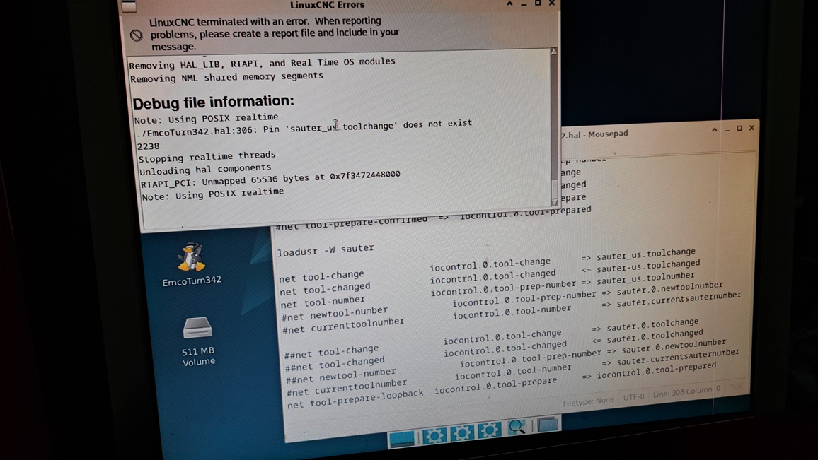

please forgive my stupidity.
after compiling I should have done the next step too I now see:
sudo halcompile --install --userspace sauter.comp
This seems to get me a bit further into debugging.
I get a Pin 'sauter_us_toolchange' does not exist error, which I don't understand yet.
as I did initiate it in the main hal file:
net tool-change iocontrol.0.tool-change => sauter_us_toolchange
Anyone has a clue of what I might be doing wrong?

seems that you are mixing underscore with hyphen in the hal
sauter_us. VS sauter-us

Thanks for waking me up
It's even worse, not only - and _ got mixed up, it should have been:
net tool-change iocontrol.0.tool-change => sauter.0.toolchange
net tool-changed iocontrol.0.tool-changed => sauter.0.toolchanged
net tool-number iocontrol.0.tool-prep-number => sauter.0.newtoolnumber
Now Linuxcnc at least starts ok again. Let's see if I can get the turret move...
