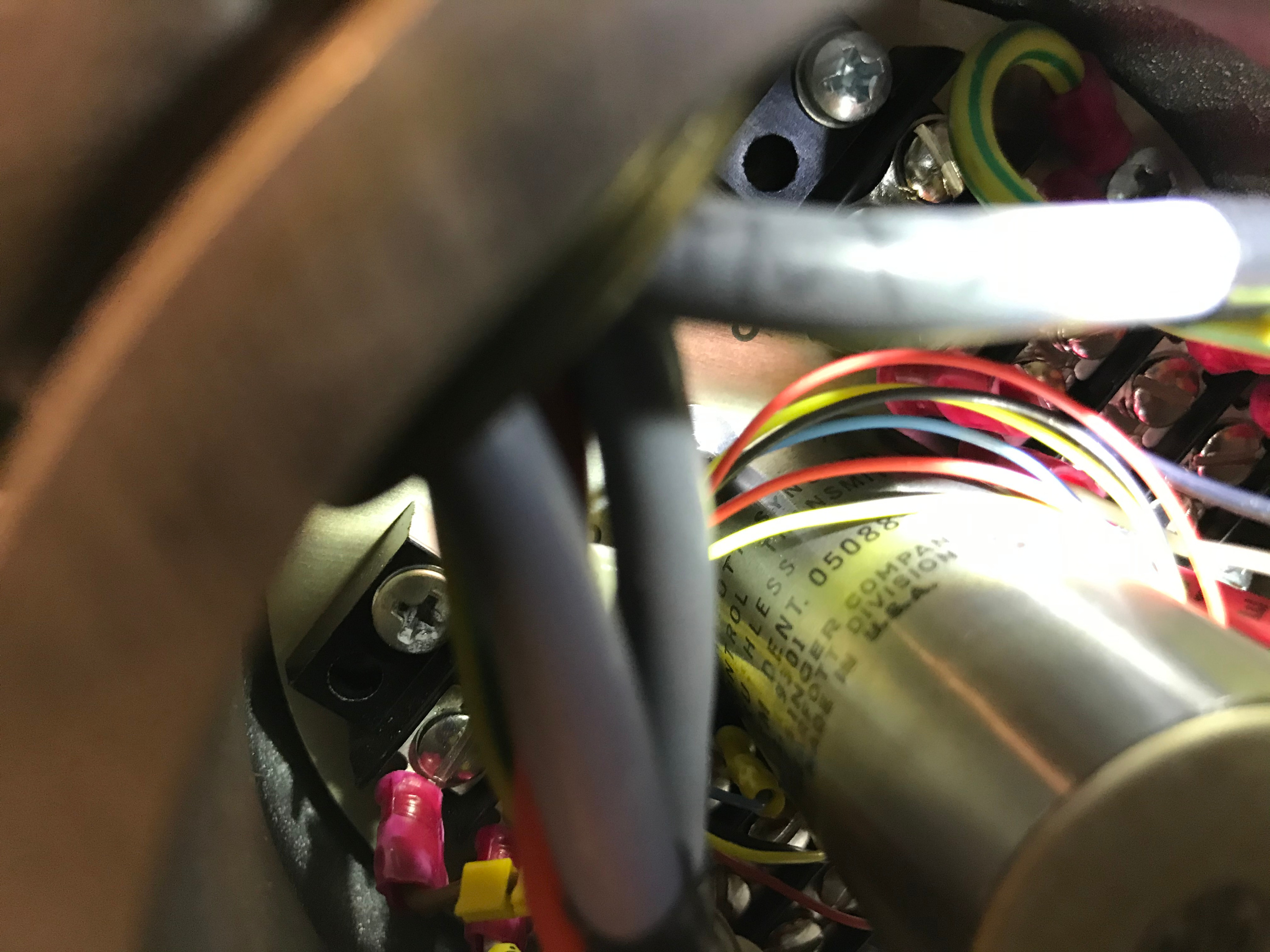

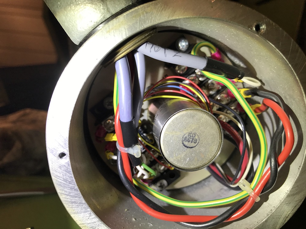

Good questions thanks. The only information in the manuals is that they are permanent magnet servos. I find it difficult to beleive that a company like that would confuse resolvers for tachos or encoders. Especially as the same wiring diagram includes the Heidenhain encoder for the main spindle.
This is the view up under the lid of the Z axis motor.
Last edit: 22 Feb 2021 13:33 by RotarySMP.
- db1981
- Posts: 790
- Thank you received: 276

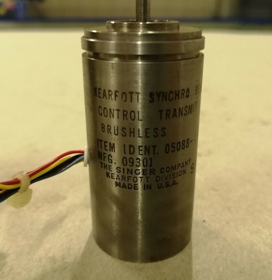

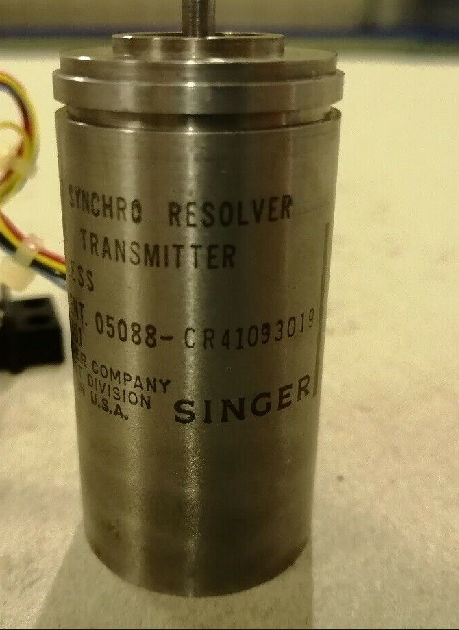

22 Feb 2021 14:12 #199705
by db1981
Replied by db1981 on topic Schaublin 125-CNC retrofit.
that's an old kearfott singer resolver.....
then 1 wire is shared with one of the motor wires.

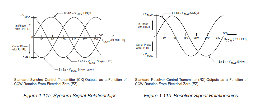

- Posts: 4818
- Thank you received: 2176
22 Feb 2021 15:09 - 22 Feb 2021 15:21 #199716
Replied by Aciera on topic Schaublin 125-CNC retrofit.
You might actually want to inquire whether the 7i49 can actually handle this kind of "3-phase" resolver.
[edit]
I guess the proper term is "synchro resolver" or just "synchro"
[edit]
