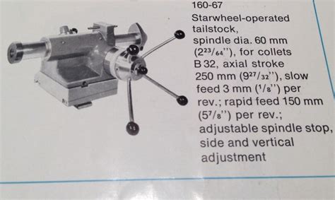

Hi Mark
Congratulations for the new Green Machine ! Any chance you could drag some of the German website Schaublin 125 conversion photos to here?
The missing tailstock
Now you can design an cast one that is more useful than the original part . Incorporate a bar puller - starwhell quill - etc. . Something like a 160 series tailstock .
Read your thinking of using a 7i97Bd. an wondered if you had considered using a 7i98 as used in "Retrofit of a Hitachi - Seikei VK45 Mill " . . Would also be interested in your thoughts about motor an drive for the spindle . Just interested in your thoughts .
Bob
28 Feb 2021 11:54 #200446 by andypugh
Replied by andypugh on topic Schaublin 125-CNC retrofit.
There is a 125CNC here with the starwheel tailstock:
www.exapro.com/schaublin-125-ccn-p90724026/#
Oh, and here is a conventional one for sale. The video is from 2015, but at the asking price I am not surprised that he still has it:
www.nielsmachines.com/en/schaublin-125-tailstock.html
Reading around, the 2-speed star-wheel Schaublin tailstock appears to be very desirable.
My mate Jörg, who helped unload and drag it into the garage has a 125-CCN, the later model with the Fanuc controller. He has one of those star wheel tail stocks in his. I guess the pneumatic tail stock was not that popular, s all the later ones I have seen have the star wheel one. I plan to borrow Jörgs tail stock and copy it.
Mark.
