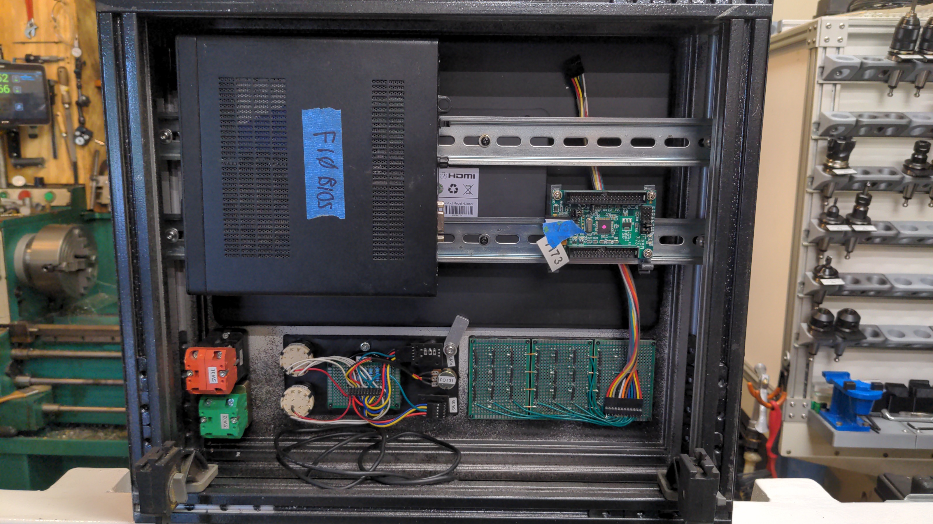

Internals.
T-slot framing makes mounting everything a breeze.

Spumco. The plan is to get sheet metal lasered for the housing. I really like the solid feel of a welded sheet housing. My time problem is more just a priority issue, that a couple of other projects like the DoAll gearbox suddenly pushed themselves into pole position.

Your enclosure and control layout looks brilliant Mark.
Well done on the button sub-panel. If you don't like the layout after using it for a while it's not a nightmare to change the arrangement.
Thanks for the great vid!
