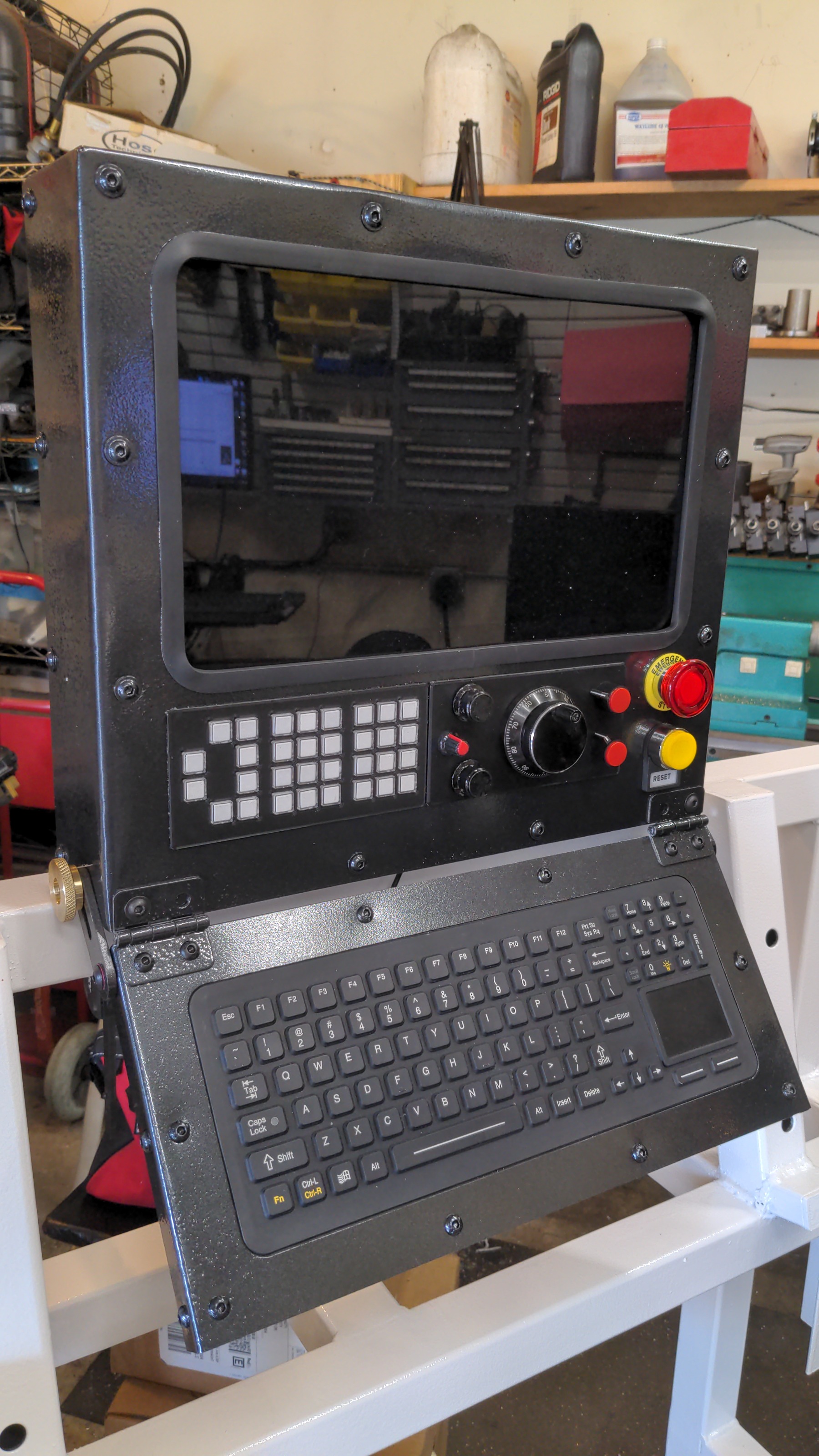

01 Sep 2023 18:36 #279598
by spumco
Replied by spumco on topic Schaublin 125-CNC retrofit.
[Mark - didn't want to keep hijacking Andy's lathe macro thread with unrelated jabbering]
I get it: time is tight.
Can I suggest throwing a bit of money at the control panel problem and saving some time?
You mentioned a while ago you wanted to repurpose the Maho's control panel. That's going to take quite a bit of work to chop that thing up, weld it, and then do all the finishing. Maybe a long and messy enough job you've been procrastinating... I know that much mess in a small shop would put me off.
I've built two operator stations in the past year and they've both gone quickly and pretty painlessly. The basic construction uses aluminum t-slot extrusions as a frame, and then skinned with thin sheet metal (in my case I used some 0.040" ALU borrowed from some race car body off-cuts).
The frame members are connected without expensive brackets, and the skin is screwed to the t-slot frame - no welding. All the extrusions were purchased pre-cut, I just tapped the ends with a cordless drill. Ordering pre-cut was the way to go; $20 upcharge and all the ends are square and lengths are extremely precise.
Since the t-slot rails have 4 sides, this construction arrangement provides very easy internal mounting of DIN rails, monitor, PC, switch panels, Mesa cards, etc. Also makes it easy to bolt to an arm or stand from the sides, top or bottom.
Buttons/switches are installed on 3D printed sub-panels that snap in to the skin. That way an error in button placement is easily corrected - just adjust and reprint.
Monitor is based on one of the 15.6" 1920x1080 touchscreens available on Amazon. Standard size, not expensive, runs on 12V so you can use a decent power supply and not the dumb wall-wart. Monitor opening is trimmed with wide, cheapo Amazon rubber edge trim so no need to have a precision hole lasered out.
I know you can get t-slot extrusions... not sure about cutting services inside the EU, but I'm sure you can find a supplier.
Not trying to be Mr. Clever here, but if I can save myself a weekend or two of work for a hundred or two bucks I'm all over it. Maybe that sounds appealing to you, too.
If it sounds interesting, I'd be happy to model something up for you to use. Tell me extrusions available to you (prolly 20mm or 30mm in your neck of the woods), and I'll send you a .stp or .f3d file with a control panel:
How about something like this, except painted that vulgar green you like? Seriously... you say go, and I'll send you the shopping list.
I am struggling with constant other projects becoming sort of urgent, so the Schaublin progress is really suffering. I really need to make the control panel for it, and then get on with stripping and cleaning the tool changer. I dont see a bar puller in my future, but who knows.I get it: time is tight.
- Suitable for Gmoccapy (buttons along bottom & sides)
- 15.6 monitor
- Hinged mount for keyboard w/trackpad
- Control cut-outs for
- Gmoccapy controls
- 4x8 matrix pushbuttons for 7i73
- Easy to use tactile buttons on pre-drilled proto board. 30 minutes to solder everything and attached to a 3D printed snap-in mount
- If you're low on inputs, the Gmoccapy buttons can be part of the 7i73 matrix electrically even if they're not physically adjacent to the other ones.
- Built-in MPG (or not), plus encoders for FRO, SRO, and JRO
- Whatever else you want
