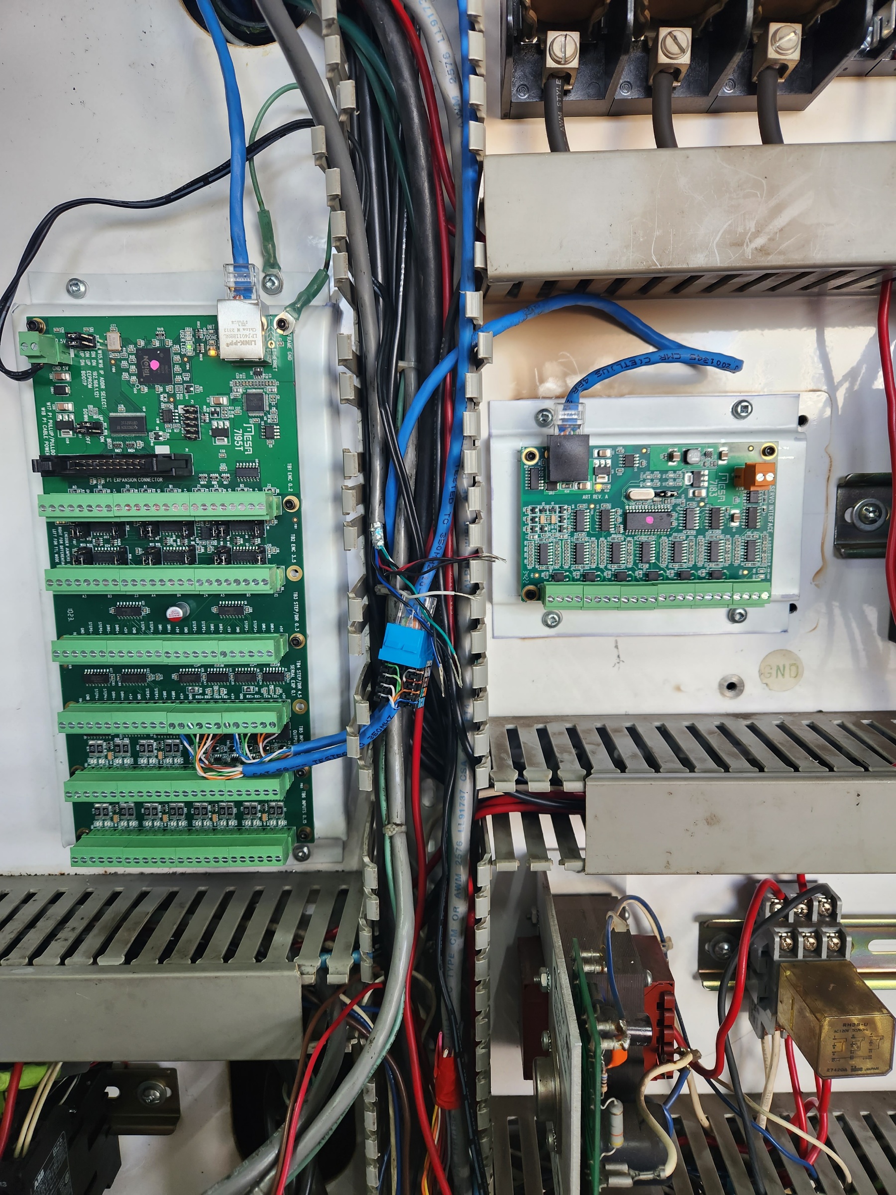

Replied by tommylight on topic Standard-modern 1700 series retrofit
You are striping and wiring wires above them, those have lots of holes, a single very small piece of wire falling down can mess something up.
Cover them.
That is not a request, it is an order!
Cover them.

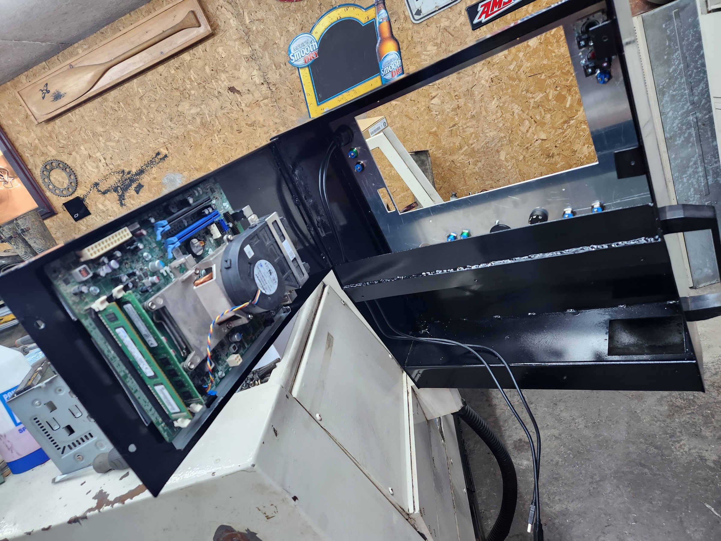

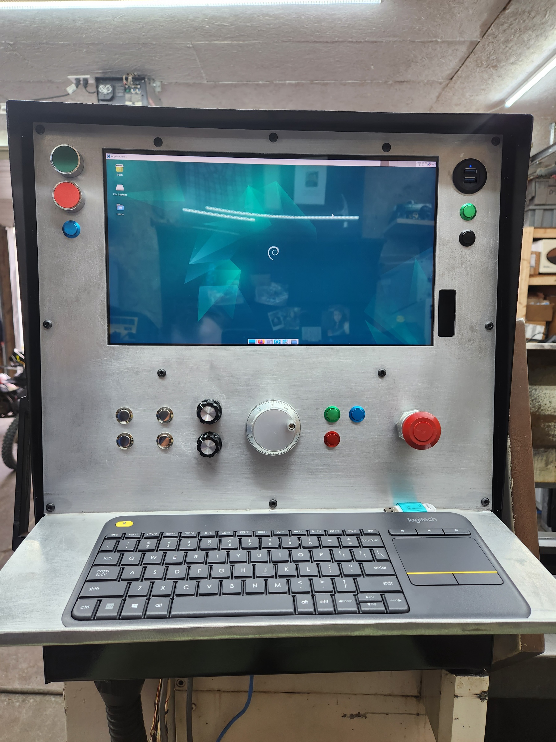

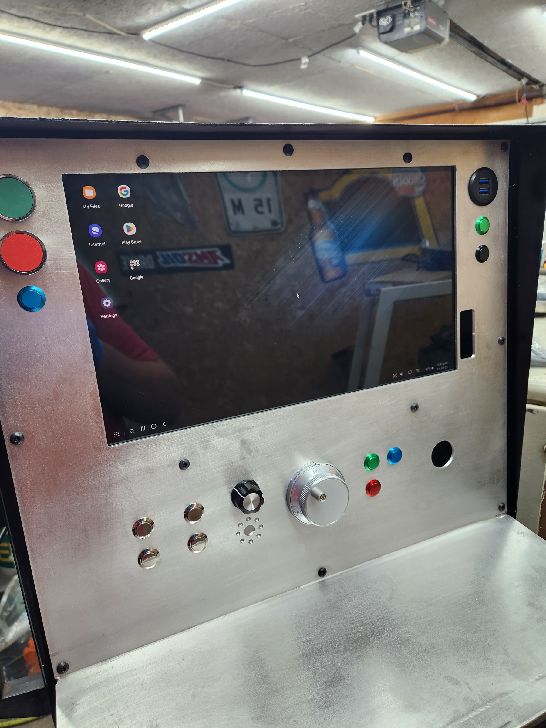

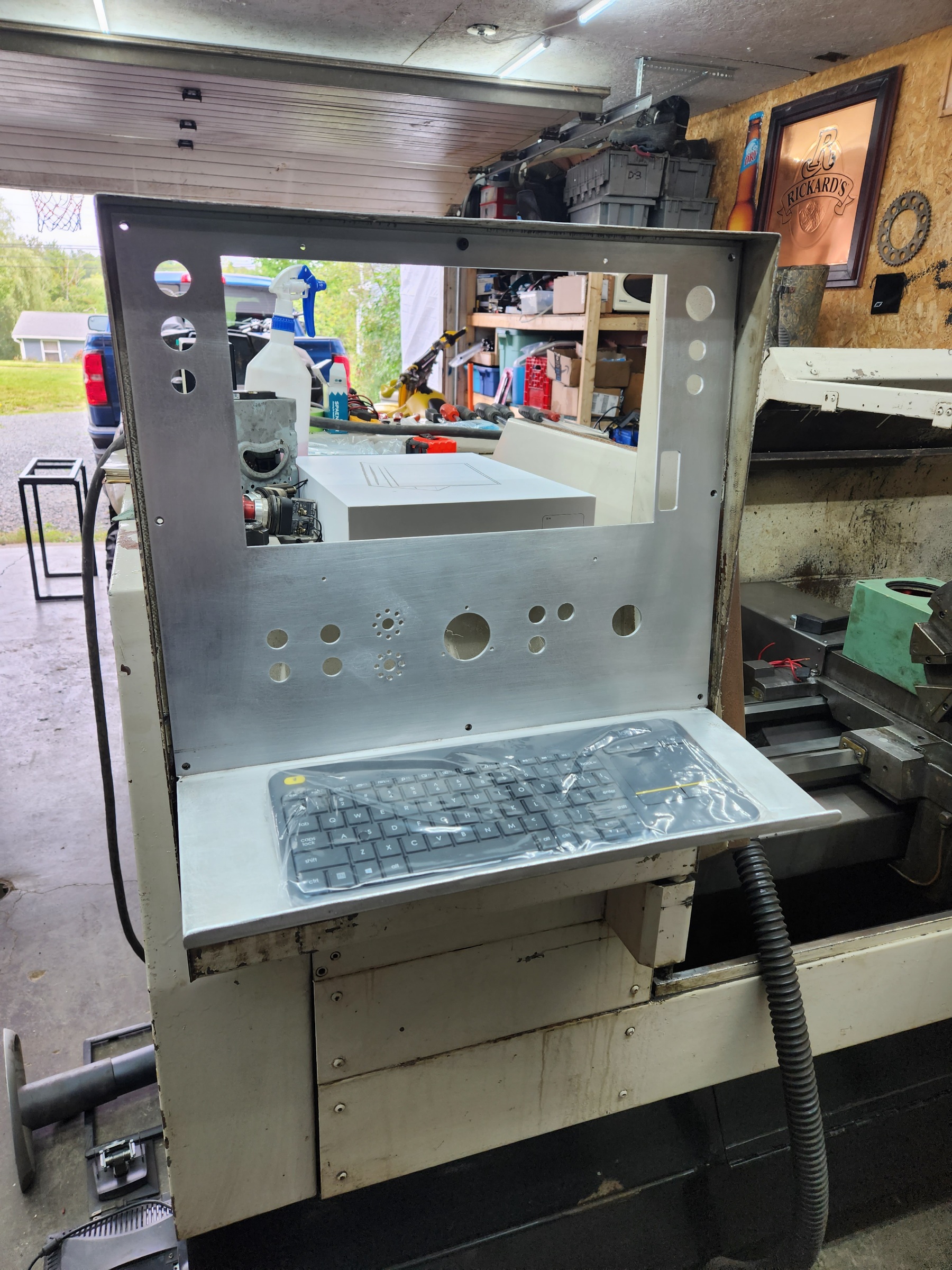

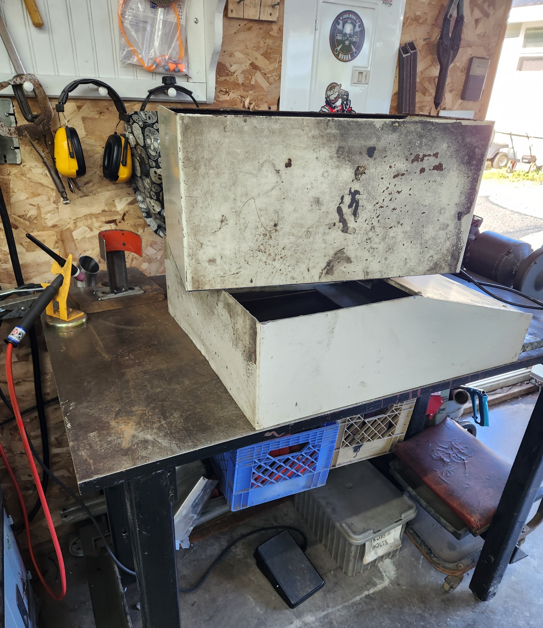

Had some time to make a bit of progress on the pendant.
downsizing the portion that held the CRT.
got the front panel from laser and bent up the tray.
The pc motherboard on the new swinging access door , still have to extend the wiring for the power supply.
where I left off for the night , just had the monitor running off my phone for a test , managed to lose a nut from one of my rotary switches.

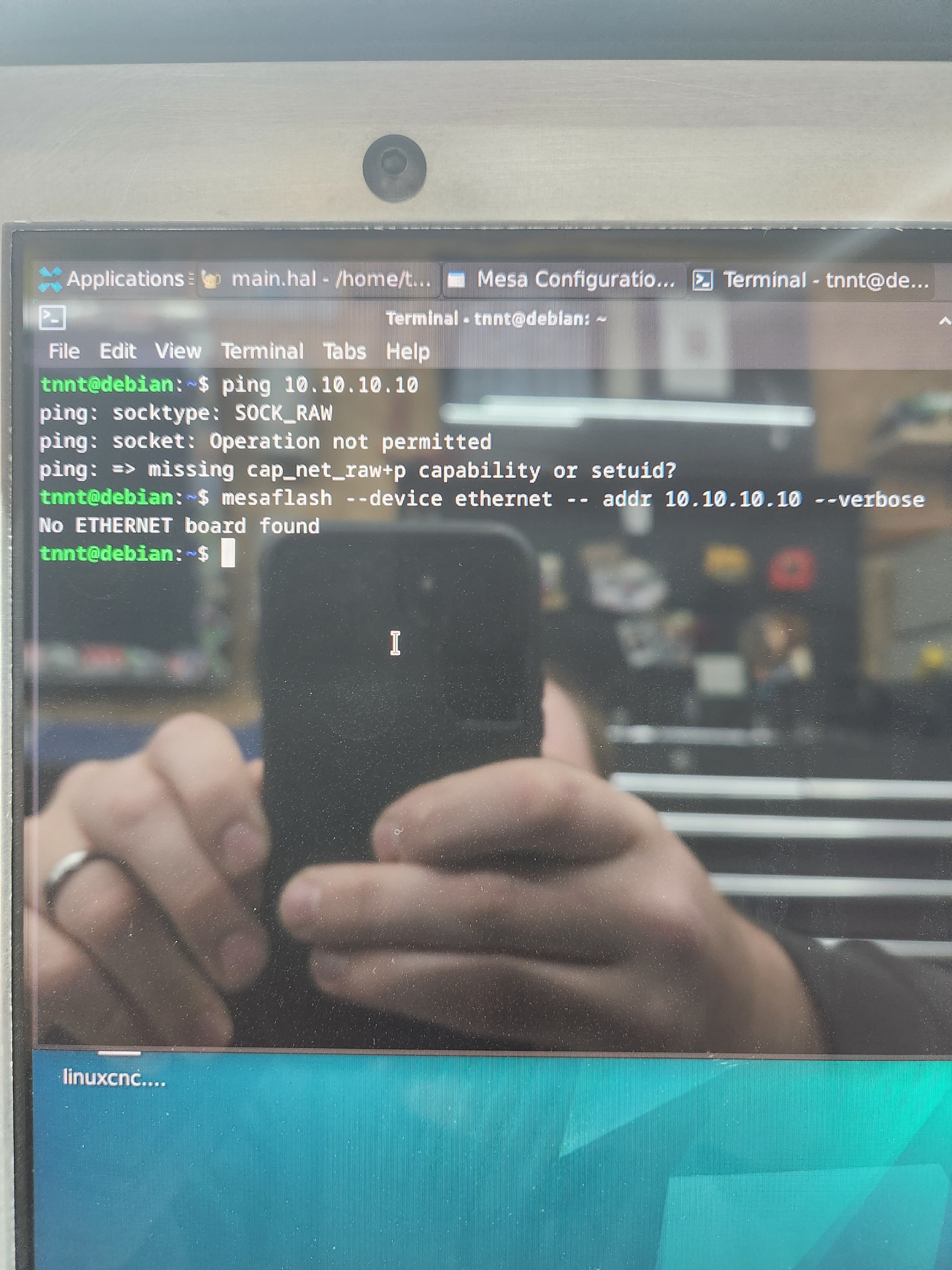

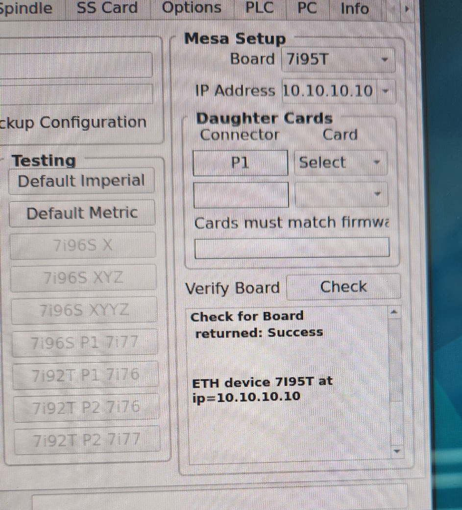

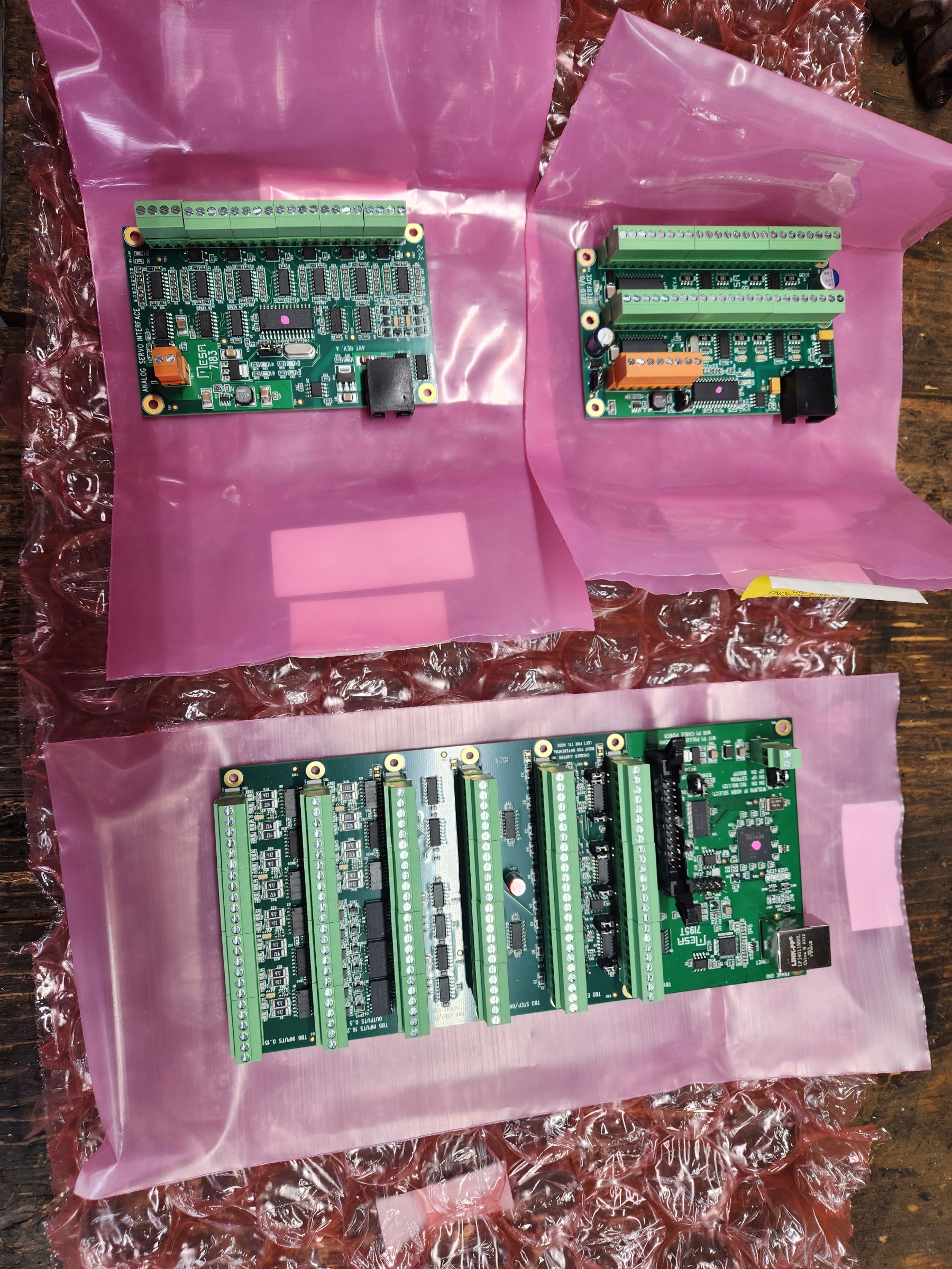

managed to go out to the garage after work and after some time zone issues i got 2.9 updated , i used mesact to make a super simple config to start with , but now im getting a watchdog error , error report attached . does this have anything to do with the wiring of my smart serial cards ?
hm2_7i95t.0.watchdog.timeout_ns' not found

Watchdog error had to do with mesact needing a update.

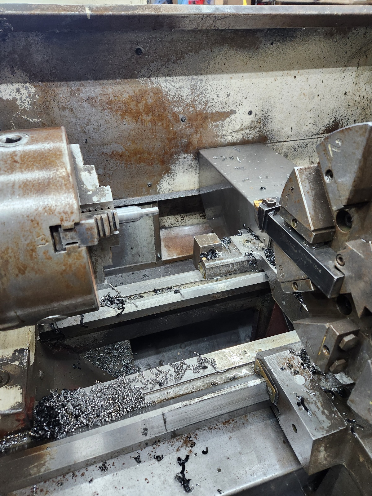

20 Oct 2023 22:28 #283395
by Trav328
Replied by Trav328 on topic Standard-modern 1700 series retrofit

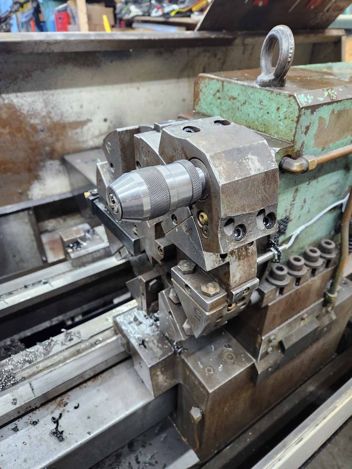

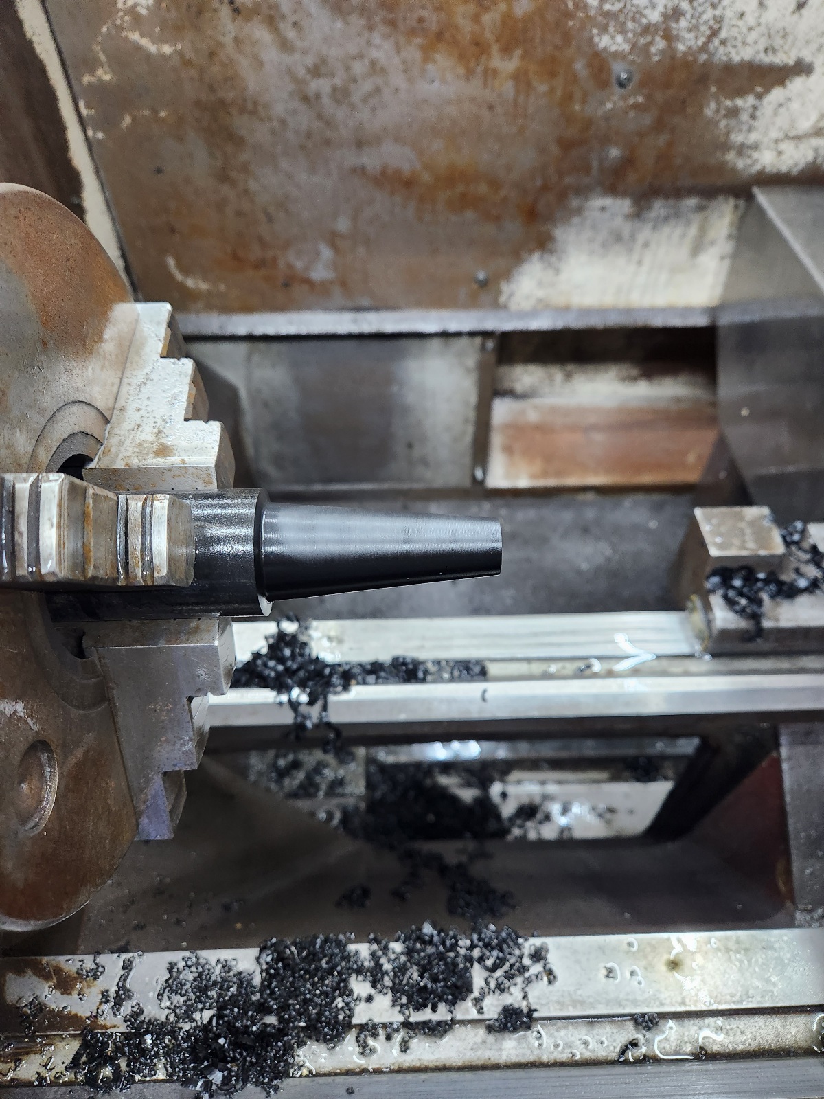

For the first time in 15+ years the standard modern 1700 is cutting metal , got the tool changer sorted out and did some test cuts in plastic before making up a jt1 Arbour.
Hige shout out to the people around here for all their knowledge.
Have to sort out my g2/g3 ijk in my cam post but we're on our way.
