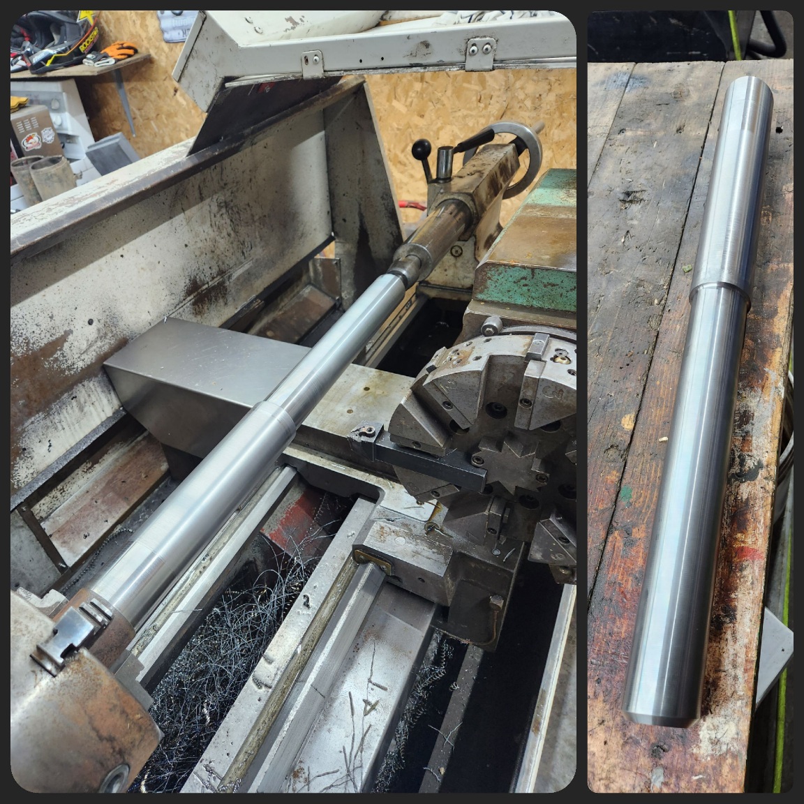

The iron was in too good of shape under all the storage grime , i couldent let it go to be chopped up.

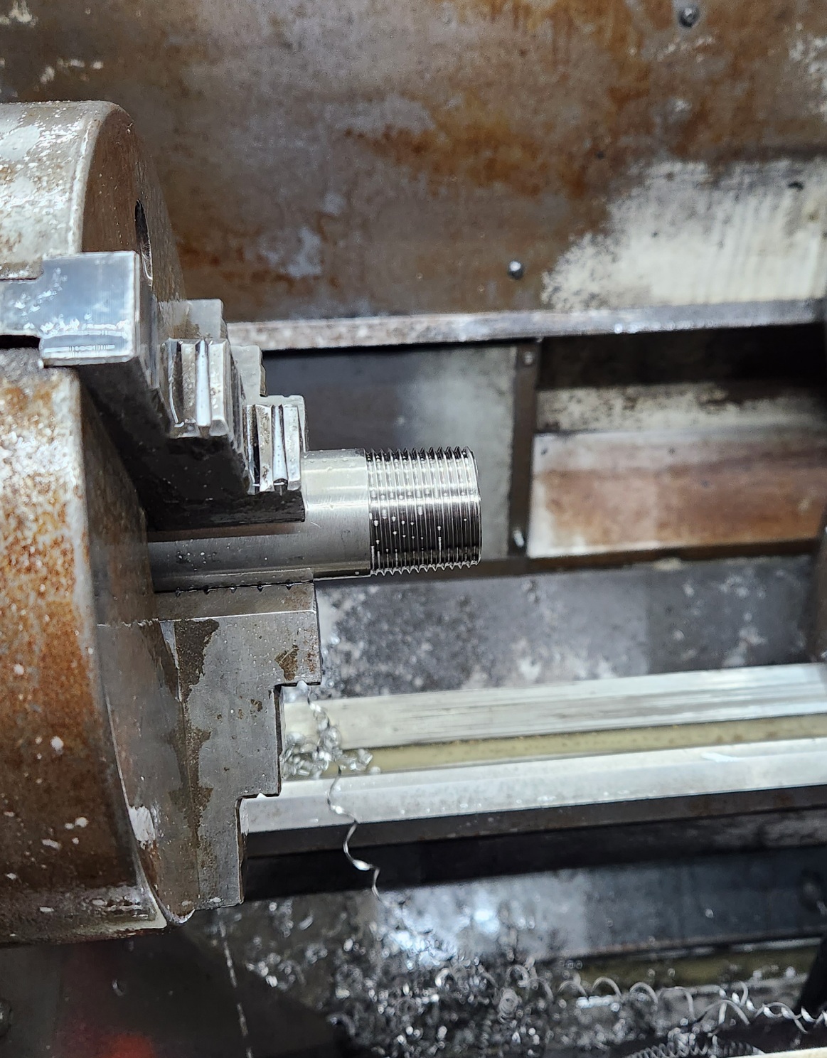

Got my mastercam post setup to do everything I need , cut some tapered npt threads in some sch80 1" titanium pipe , more impressed with every job I do. Now it's time for some cleanup and maybe a paint job. I added my post to the mastercam section of the site of anyone is in need or wants to use it for reference.
