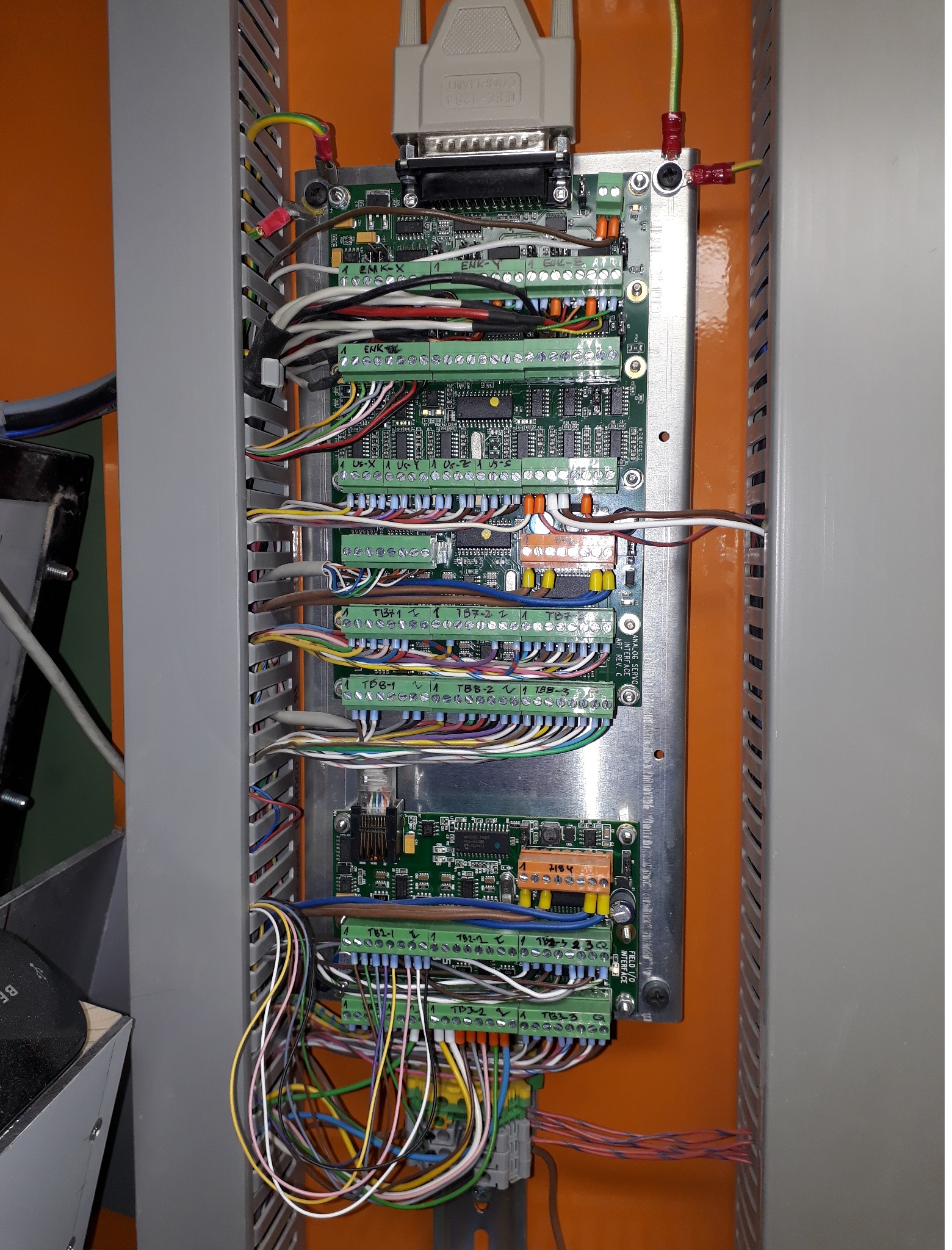

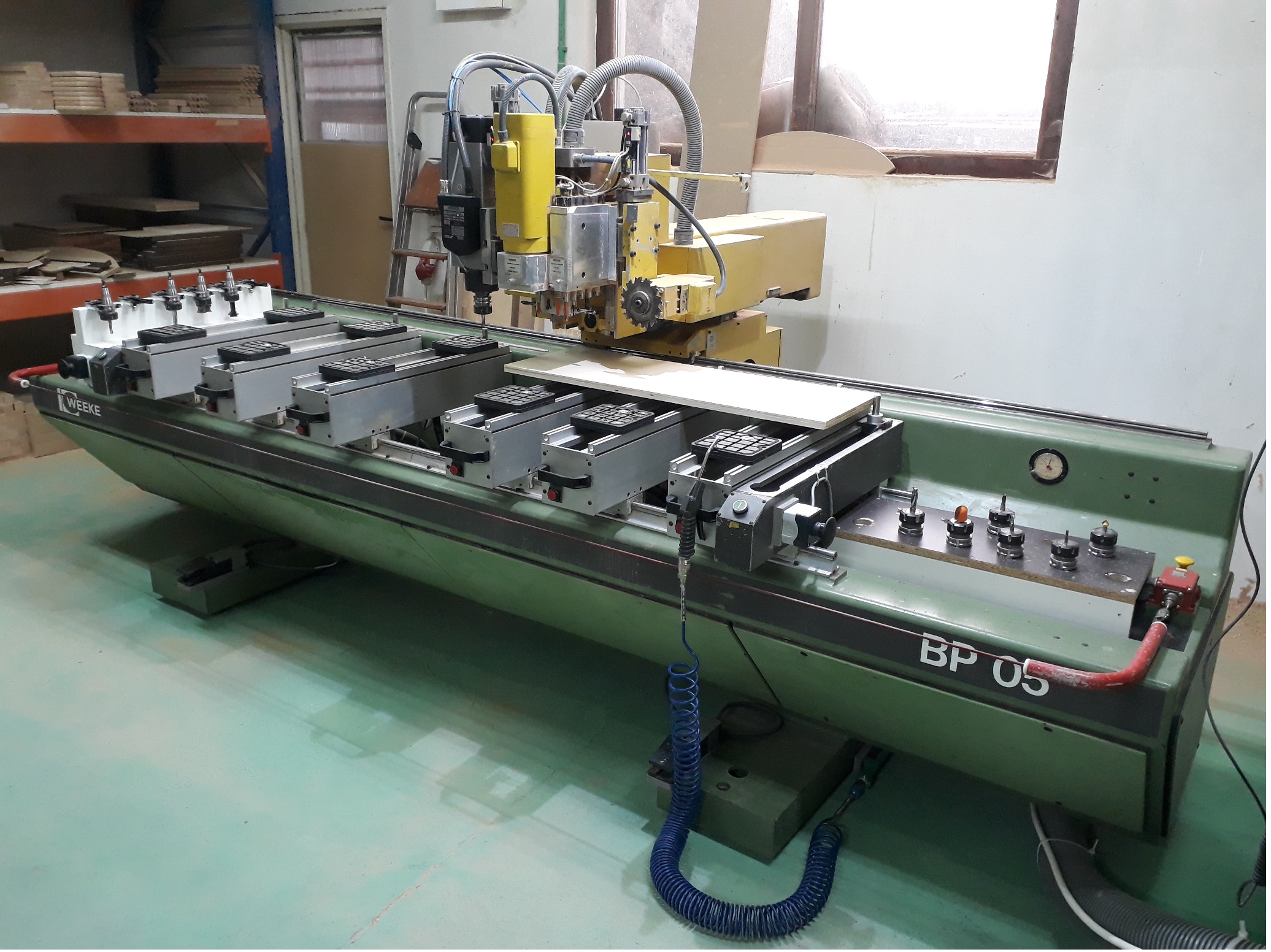

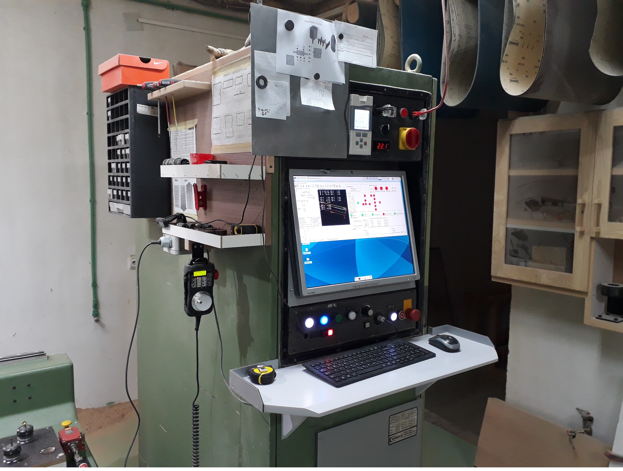

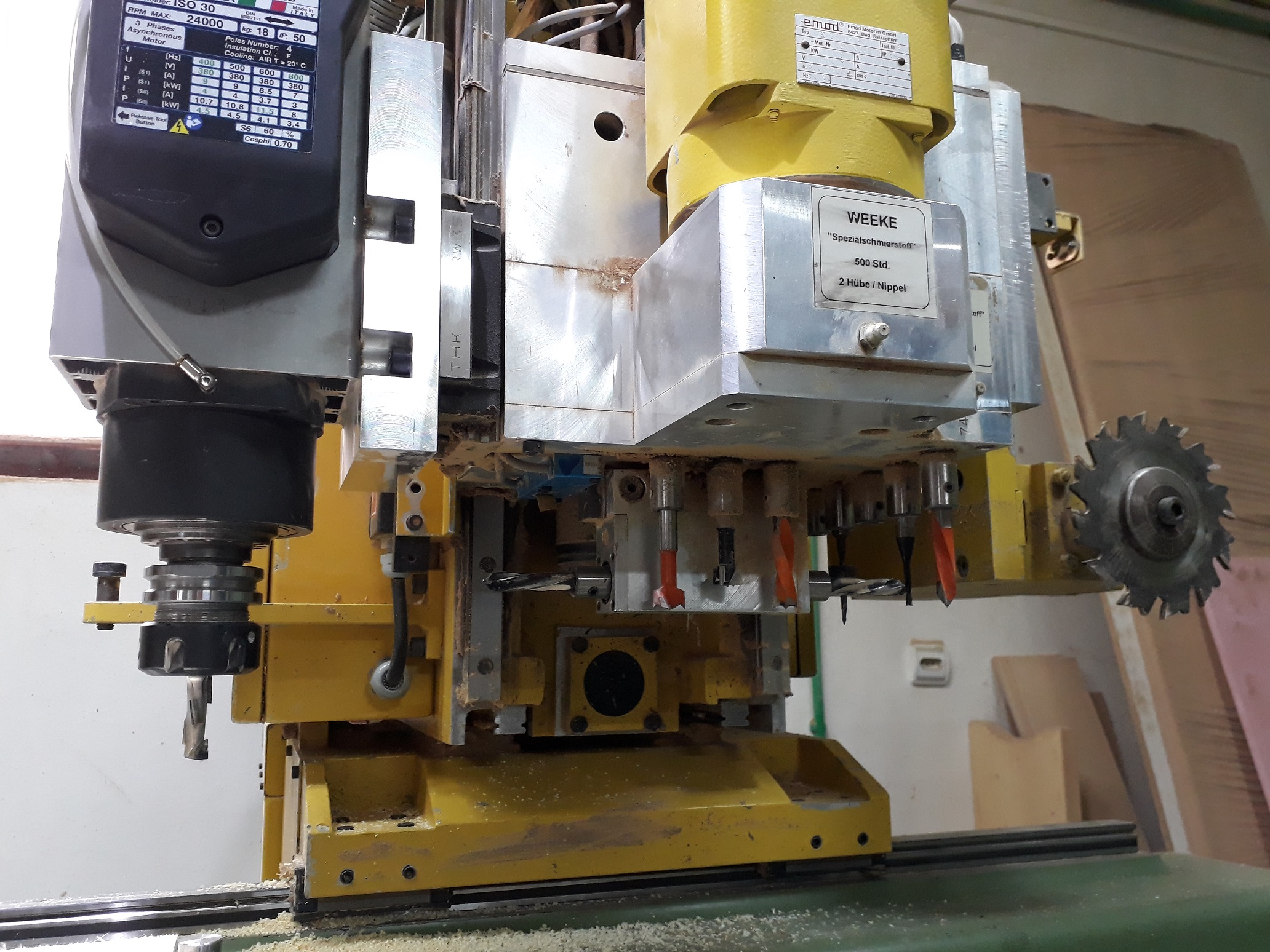

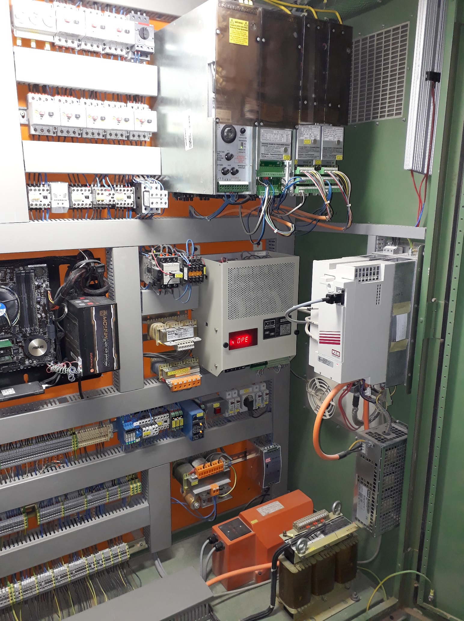

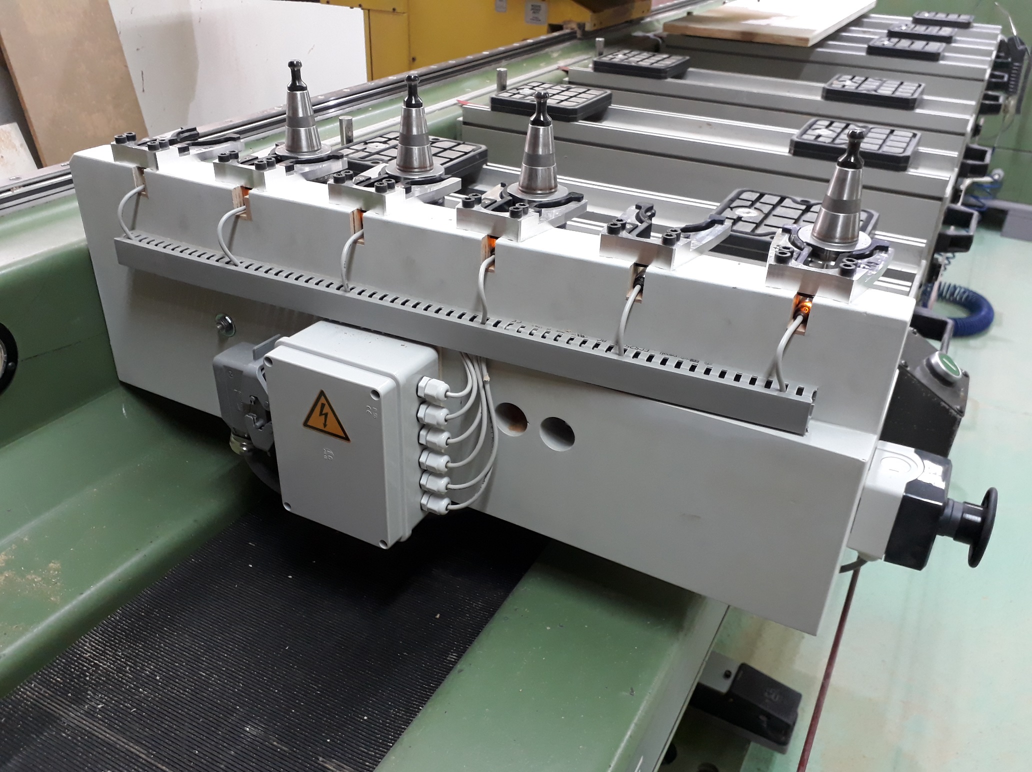

Replied by urkee on topic Retrofitting WEEKE BP05
Retrofitting is almost finished, thank you all, for your sugestions. Does anybody know is there option to remove third zero in AXIS dro (to downgrade precision in mm) i think it could help us to make good PID tunning. We have problem, maschine moves jerky and vibrates when standstill. Weeke is woodworking maschining centre with 0.006375mm encoder count, and 0.00mm DRO could make things easier that could be good option for all woodworking maschines.
