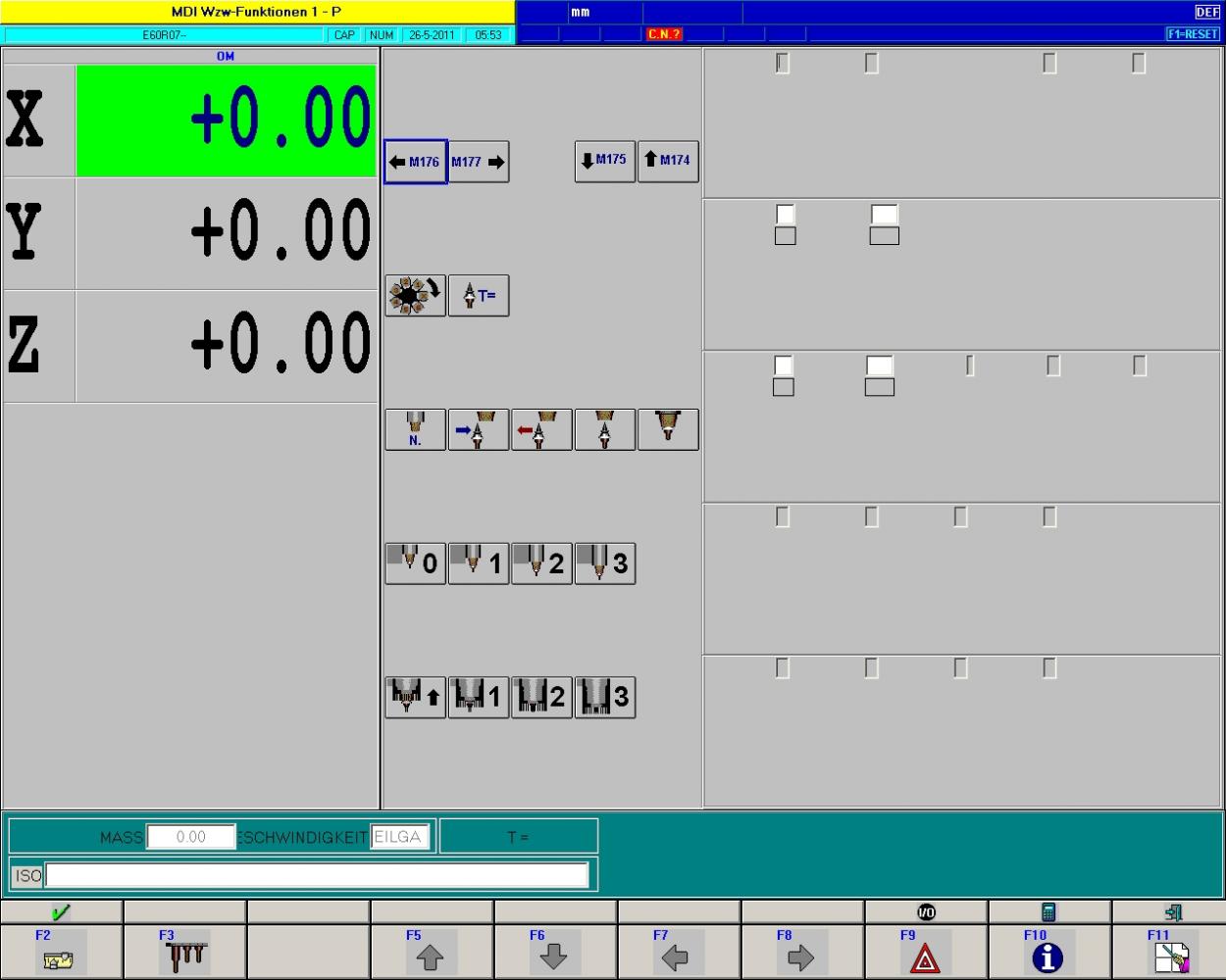

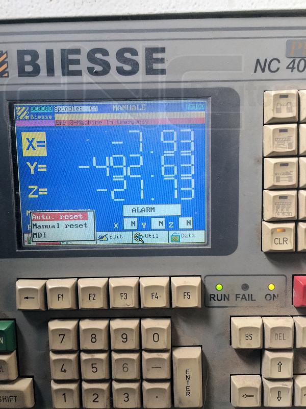

Andy i was thinking about option to decrease DRO precision in mm to reduce number of zeros from 3 to 2 like on woodworking cnc controls HOMAG, BIESSE, SCM see in attachment. But no only on screen also in LinuxCNC. Todd mentioned in this post that low axis resolution 0.00635mm like on our machine and other woodworking machine can make tunning tough. So i was thinking that reducing LinuxCNC precision on woodworking machines can make tunning easier.
