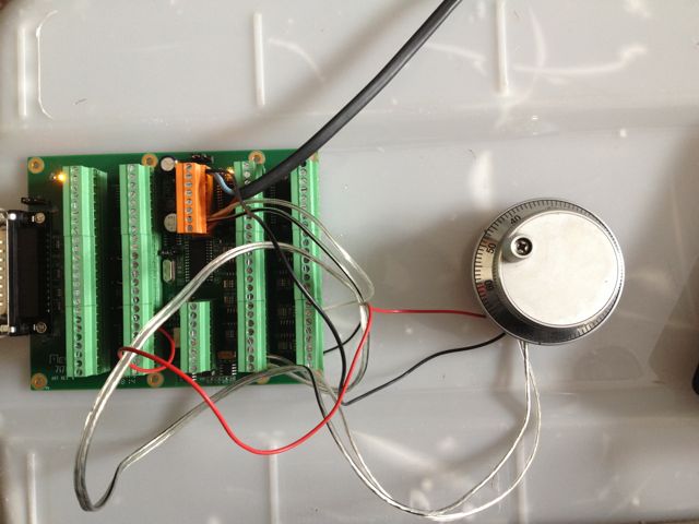

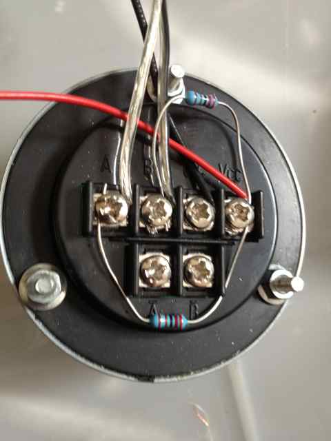

Ok, So I've added 2.2K resistors (I've run out of 2K) between 5v and the A B outputs, this gives me 0V on A and B? Also, if I measure between +5v and Gnd this is also 0v
I've added some pics to show how I've got it set up.
I can't get my head around the wiring, I've had this MPG set up before with a pokeys board with no issues. I would have thought that if the MPG gnd was connected to field gnd then it would need to get its Vcc also from field power? But this is 24Vdc....

20 May 2015 21:30 #58898
Replied by PCW on topic Mesa 5i25 and 7176 getting started
Looks like you do not have the field power ground connected to 5V ground so the MPG has no 5V

20 May 2015 22:28 #58899
by amhfabs
Replied by amhfabs on topic Mesa 5i25 and 7176 getting started
No, thats what I thought. The 5v is currently supplied via the host power option W2 jumper on the 7i76, so 5v is coming from the PC through my 5i25 board and I guess the gnd is iscolated from field power with this option enabled?
I'm going to try a 5v power supply instead of host power option, maybe this ties the gnd terminals? I wanted this configuration in the end anyway as it seems more robust and the PC power is eliminated from the system. It was just handy on my test bench at home...

20 May 2015 22:40 - 20 May 2015 22:43 #58900
Field power is _always_ isolated from the logic side so the way you currently
have the MPG connected (MPG 5V from PC 5V, MPG GND from Field ground)
The MPG has no power.
To make this work you would need to connect 5V GND to Field GND
(This applies whether 5V comes from the PC or not)

- amhfabs
- Posts: 21
21 May 2015 01:44 #58904
by amhfabs
Huraahh!!
Finally I got the counts to show in HAL config for this MPG
So, what I did in the end (with a lot of direction from PCW and andypugh):
Power supplies: 24vdc and 5vdc
5i25: W1 and W2 jumpers both in the down position (breakout power disabled)
7i76: W1 jumper LEFT (VIN + Field power shared 24v), W2 jumper RIGHT (host power disabled)
7i76 in software mode 2: in (my machine).hal string: sserial_port_0=2x *I'm yet to work out if this is correct for my board / setup*
+5V supply on TB3 pin 22, gnd on TB3 pin 24 (control voltage side)
+24V supply on TB1 pin1, gnd on TB1 pin 8 (VIN and Field voltage side)
I have linked the gnds for +5V and +24V supplies
MPG Vcc to 5v, MPG gnd to shared gnd
MPG A to TB5 pin 1 (input 16) MPG B to TB5 pin 2 (input 17)
