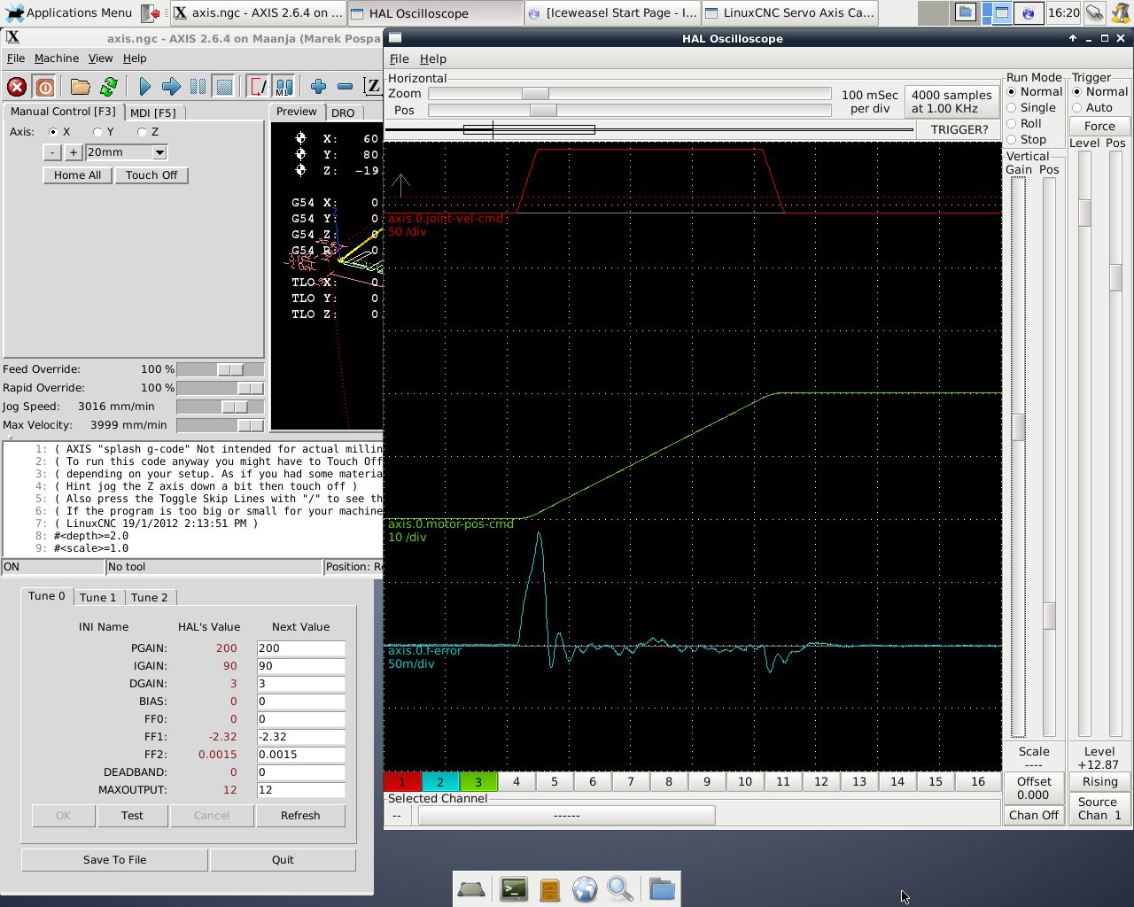

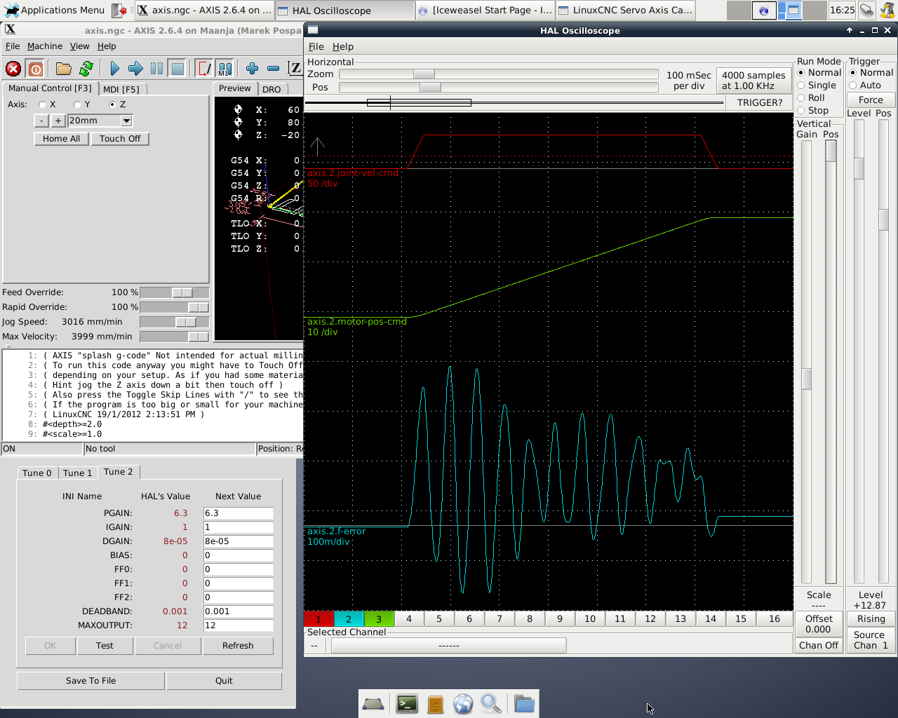

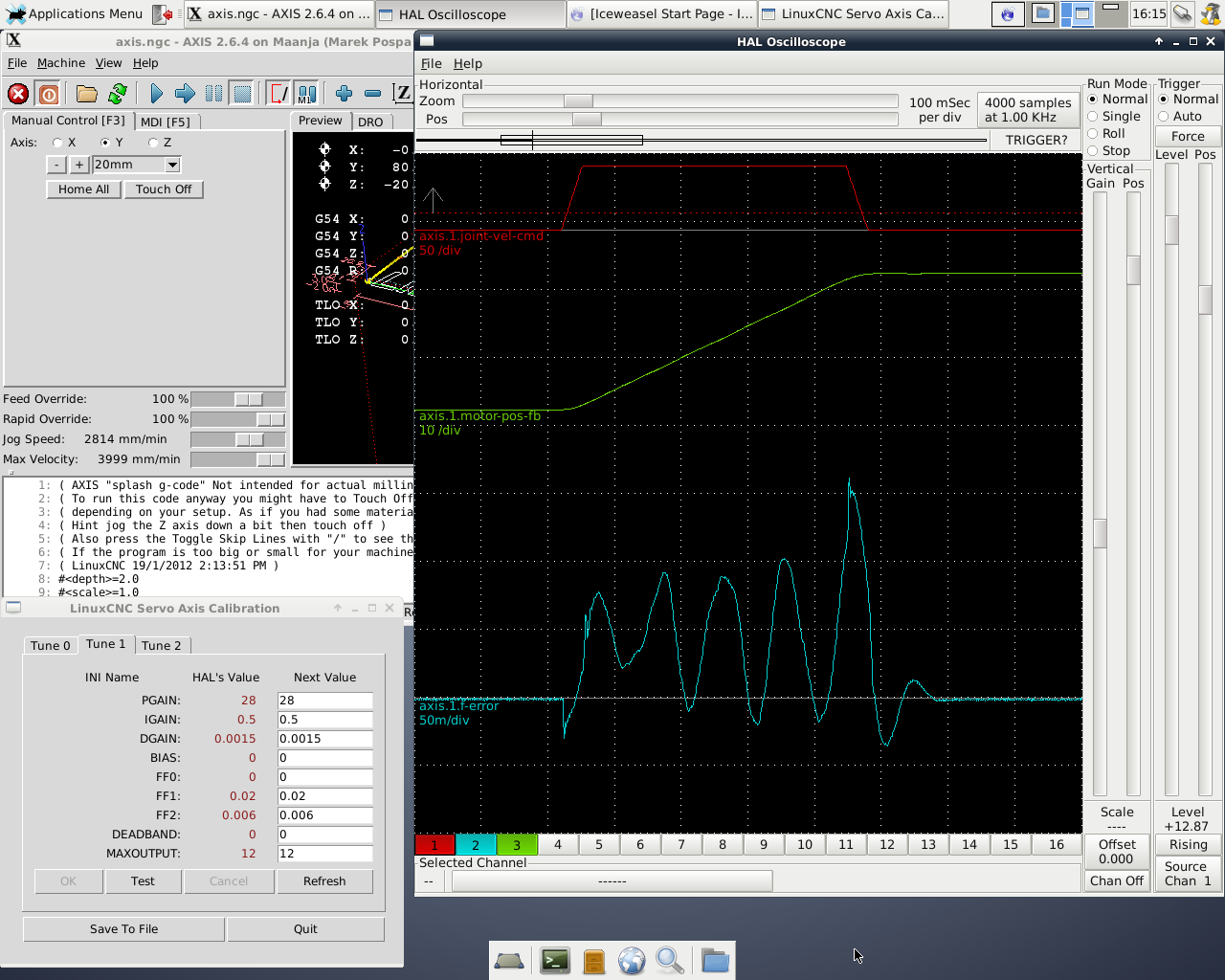

04 Dec 2015 08:15 #66358
by kenny
Replied by kenny on topic MESA 5i23 7i44 7i49 7i37 8i20
Hi Andy,
my servos still have problem.
During motors on, movement extremly oscillation around actually position.
Axis X have belt and pulleys 2:1 and ball screw 10mm (thread pitch) (30mm diameter). 1 turn on the motor is 5mm move on the axis
Axis Y is directly connected (via Oldham couple) to ball screw 5mm pitch (30mm diameter). 1 turn on the motor is 5mm move on the axis
Axis Z is directly connected (via Oldham couple) to ball screw 5mm pitch (10mm diameter). 1 turn on the motor is 5mm move on the axis
1 st screenshot is axis X. This is OK, peak in start movement is caused by belt tension. (It is OK).
2nd and 3rd screen is illustrated oscilation during movements on the asis Z and Y.
These oscillation are minimals of the possible via PID tuning. Two weeks working afternoon to night...
Maybe motors has high velocity, high voltage constants. (?) And servo loop is unstable and oscillating.
PID loop in Mesa is torque mode (?) is possible limiting voltage for speed (rpm) motors? Software decelerate motor?

- Posts: 19899
04 Dec 2015 13:50 #66379
That can't be entirely true, as with zero in all the PID numbers there will be no oscillation, but the position following will be terrible.
If you look at the parameter errorI you might be able to see if it is an I-term oscillation or a P-term oscillation.
You could try setting a limit in maxerroI if it is an I-term oscillation, and if you need such a big I for steady-state position accuracy.
Replied by andypugh on topic MESA 5i23 7i44 7i49 7i37 8i20
- Posts: 18112
- Thank you received: 5331
04 Dec 2015 15:11 #66385
Replied by PCW on topic MESA 5i23 7i44 7i49 7i37 8i20
Since you are running a torque mode drive you need good bandwidth for the velocity loop (The D term)
You can improve the performance considerably by raising the servo thread rate (which will allow a higher D
term which will in turn allow a Higher P term)
1 KHz is typically quite a bit to slow (I would use at leas 4 KHz, this does require a decent CPU)
