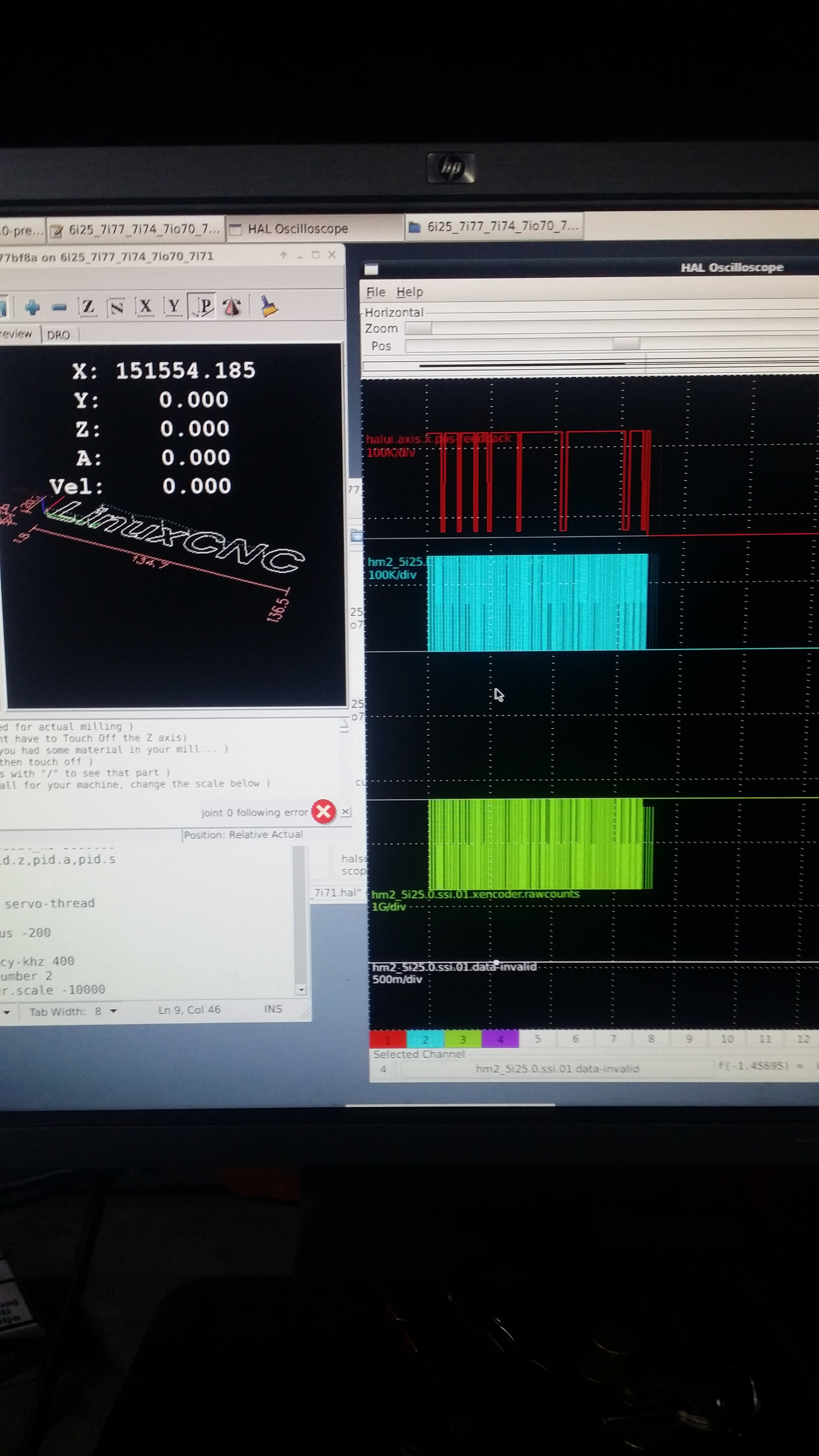

- Thank you received: 5295
17 Jan 2017 14:40 #85925
Replied by PCW on topic SSI absolute encoders and analog servos
Unlike quadrature encoders, SSI encoders need a lot of encoder specific setup
so you need to get a number of things right for the SSI encoders to work:
1. Clock polarity
2. Data polarity
3. Number of bits
4. Gray code or binary data encoding
5. Extra pad or fault bits
Basically this means you need the encoder data sheet or you will be working in the dark
1. Clock polarity
2. Data polarity
3. Number of bits
- Posts: 21819
- Thank you received: 7451
17 Jan 2017 16:05 #85939
Could not find anything about them except the wiring diagrams i have, nothing pertaining to usable info about encoders.
Terkaa, just checked the hal and ini files, they use core_sim4.hal, so it does not use actual hardware, when i remove that line, it does not start complaining about invalid icon size 48.
Replied by tommylight on topic SSI absolute encoders and analog servos
1. Clock polarity
2. Data polarity
3. Number of bits
- Posts: 21819

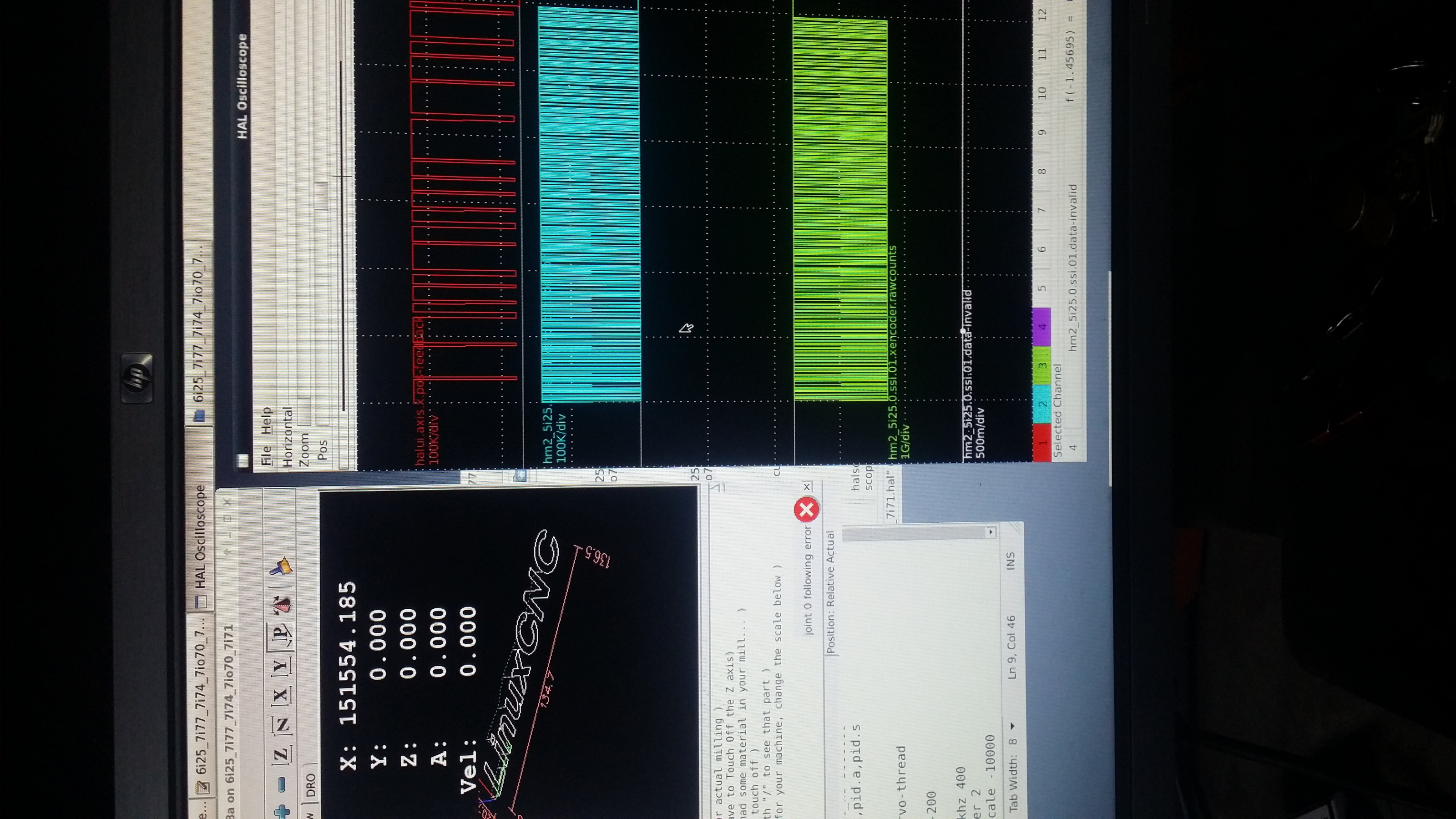

17 Jan 2017 17:49 #85969
Got to this point by trial and error.
See attached
See attached
- terkaa
- Posts: 261
- Thank you received: 3
18 Jan 2017 06:18 #86033
by terkaa
Replied by terkaa on topic SSI absolute encoders and analog servos
I started with core_sim4.hal and modified it to working configuration But it is NOT simulation. It is just a file name...
Tero
Tero
- Posts: 21819
18 Jan 2017 06:54 #86035
Thank you very much.
Thank you Tero, i made a new config with axis as UI and added the stuff for SSI and feedback, got to show something, but still messy, will continue later.I started with core_sim4.hal and modified it to working configuration But it is NOT simulation. It is just a file name...
Tero
