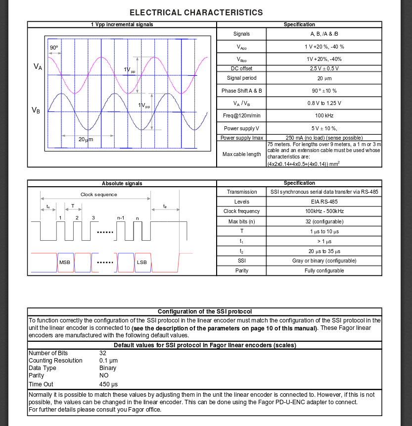

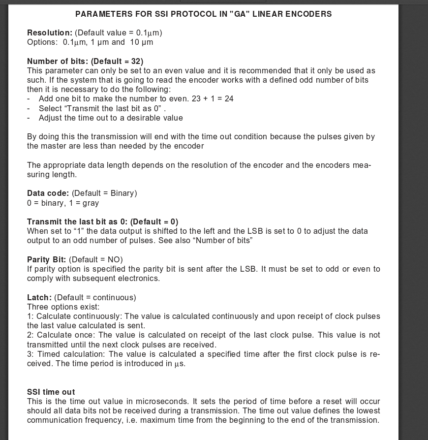

Any possibility that this is related To encoders? Here is data and settings of encoders I am using default ones 32 bit binary no parity.Timeouit 450us
Tero

Theres nothing the SSI encoder can do to cause a time-out so no, its not encoder related.
however, i should test with your encoder parameters just in case theres some edge condition with 32 bit data
