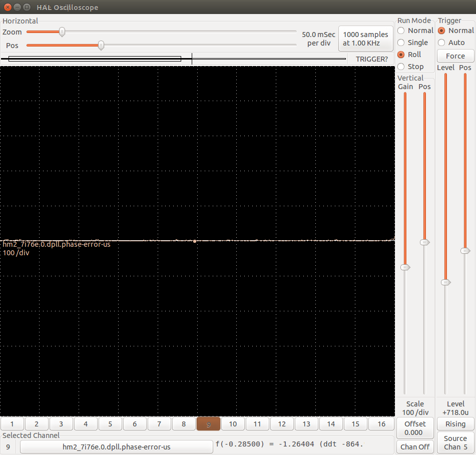

Replied by PCW on topic SSI absolute encoders and analog servos
There may be more going on here than just the wrong base frequency
What kind of latency do you get on that system?
I ask because your DPLL error plot even when adjusted, looks quite bad for a PCI system
For example here is a Ethernet system which should typically have worse latency but is much much better
than your system:
If i get a chance i will try and duplicate your issue here later today and see if I can come up with a workaround
than your system:

28 Oct 2016 01:50 #82162
I did some testing and the standard DPLL has a lock-in range of about +-0.75% at 1 KHz
normally this is OK but the PCI clock is just about that far off on your Motherboard
I made a quick test with variant DPLL tuning that allows about a 3% lock in range
so if you remind me what bitfile name you have, i can make a wide lock-in range version
for you to test. The variant also incorporates a integral term in the DPLL so small timebase offsets
are zeroed
