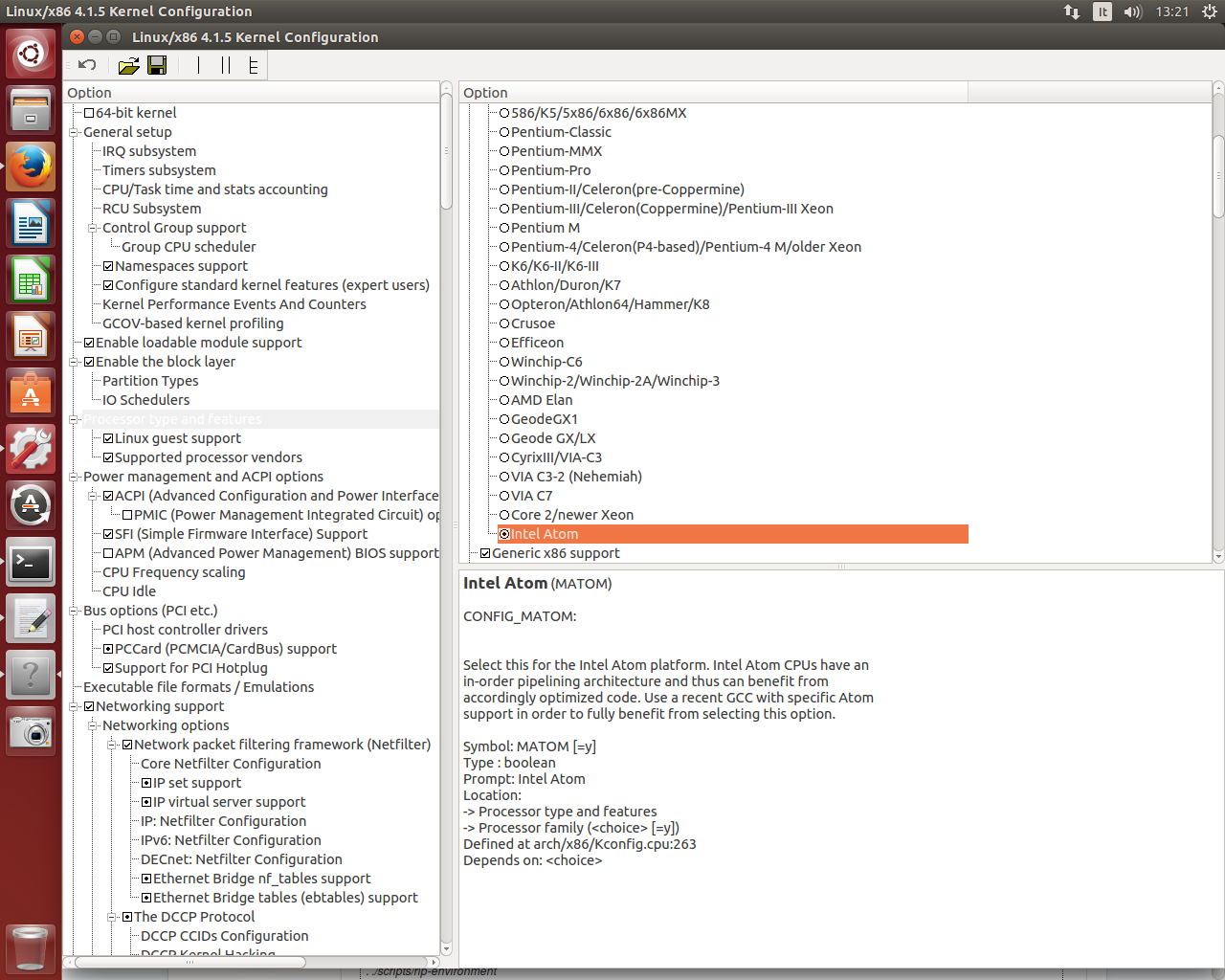

24 Nov 2016 22:25 - 24 Nov 2016 22:36 #83244
Replied by PCW on topic 7i77 5i25 hm2_pci unloaded
When you run xconfig its required that you select at least 2 items:
1. Is the 32 or 64 bit kernel option
( This must match your base OS. Ubuntu 14.04 is available in both 32 and 64 bit versions so this depends on which version you downloaded and installed )
2. Is the real time option, this is selected in the "processor types and features" section under the
"Preemption model" You must select "Fully Preemptable Kernel (RT)"

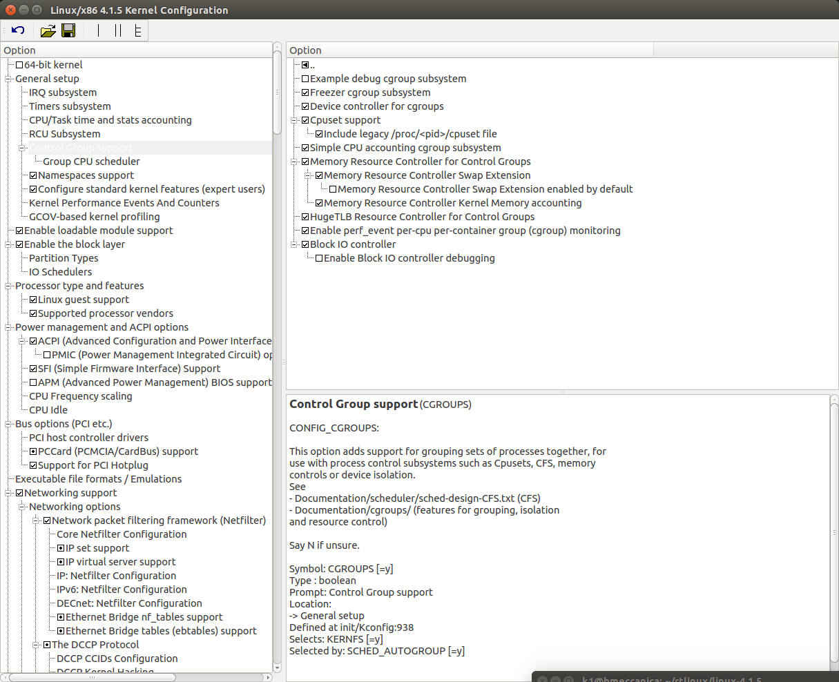

25 Nov 2016 12:23 #83266
by bkt
At these time try a new installation ubu14.04 kernel 4.1.5 as PCW old post I'm over xconfig .... I select now 64bit (but in xconfig this these time is automatic selected) and fully preemptable kernel...
my processor is Intel® Core™ i3-4160 CPU @ 3.60GHz × 4... so I select generic x86_64
and some other choice??
timer frequency 1000Hz??
other specific option (I deselect all amd support option I've all cpu intel on my board) must select??
regards
giorgio
Replied by bkt on topic 7i77 5i25 hm2_pci unloaded
regards
giorgio
