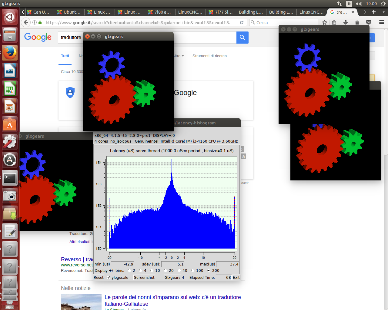

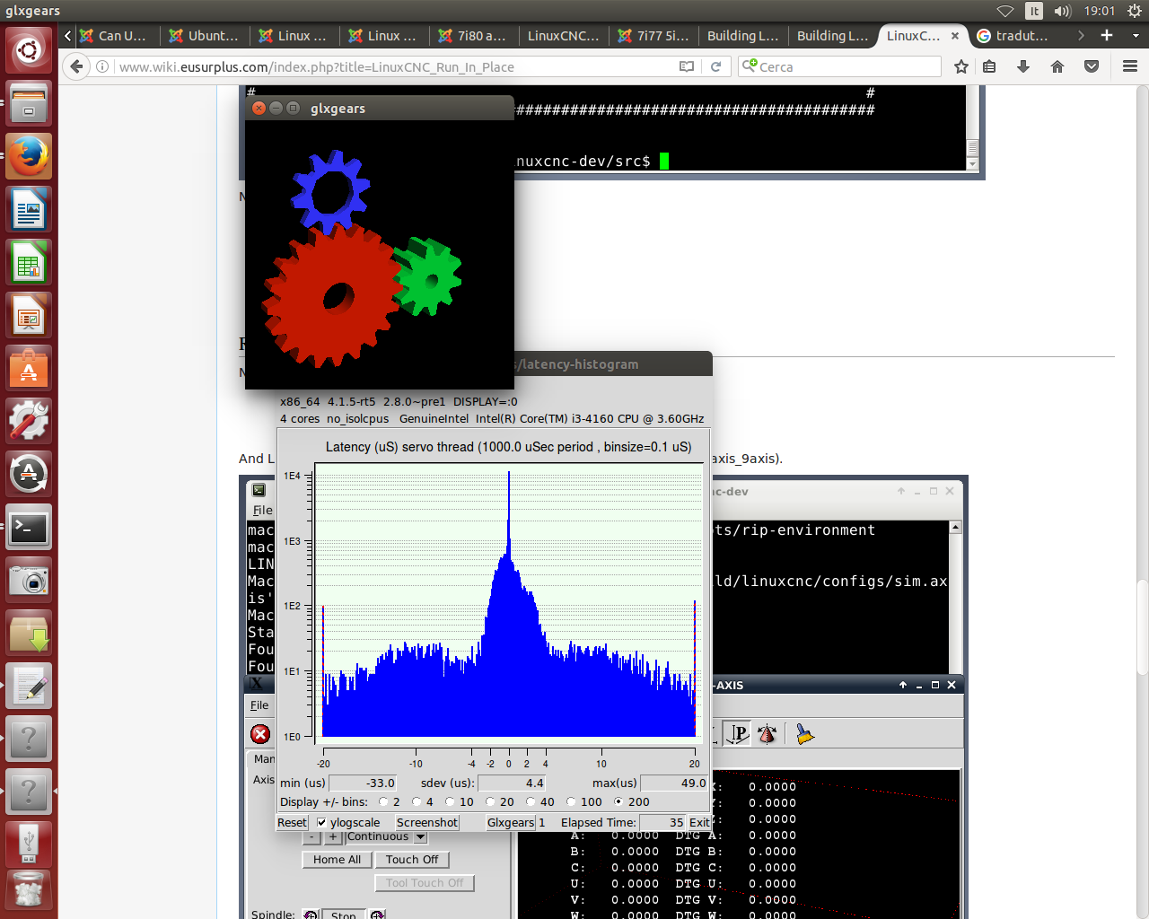

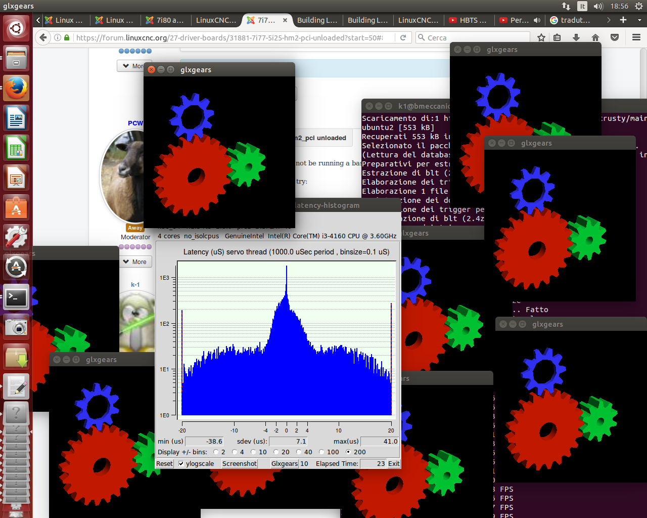

25 Nov 2016 18:11 #83302
by bkt
& motor contro session ...
I don't now ... is the config that have 1 year .... I use custom comp for modbus comunication and alui... some remapped... but in hal file not see base-thread trace....
in attachment latency test nobase whit:
1- 10 glxgear and youtube 2 video run
2- same but only 4 glxgear
3- no ethernet connections and 1 glxgears
I hope was a positive value ...
Regards giorgio

25 Nov 2016 18:22 #83303
Replied by PCW on topic 7i77 5i25 hm2_pci unloaded
That amount of latency should be fine
The following user(s) said Thank You: bkt
