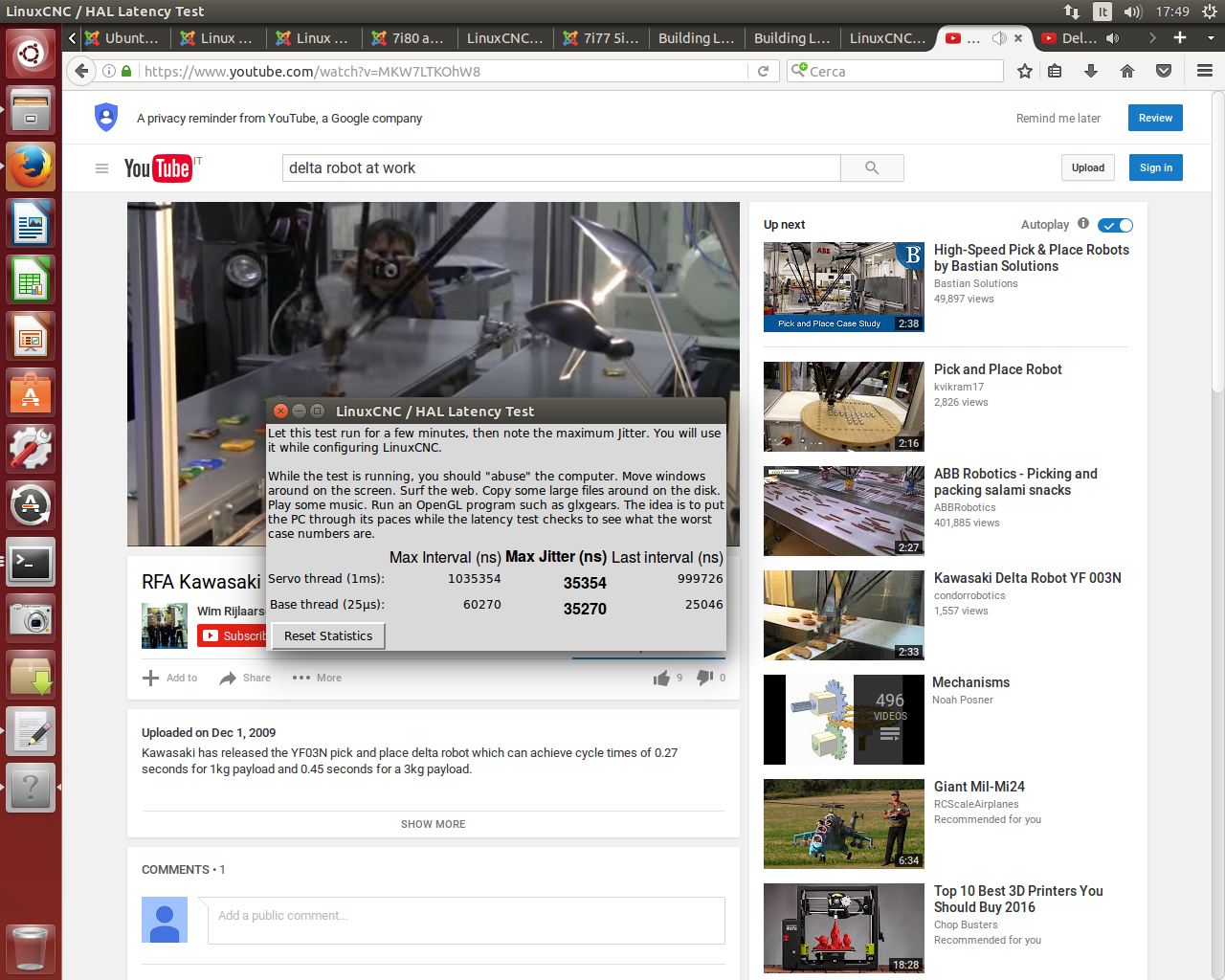

25 Nov 2016 17:13 - 25 Nov 2016 17:14 #83292
by bkt
Replied by bkt on topic 7i77 5i25 hm2_pci unloaded
oh-oh ..... I gave these message ...
when start Latency Test ............
Is Really a problem?? How to solve these??
Regards
Giorgio
Unexpected realtime delay on task 0 with period 25000
This Message will only display once per session.
Run the Latency Test and resolve before continuing.
Note: Using POSIX realtimewhen start Latency Test ............
Regards
Giorgio
Last edit: 25 Nov 2016 17:14 by bkt.
