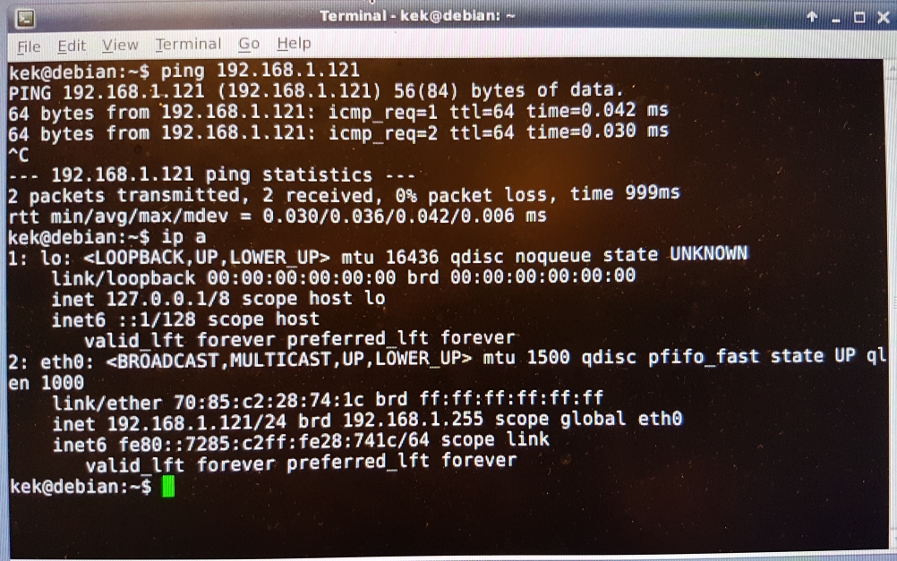

I can ping the board but cant connect. pics attached.

Can you post the result of the command
ip a
ip a

You host address is incorrect, it cannot match the 7I76Es address
(you are not pinging the 7I76E, you are pinging the host)
A suggested host address is 192.168.1.1 if the 7I76E is set for 192.168.1.121 or 10.10.10.1 if the 7I76E is set for 10.10.10.10
