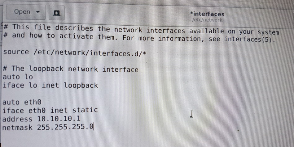

21 Jun 2018 03:34 #112690
by Omnis
Ok I have this installed and edited the interfaces file without errors.
does this look right?
Replied by Omnis on topic 7i76e No 7i76e Board found
If you are starting from scratch, I would use the stretch test ISO:
www.linuxcnc.org/testing-stretch-rtpreem...uspace-amd64-r10.iso

21 Jun 2018 03:46 #112693
by ozzyrob
Replied by ozzyrob on topic 7i76e No 7i76e Board found
If eth0 is the name of the interface you want to use.
The only reason I say that is unless you have made changes to the way the kernel names the network interfaces generally ethX (ie eth0) is not used.
Lists your interface names, if eth0 is listed all good, if not eth0 will not work in the above.

21 Jun 2018 04:07 #112696
by Omnis
some how I feel more lost and confused than before. so far I redid everything from scratch with linuxcnc-stretch-uspace-amd64-r10.iso suggested by PCW. Tried to make sense of hm2_eth manual linuxcnc.org/docs/html/man/man9/hm2_eth.9.html ?right link? and modified the interfaces file with a combination or advice about ip10.10.10.10 and got stopped at adding linuxcnc keyring with an error in previous post at this point I feel like I'm way off the correct path of a known working build, configuration, installation.

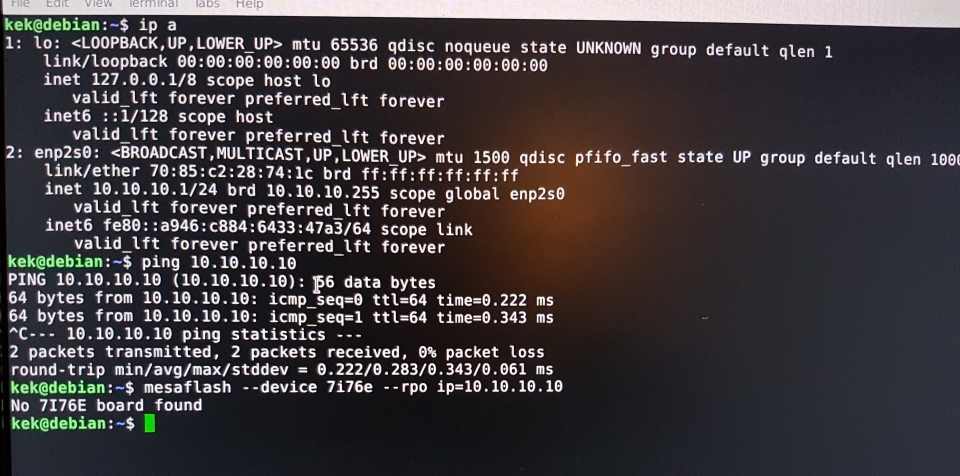

21 Jun 2018 04:56 #112698
by Omnis

21 Jun 2018 06:44 - 21 Jun 2018 06:49 #112700
by ozzyrob
But the interface is not called eth0, the interface is called enp2s0, that is the name you have to use.
auto enp2s0
iface enp2s0 inet static
address 10.10.10.1
netmask 255.255.255.0
If your mesa board is 192.168.1.121, your address must be 192.168.1.xxx
If your mesa board is 10.10.10.10, your address must be 10.10.10.xxx
When you change the /etc/network/interfaces file please reboot for the changes to take affect. Make sure too that there is NO HUB between the mesa card and your NIC. Just one cable. I use a patch cable, no need to dig out a crossover cable.
Once the networking side is good we can go further on.
If you do not have an interface named eth0 do not use that name in the interfaces file.
The mesaflash command looks odd, try this as mentioned before.
auto enp2s0
address 10.10.10.1
sudo mesaflash --device 7i76e --addr xxx.xxx.xxx.xxx --readhmi

21 Jun 2018 07:55 - 21 Jun 2018 08:05 #112706
by Omnis
Your so awesome man that was it.
