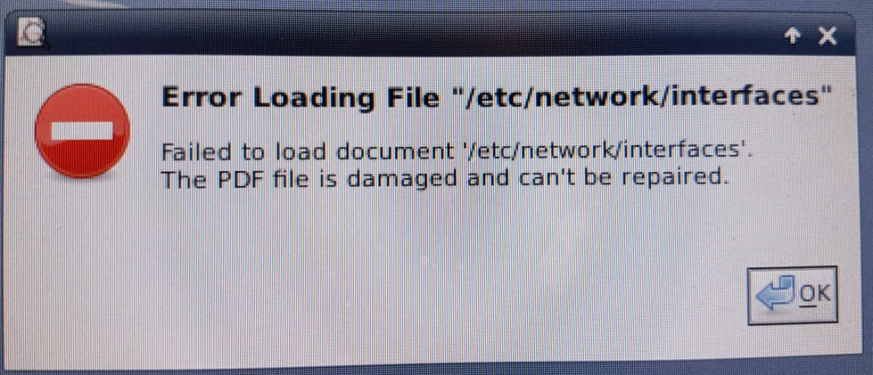

20 Jun 2018 18:40 - 20 Jun 2018 18:42 #112652
by Omnis
Replied by Omnis on topic 7i76e No 7i76e Board found
Did a long file search to find interface and it was intermittently where it was suppose be. I right clicked it and it gave me this error. could any one link me how to configure linuxcnc with uspace so I can install it correctly? EDIT: ty PCW

20 Jun 2018 21:47 #112663
Replied by tommylight on topic 7i76e No 7i76e Board found
To late but,
there are several errors made during setup and use as pointed above by PCW.
Your computer ( host ) address needs to be different form the 7i76E address, namely the last 3 digits ( 1 to 254 ), but avoid using 1 as it is used by routers, 10 in case you set the 7i76E to use the 10.10.10.10 address, and 121 in case you set the 7i76E to use the 192.168.1.121 .
You can not use the "document viewer" to edit ".conf" files or in your case the "interfaces" file as they are not documents, they are plain text files so any text editor can open and edit them.
The user manuals for the Mesa boards are extremely detailed so have a read through the parts that deal with operation and installation instructions, everything is there in detail.
I had to jump in as it is painfully obvious that you assume way to much on how things should work and they do not work as you assume., as stated by you about the other 2 cards.
Please do ask here about everything , we are here to help.
Regards.
