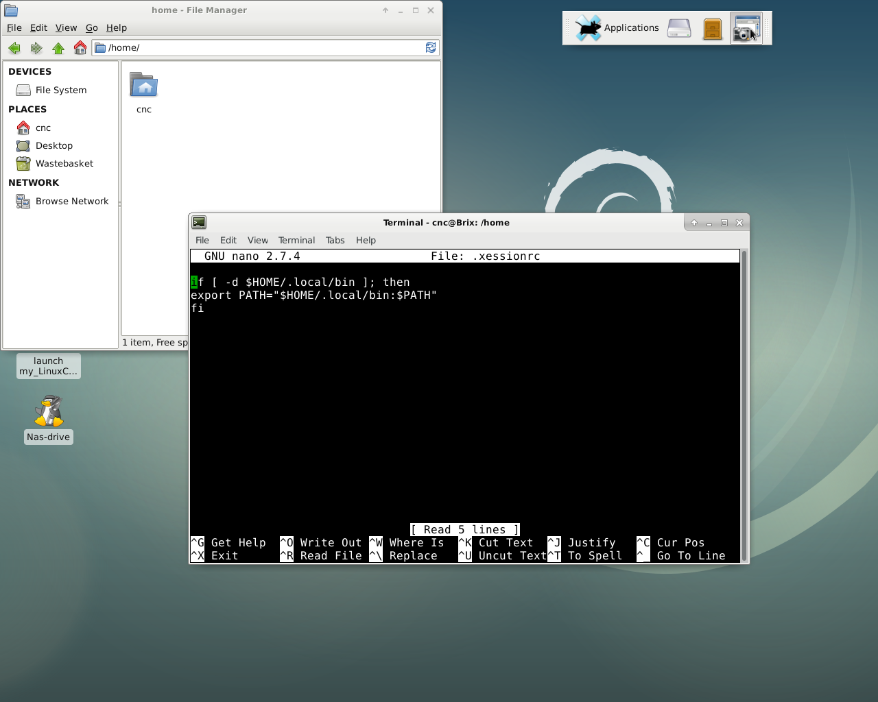

20 Aug 2019 04:52 - 20 Aug 2019 08:42 #142569 by Clive S
Replied by Clive S on topic 7i96 Configuration Tool
Thanks for the config tool that I am trying for the first time But I am stuck here:-
3. Create a file in your home directory called .xsessionrc and add the following if your using Debian 9 then log out and back in or reboot the PC.
if [ -d $HOME/.local/bin ]; then
export PATH="$HOME/.local/bin:$PATH"
fi
Would you mind explaining how I do this?
Ie do I make a folder/directory or !!

20 Aug 2019 09:03 - 20 Aug 2019 09:10 #142595 by persei8
Replied by persei8 on topic 7i96 Configuration Tool
Make sure you are in your home directory
cd
Check if you have a file called .xsessionrc (make sure to include the dot)
ls -als .xsessionrc
If not, then
sudo nano .xsessionrc
Then add the contents
fi
Then ctrl x, yes to save
Logout, login, good to go.
Last edit: 20 Aug 2019 09:10 by persei8. Reason: change ls -l to ls -als
20 Aug 2019 10:10 #142609 by Clive S
I have tried but failed. I move to the home dir that showed just the dir cnc and followed the instructions.
is this correct;-
The terminal was opened from the home dir. I logged out and back in. Then tried to run the config tool with 7i96 in a terminal is this correct.

20 Aug 2019 10:18 #142611 by BigJohnT
Replied by BigJohnT on topic 7i96 Configuration Tool
To see a hidden file (one that starts with a dot) you have to select show hidden files in the file manager.
