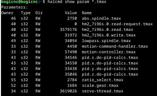

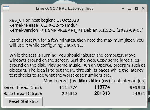

12 Oct 2023 23:09 #282842 by PCW
Replied by PCW on topic Mesa 7i96 Installing to Run
That all looks pretty decent other than the latency test, but that
would probably be better if run without the base thread.
Do you get a red light on the 7I96S when you get the "error finishing read" ?
Can you post the results of:
halcmd show param *.tmax
when LinuxCNC is running
(and also your CPU clock frequency as the tmax times are in CPU clocks on x86 hosts)

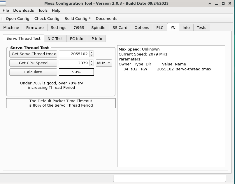

12 Oct 2023 23:16 #282845 by Boogie
Replied by Boogie on topic Mesa 7i96 Installing to Run
I've managed to install python3-packages and then mesaCT:
Yes, when i'm getting this error CR6 LED is turning red.
halcmd output:

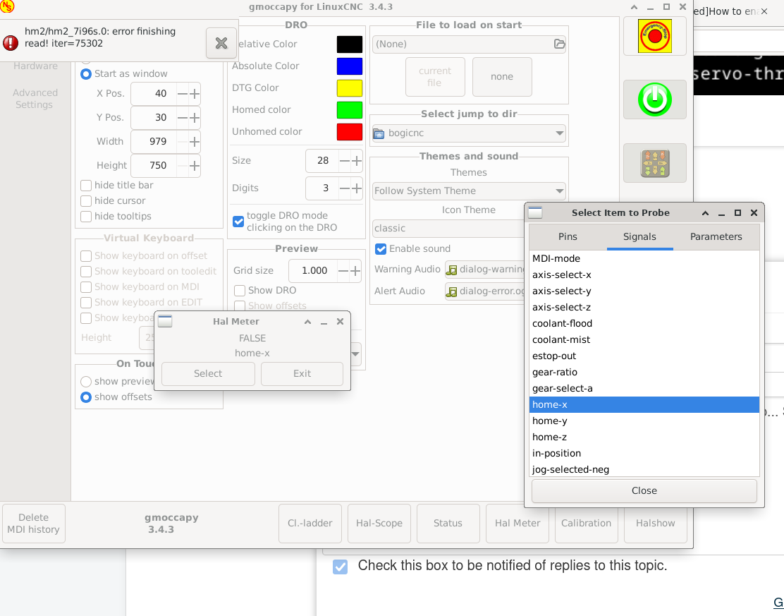

12 Oct 2023 23:21 - 12 Oct 2023 23:21 #282847 by Boogie
I even changed servo thread period from 1ms to 2ms to see if it will help... Started Linuxcnc and now it took longer (more than one minute) to get en error, but it is still there:(

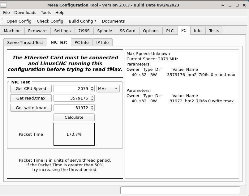

12 Oct 2023 23:28 #282848 by PCW
Yeah, so it sounds like a issue either with the MAC driver or the OS version.
I know there have been issues with the Realtek MACs but I am not sure what
the current fix is. It may be that updating the kernel to the latest will help
(ISTR that most Ethernet RT issues with older kernels that stated with the 5.x kernels
got fixed sometime around 6.3 )
