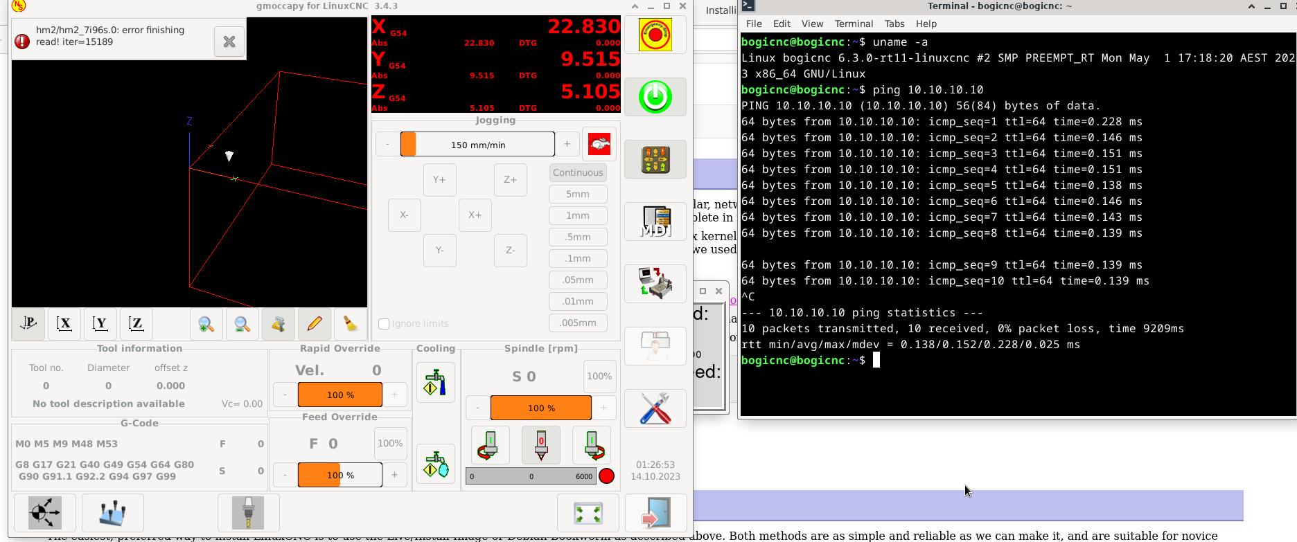

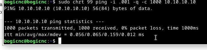

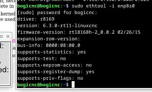

Update: the tests i've done today:
- isolated CPUs in grb-customizer (quiet isolcpus=2,3)
- checked NIC
- checked NIC driver i have: RTL8169
- installed different driver: RTL8168
- checked ping times after driver change - worsen literally 10 times! 1.6ms
- purged RTL8168 and went back to RTL78169
- checked ping times 0.14ms
- Mesa problem is still there

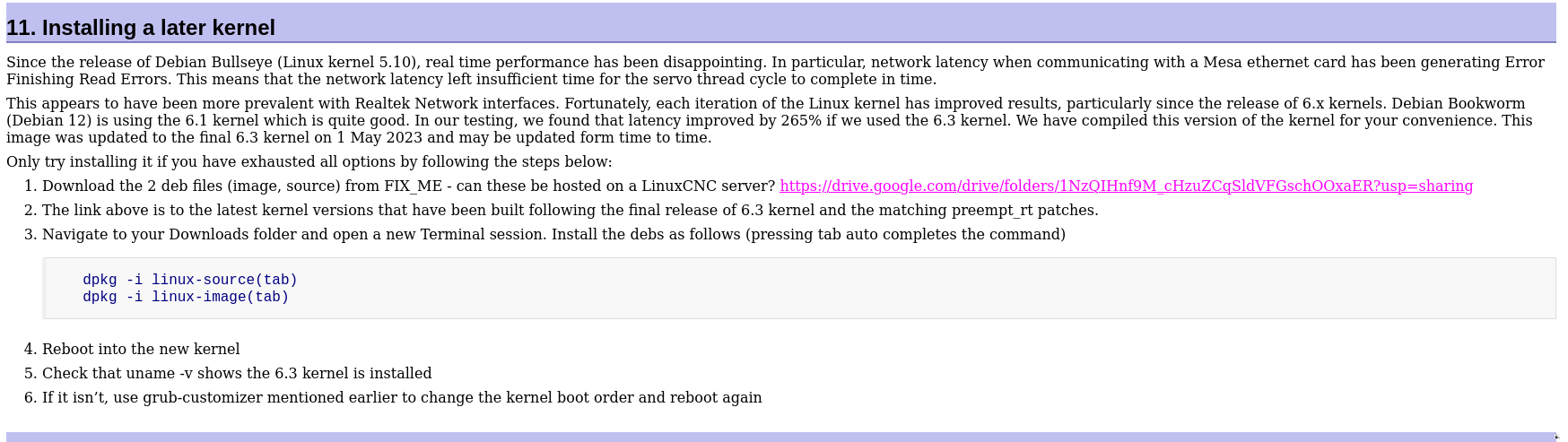

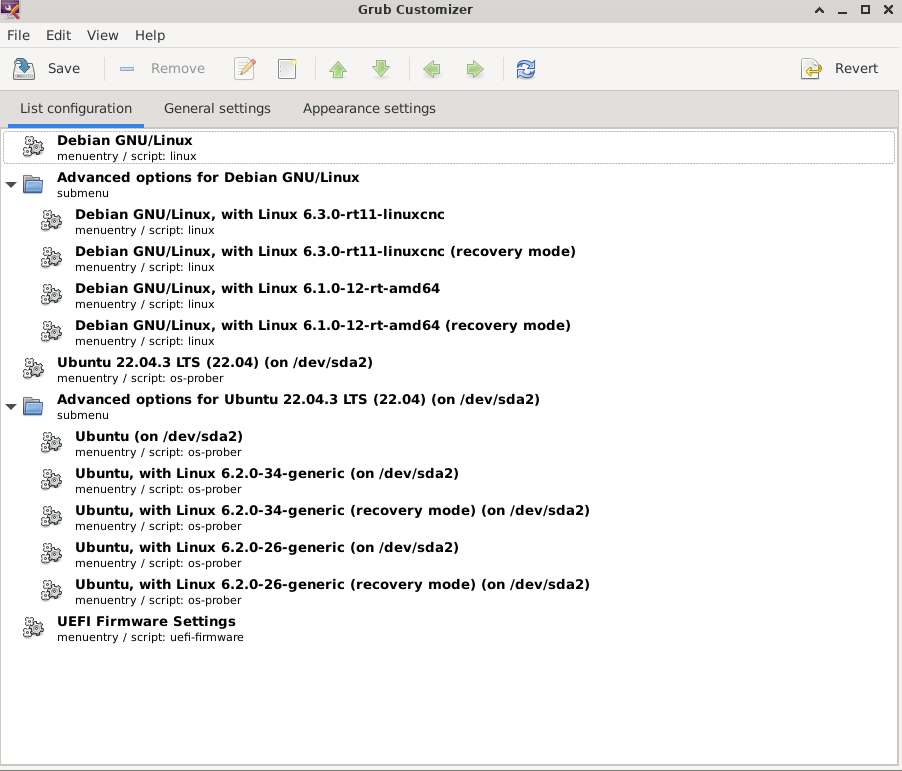

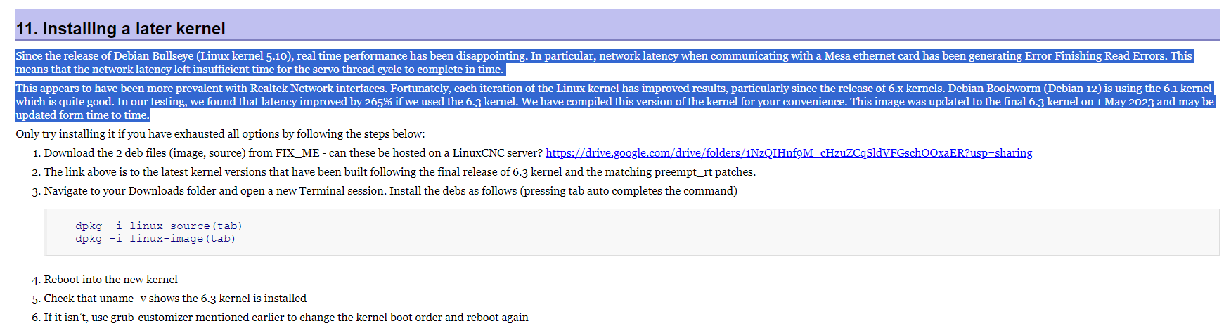

- installed kernel 6.3 as per here:
- checked things
- problem still there
...even on servo thread period 2ms:/
Then, i don't know what i did, i thought i only changed period to 5ms i got this when loading linuxcnc:
and red LED came on immediately when linuxcnc started but i got no reading error and i could move the tool on the screen (using arrows). However XYZ position feedback numbers were jerky. In addition i can see 4 green LEDs blinking as the packets are transmitted/received.
So i've changed servo thread period back to 2ms. And restored previous situation so no red LED at the beginning, no jerky numbers however error finishing read is still there.
I give up.
