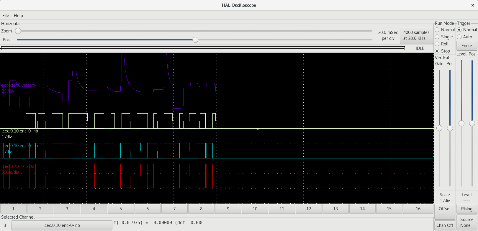

so I am using the EL5152 ethercat card reading a quadrature encoder output. The lcec pins are then connected to the hal encoder pins. For my application I need to achieve both high and low velocity. I already figured out that at high speed my pulse rate was way too big for the thread period I had so I have been ordering new encoders with lower pulse rate. Lowering my faster non floating point thread period would end up being close to the max period jitter of the computer hardware so I already now that my hardware is not recommended for pulse generation nor encoder pulse reading. To me lower pulse rate encoders is the main option to tackle my velocity reading issue.
However I was expecting to still get relevant readings at really low speed of my encoder. However the velocity that the hal encoder component computes seems weird as at low speed it is oscillating, Jumping from negative to positive.
So I put my halscope to monitor the lcec pins and the encoder resulting velocity. You can find a screenshot attached with the log file.
In red, I measure the voltage going on to my EL5152 A channel (lcec.0.10.enc-0-ina in cyan) with a El3102 analog input.They both match. Then I got the channel A and channel B readings with the lcec.0.10.enc-0-ina and lcec.0.10.enc-0-inb (white). For some reasons those signals are not exactly an time shifted from one another. When I recorded this phase the rotation was steady. Am getting packet loss effect on the ethercat to get such a difference?
Then on the top is the resulting velocity of the encoder hal component having connected lcec.0.10enc-0-ina to encoder.0.phase-A and lcec.0.10enc-0-ina to encoder.0.phase-B. I guess the reason why this signal is jumping all around is because A and B signal are not an time shift of one another.
I already tried to create a fast thread with floating point to load the lcec read and write with it:
addf lcec.read-all fast-thread-fp
addf lcec.write-all fast-thread-fp
I also lowered the period value in the ethercat config xml file to match this period at 50000ns.
Doing so had some knock on effects such as unexpected behaviour of the ethercat bus output or the logic. Maybe it is too fast at this stage so I will probably have to work out a trade off.
Nicolas

- Posts: 18103
- Thank you received: 5326
11 Sep 2019 23:06 - 11 Sep 2019 23:06 #144841
Replied by PCW on topic Ethercat EL5152 encoder reading
I would not expect that software encoder counter to be of much use
with Ethercat unless you are using a very low resolution encoder
If the Ethercat encoder hardware does not provide a velocity signal
(and I would almost expect that it does) the best bet would be to use a
high resolution encoder and then calculate the velocity in LinuxCNC with the
DDT component.

Hi Nicolas,
I don't know if it is very helpful, I usually do this configuration:
appTimePeriod = "1000000" = SERVO_PERIOD = 1000000
refClockSyncCycles = "- 1" by applying Patch PLL (times when the hook cycle is restarted)
refClockSyncCycles = "1000" without patch
To sync devices with DC
<dcConf assignActivate = "730" sync0Cycle = "250000" sync0Shift = "50000" sync1Cycle = "750000" sync1Shift = "500000" />
