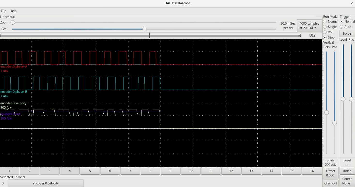

Hi all,
I got my encoder with a lower pulse rate (100 pulse per rev). I no longer loose steps at my top revolution speed.
However this is what I obtain in the picture attached. You can see the channel A and B signals for a constant revolution speed of the encoder shaft at the top. At the bottom you can see the encoder component velocity output signal and the output of the same signal going through a low pass filter.
I would like to know if I can get ride of those oscillation in the encoder velocity signal and if so which parameter I should play with.
I have already tried to adjust the different thread, without much better results:
I havein my ini file in the EMCMOT section thenIn my hal file loading the threads and components.
My A and B channel comes from an EtherCAT card EL5152 without distributed clock defined in the ethercat xml file where appTimePeriod="1000000". I am not sure if it is the issue or if it is an expected behaviour from the encoder component which gives me those oscillations.
Thanks you for your help,
Nicolas

Replied by PCW on topic Ethercat EL5152 encoder reading
Why are you not using EL5152s built in encoder counters?
forwarding the raw A, B input pins to a software encoder counter seems somewhat crazy
if you used the built in hardware counter in the EL5152 you would:
1. Count up to 400 KHz
2. Work with a 1 ms servo thread, no base thread required

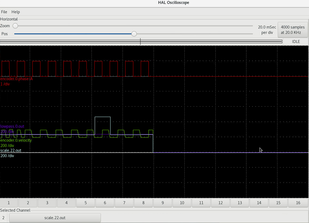

Hi all,
I tried to get something out of lcec.0.10.enc-0-raw-period. The signal seems to possibly do the job but is suffering time to time from a big change of the value. Attached is a halscope screenshot where scale.22.out is the lcec.0.10.enc-0-raw-period inverted then scaled to get a relevant speed reading in mm/s. As we can see, there is time to time a big increase of the value which looks close to twice the average speed value. Which means that time to time the lcec.0.10.enc-0-raw-period is divided by 2.
To get rid of this transient but repeated change in the raw period, I wonder if I am using the EL5152 in the good mode as at this stage I am not using the Distributed Clock EtherCAT feature. I got the basic idea behind this concept but I am not familiar enough about how to implement it on the linuxcnc etherCAT.
What mode would be recommended to get the most accurate information from the EL5152? I am happy to do CoE modifications with TwinCAT to try to improve the reading of the lcec.0.10.enc-0-raw-period.
At the moment the scale.22.out compares nicely with the encoder.0.velocity (based on channel A and B inputs) then filter by lowpass.0 but there is still a difference. This is a bit critical for my application as I want a precise feedback for the velocity. At this stage I am not sure which methods gives the most accurate velocity feedback: either the scaled invert of the raw period or the encoder component velocity put in a lowpass filter.
Thank you for your help
Nicolas
