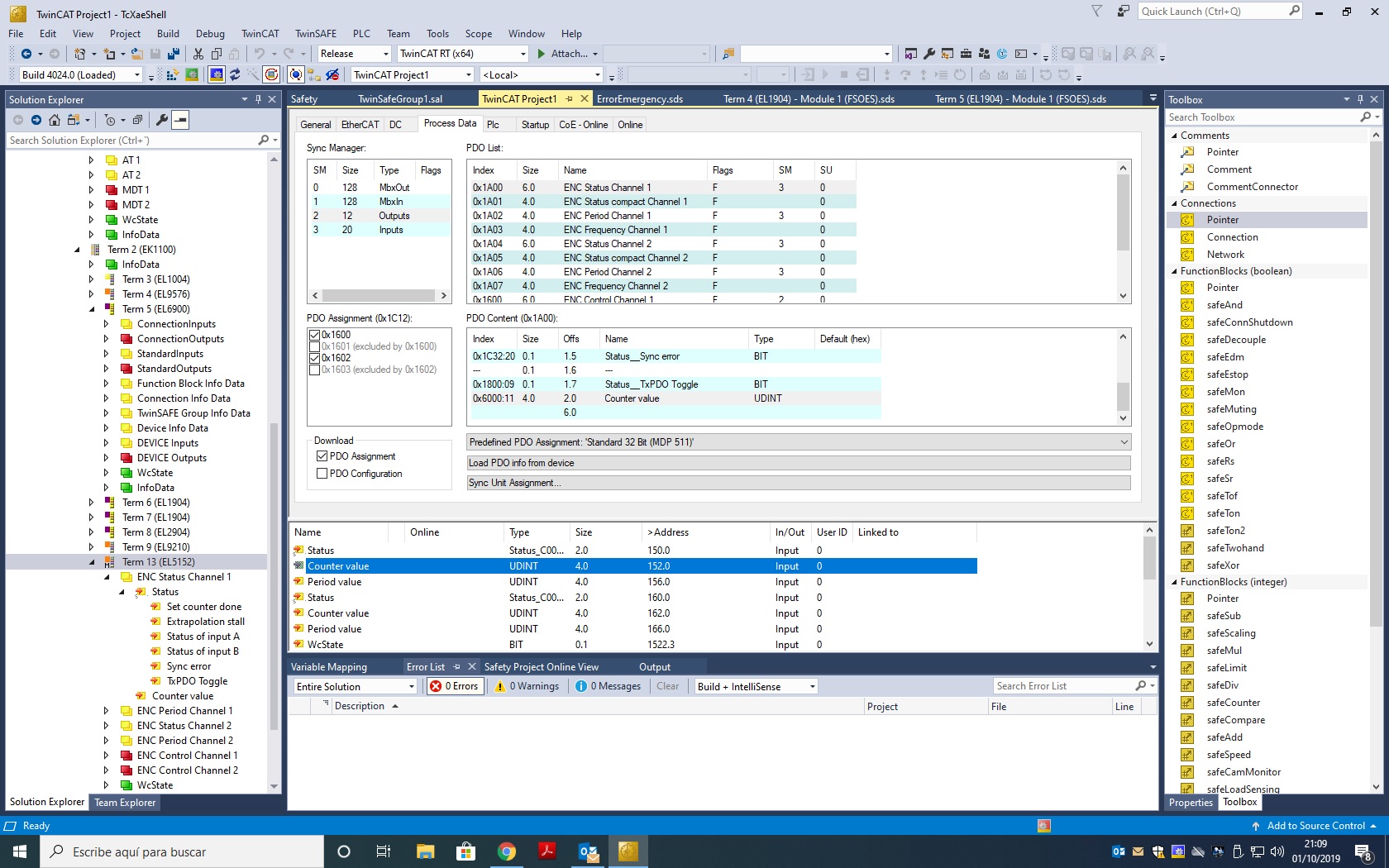

I have been testing the EL5152 under two configurations.
  • under the TwinCAT software, so under Windows. Unfortunately my Ethernet card hardware does not allow realtime performance. If I go in TWINCAT -> Show realtime Ethernet compatible devices, my Ethernet card is in
    Installed and ready to use devices (for demo use only)
    so it is not in the realtime capable section. As far as I have been using it, I was able to run the EL5152 without noticing loose of steps, so the EL5152 itself and if runned under TWINCAT seems to be fine.
  • under my linuxcnc application, under debian, with a different hardware. When I have been programming my files, I noticed that I could not go lower than

I am not too concerned about the first configuration under TwinCAT that I am just using to get more familiar with EtherCAT and to run Wireshark at the same time to observe the EtherCAT frames.

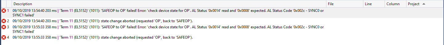

I went over your post again and tried to make more sense of it. When I try the DC mode the parser fails for the line :
<initCmds filename = "EL5152.xml" />
sending me back
lcec_conf: ERROR: unable to open config file EL5152.xml
lcec_conf: ERROR: Parse error at line 15: parsing aborted
So I got ride of this line, then it loads but the terminal is not sending information: leds on top of the terminal are blinking when the encoder spins but I have the lcec.0.10.slave-oper at false and none of the lcec.0.10 pins are responding. So I guess the initialization did not succeed.
Where would I be able to find or generate myself the EL5152.xml file?
Edit: Ok I gave it a try finding some example in the linuxcnc-ethercat for the initCmds, writing something like for my <initCmds filename = "EL5152Param.xml" /> file:
Warning: Spoiler!
The program launch but I still get the EL5152 not going into OP mode and getting stuck into SAFEOP. Doing it under TWINCAT gives me the same error when I use the DC mode (see error bellow).
Nicolas

09 Oct 2019 17:52 - 09 Oct 2019 18:44 #147581 by chimeno
Replied by chimeno on topic Ethercat EL5152 encoder reading
Hi Nico,
Thank you very much for the explanation, I see that you know much more than me, I will help you in whatever I can, I pass you a configuration file so you can try it if you can load it and put the EL5152 in OP mode, the files are made in windows, You may have to pass it for Linux to recognize it.
I attach the lam-ethercat-v1.xml file with the Ethercat devices
I enclose the EL5152Param.xml file with a value for each channel, if accepted.
Is there any way to determine what can be used for appTimePeriod at best?
  - I understand that "appTimePeriod = SERVO_PERIOD"
Is the EtherCAT bus topology that I am using the one that contains other components: EL 1008, EL2008, EL3102, EL4102, EL4004 and EL5152. I created the necessary files for EL4004. Perhaps the other components have a limitation in the period that I could not identify in any of their documents
- I had problems with other ethercat devices that were on the same bus due to problems of PDO configuration and initial configuration that affected me to the next module, but once everything well configured does not give problems between one device and another
Where could I find or generate the EL5152.xml file?
- The best thing for not having errors is to make them yourself, I pass you a template and you can where you can add any configuration you want to change, the configuration generated by TWINCAT3 is not compatible with LINUXCNC-ETHERCAT and usually gives errors, I what do is testing configuration by configuration, when you have many it is very difficult to know the problem-
DC mode (see error below).
- Error in synchronism is normal, I also found it many times, not having the device is a bit difficult to know how to configure the DC mode, many settings do not work and I guess you would have to modify the file lcec_el5152.c, it may be that PDOs do not correspond in that way.
If the limitation is more related to the second case, then perhaps you should have a fast EtherCAT frame exchange only dedicated to the EL5152 and a slower EtherCAT frame exchange for the other modules, where the fast thread is not critical. So the problem is that I have no idea how to parameterize that in the ethercat.xml file for the linuxcnc-ethercat controller.
- can you prove it if it works, do you have two network cards?
Last edit: 09 Oct 2019 18:44 by chimeno.
