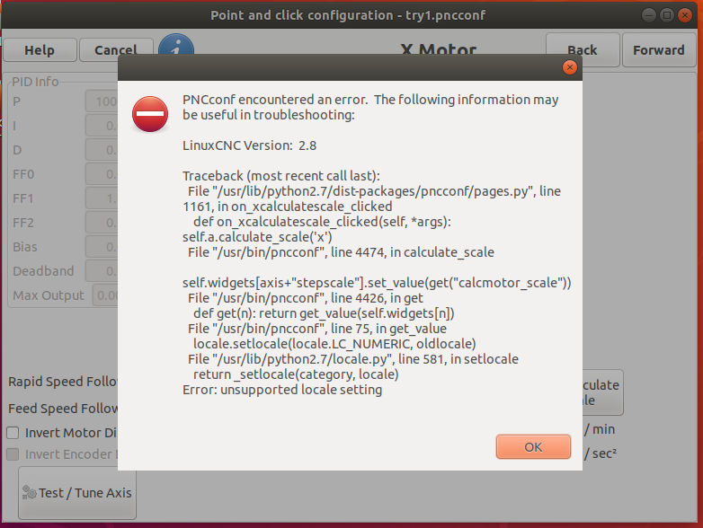

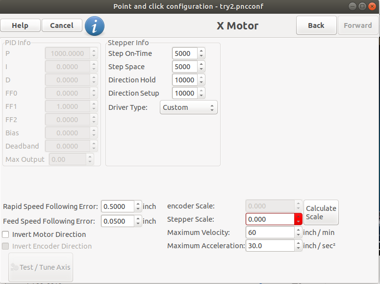

02 Feb 2021 07:25 - 02 Feb 2021 08:02 #197383
by suraj9735
Replied by suraj9735 on topic Getting started with mesa 7i95?
As per your suggestion, I am trying pncconf for xz axis. I have just added two step generation for x and z axis, other things I kept default. I got a error on "x motor page". I am not able to apply the scale and move forward for next step.
I have attached the image of the error. Please help me to troubleshoot this error. Thanks.

- Posts: 21980
- Thank you received: 7480
02 Feb 2021 10:17 #197403
Replied by tommylight on topic Getting started with mesa 7i95?
No need for the upgrade, 7i95 works with 2.8.1.
The error seems to point to something with locale settings due to language settings, so try it without using letters and symbols that are not pressent in UTF8 locale.
- suraj9735
- Posts: 83
02 Feb 2021 11:04 #197406
by suraj9735
I changed my locale settings using terminal command "$ sudo localectl set-locale LC_TIME=en_US.UTF-8". And it works for me.

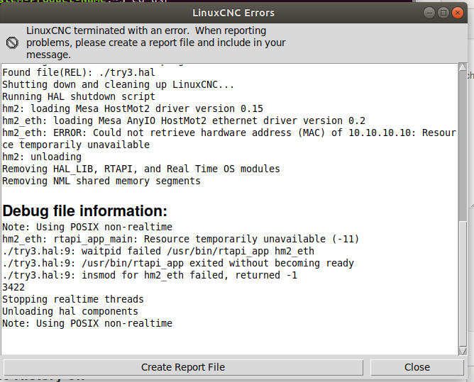

- suraj9735
- Posts: 83
02 Feb 2021 11:25 - 02 Feb 2021 11:29 #197407
by suraj9735
As per your suggestion, I did everything. used pncconf, 7i96 card, generated file and launcher, edited two file (try3.hal and try3.ini) and replaced 7i96 to 7i95 everywhere. i did all without connecting the mesa 7i95 card to the pc, I planned to connect it after launching the wizard ( I'm not sure the error is related with this ). I was ready and very happy to launch the configured file, but unfortunately got a error again. and i am not able to launch my configured file. Please help.
I have attached my error and configured file.
