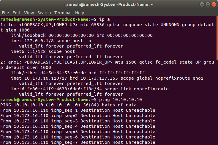

In a terminal
ip a
ping 10.10.10.10
ip a
ping 10.10.10.10

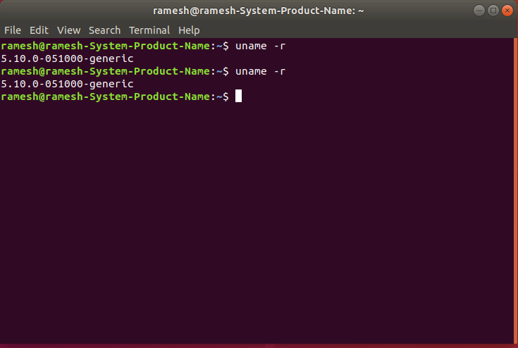

I updated my kernal version to 5.10.0, but still getting the same error. Please look into it. Thanks

LinuxCNC needs/requires real time kernel to run machines.
More info about everything, what Linux, what LinuxCNC, how are things wired/connected, etc.
Replied by tommylight on topic Getting started with mesa 7i95?
Why would you do that?I updated my kernal version to 5.10.0, but still getting the same error. Please look into it. Thanks

Replied by PCW on topic Getting started with mesa 7i95?
My guess is that you have the host IP address set to 10.10.10.10,
so you can ping 10.10.10.10 but you are pinging your host, not the 7I95
The host address needs to be set to a different address on the same subnet
say 10.10.10.100. (and reinstall the linuxCNC image with the real time kernel)
This is why tommylight suggested running and reporting the results of the
ip a
command, as this will show how your host network is setup

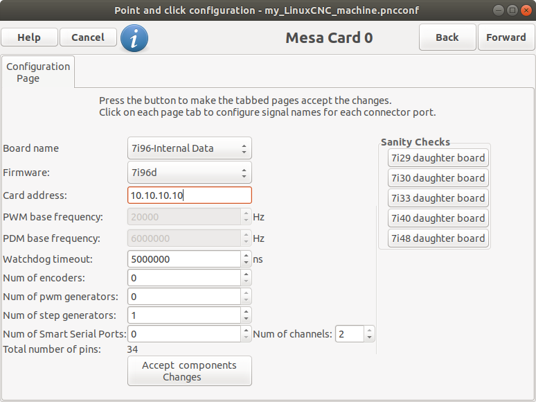

I have attached my pinned result, it says "destination host unreachable". During Pncconf I set 10.10.10.10 (I am still figuring out your suggestion for using 10.10.10.100, should I replace my card address setting 10.10.10.10 to 10.10.10.100 during mesa card card0 setting ???, i have used jumper position like W16 (down), W17 (up) ). Please forgive my stupidity, as I am very new to linuxcnc and linux too.
Ok you do not have a static IP address setup on your host PC
Suggested ip address is 10.10.10.100.
You can set this up with the network manager GUI or by
editing the interfaces file as suggested in the hm2_eth
manual page:
man hm2_eth
