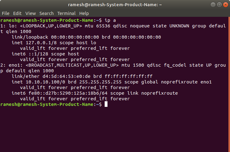

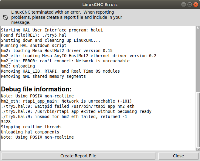

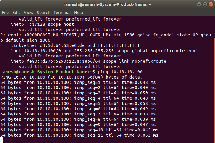

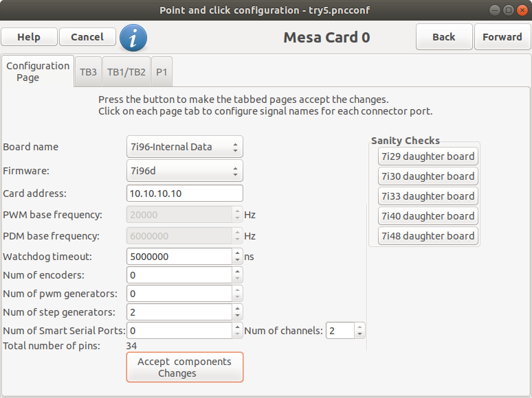

I did as per your suggestion and set 10.10.10.100 in Network Manger GUI. And it works for couple of days. Today I edited the same file from xz lathe to xyz mill pncconf and it's giving the same error similar to previous one.
I am able to ping 10.10.10.100 and getting response from the card in terminal. but not able to launch.
I am attaching all the screenshots of my setting, How to troubleshoot this Ethernet error?
Replied by suraj9735 on topic Getting started with mesa 7i95?
Ok you do not have a static IP address setup on your host PC
Suggested ip address is 10.10.10.100.
You can set this up with the network manager GUI or by
editing the interfaces file as suggested in the hm2_eth
manual page:
man hm2_eth

- Posts: 21980
- Thank you received: 7480
10 Feb 2021 12:37 #198270
Replied by tommylight on topic Getting started with mesa 7i95?
You should ping the Mesa card, not the PC
ping 10.10.10.10
not 10.10.10.100 <this is your PC
ping 10.10.10.10
The following user(s) said Thank You: suraj9735
- suraj9735
- Posts: 83
10 Feb 2021 13:39 #198274
by suraj9735

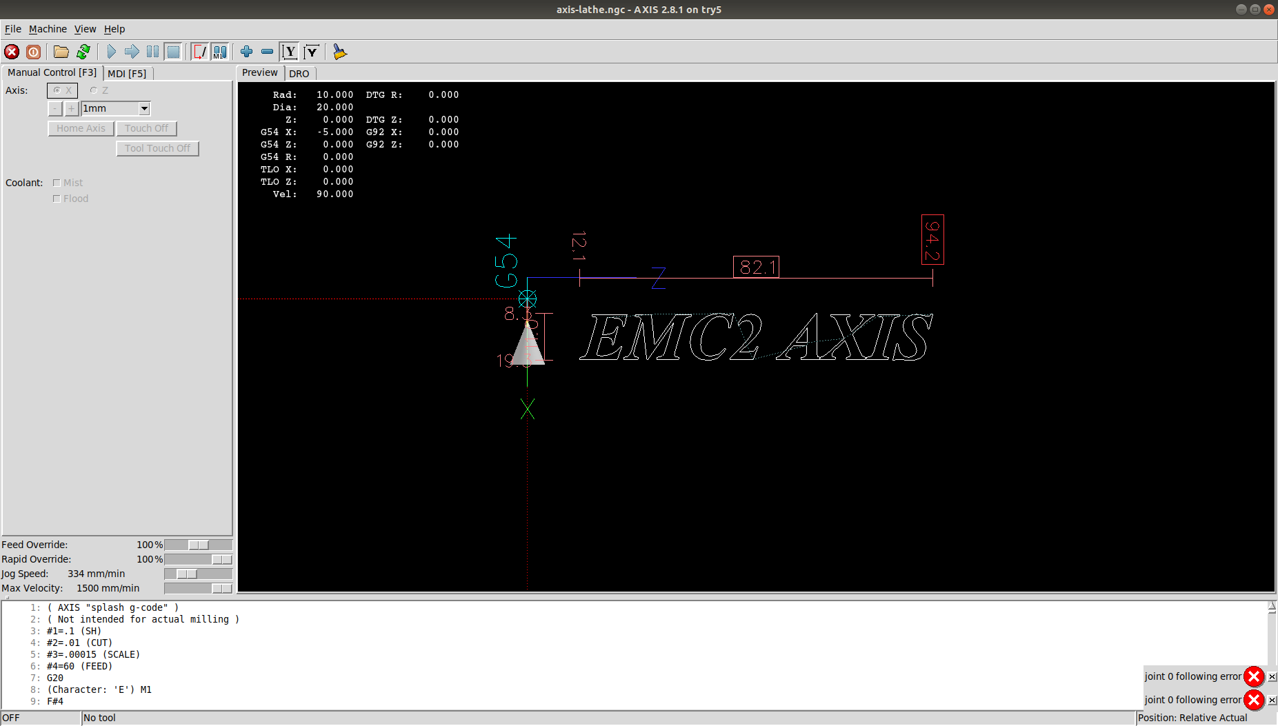

Thanks tommy, for pc in network manager i set 10.10.10.2 and in terminal ping 10.10.10.10 and it worked for me.
got new error in axis gui when I click +x button "joint 0 folowwing error".
ping 10.10.10.10

10 Feb 2021 18:30 #198310
by chris@cnc
Replied by chris@cnc on topic Getting started with mesa 7i95?
Do you home your axis first?
If yes try to reduce increments. 1mm steps quite hard or try continue jog.

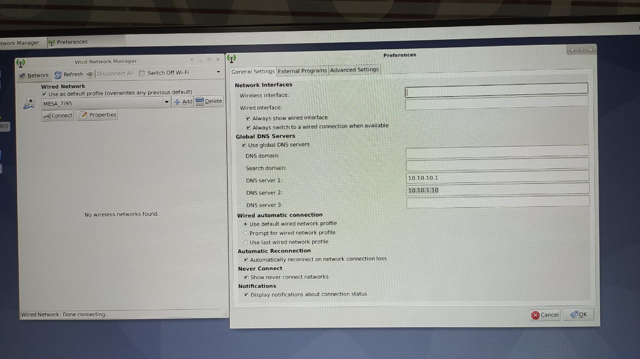

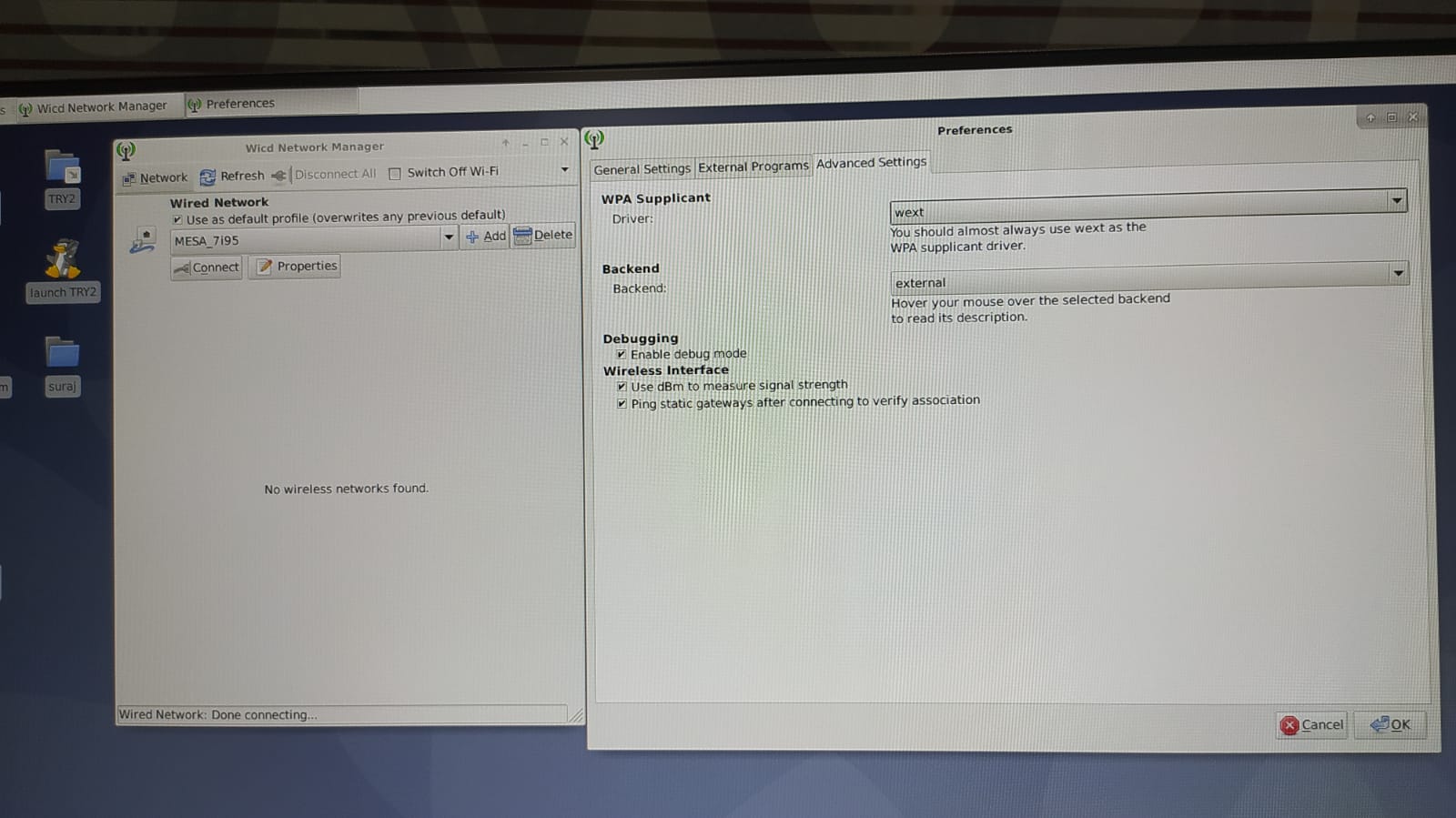

07 Apr 2022 07:08 #239512
by suraj9735

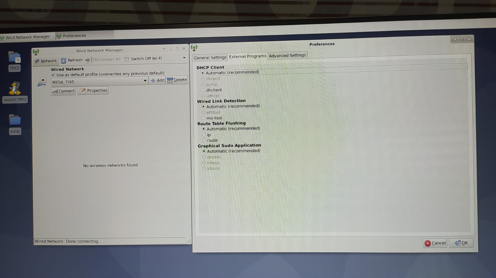

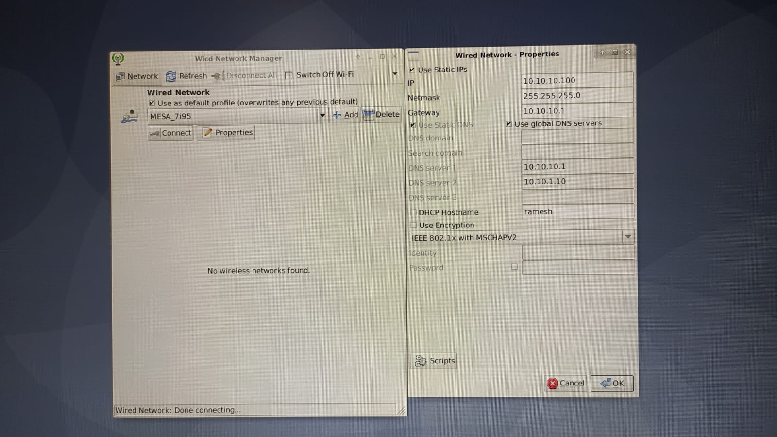

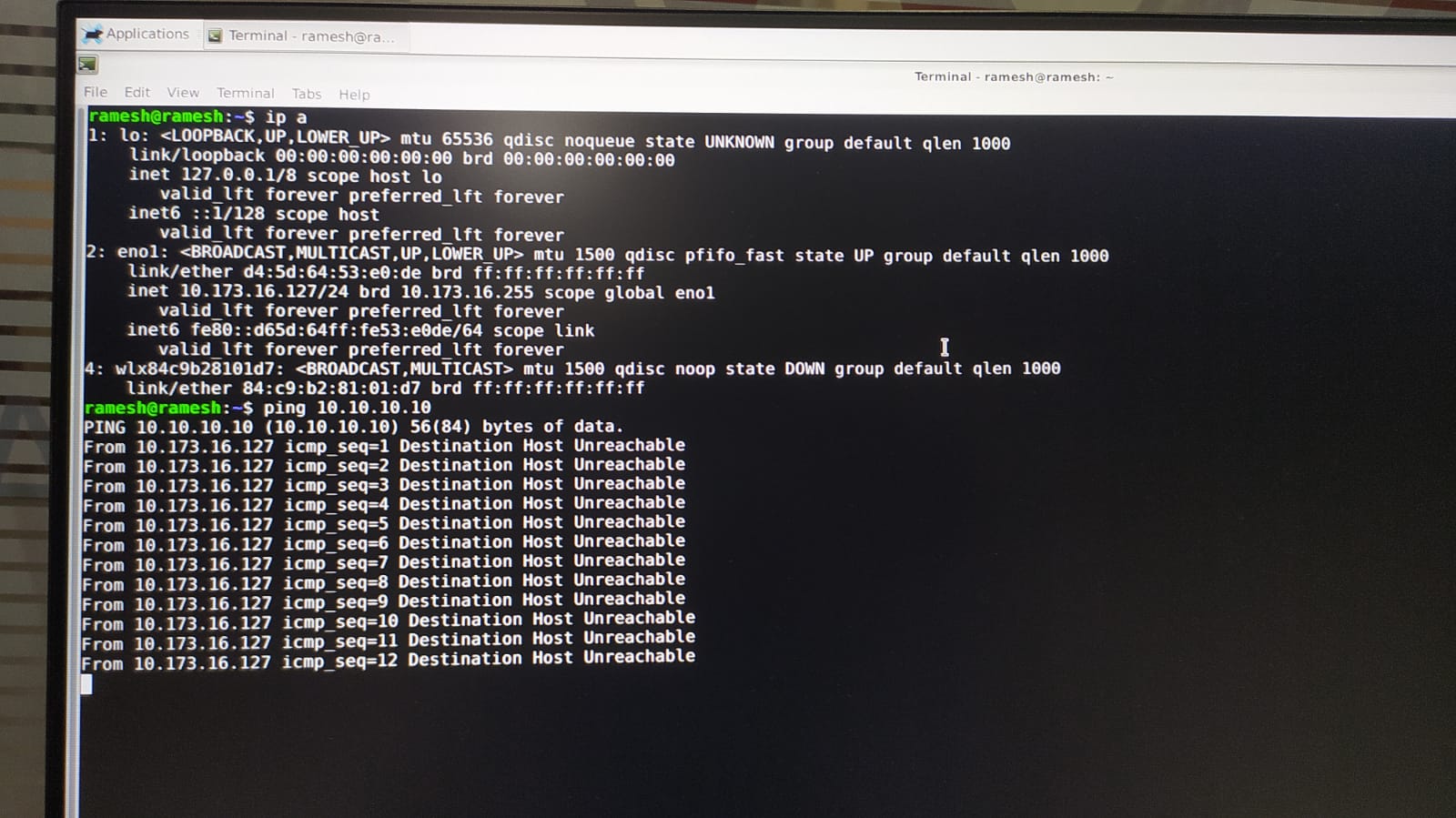

I have lost again with this ip setting for the mesa 7i95 card. could you please look at...
I am not sure about wicd network manager's following settings....
Netmask (255.255.255.0)
Gateway (10.10.10.1)
Clicked on "use global DNS server"
DNS Server 1 (10.10.10.1)
DNS Server 2 (10.10.1.10)
Same vale set for DNS server 1 and 2 in preferences tab of wicd.
Attached all the screenshot including
ip a
ping 10.10.10.10
ip a
ping 10.10.10.10
- suraj9735
- Posts: 83
07 Apr 2022 10:54 #239526
by suraj9735
I am not able to connect the mesa card with computer, please help!
