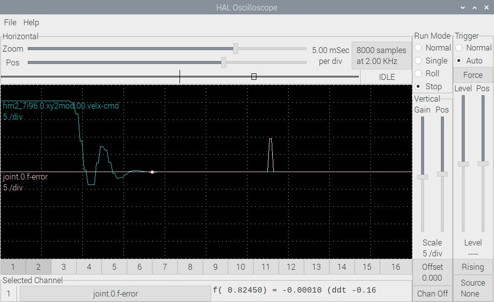

I've been working to get my laser galvo setup running. I have solved my "error finishing read" issue by switching to a different Rpi OS. now I can run a 500,000ns servo thread indefinitely without getting the read error. Success!
I've also hooked it up the hardware and can burn lines. Success!... sorta
I can only get it to function if I manually limit max velocity below 600mm/min. If I go above that, I get following errors.

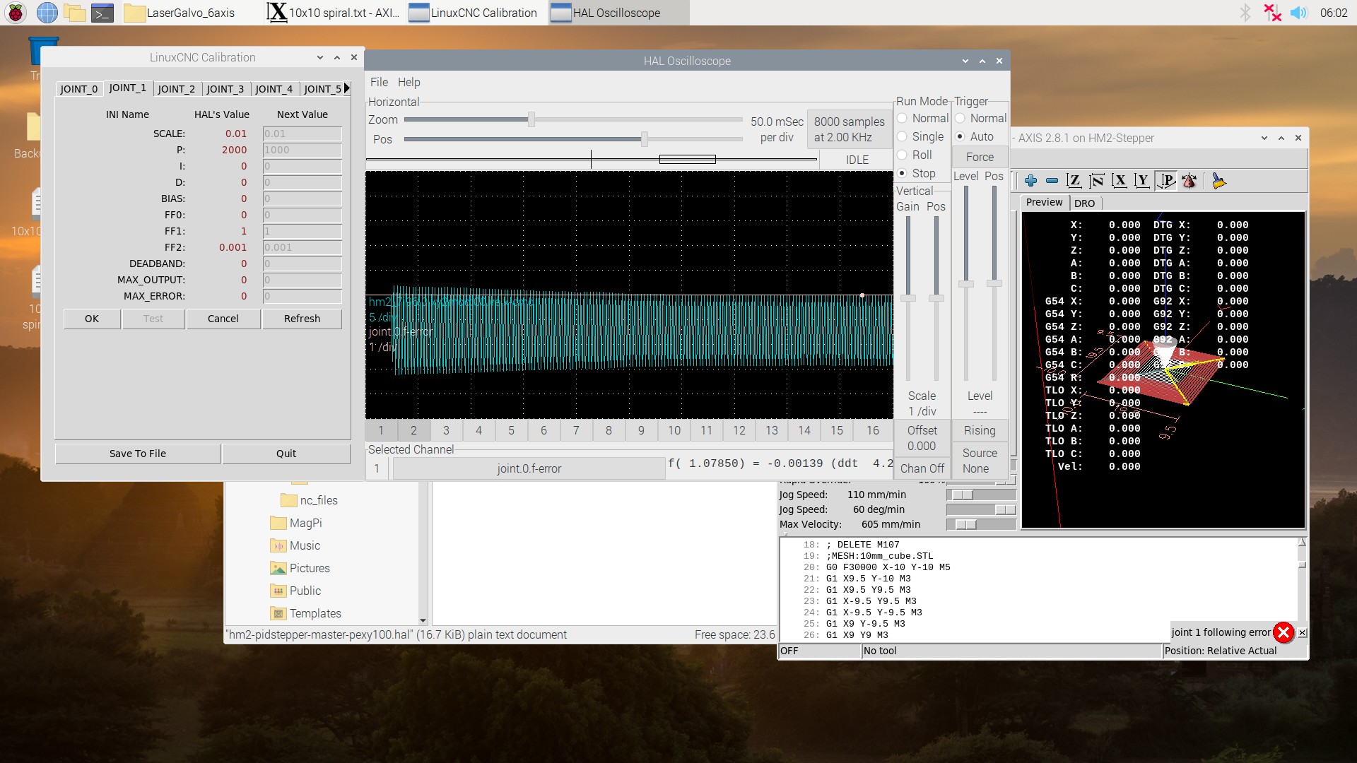

I set the ini inputs per guidance of P=1/servo interval=2000
I get oscillations at P=2000

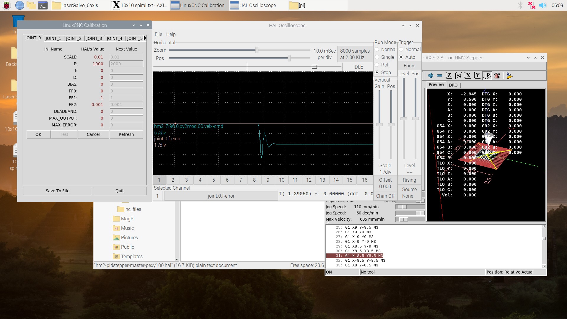

I get overshoot and ringing at P=1000

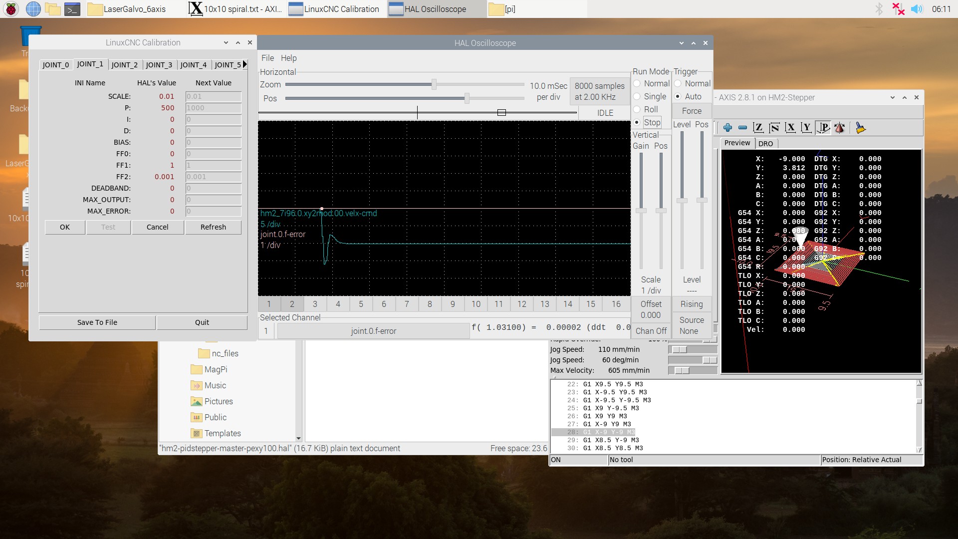

Slightly milder overshoot at P=500

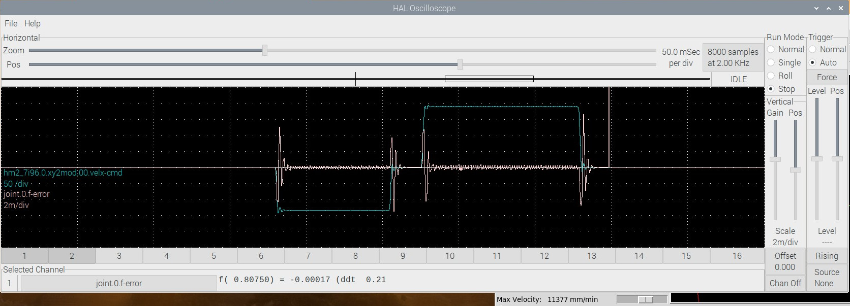

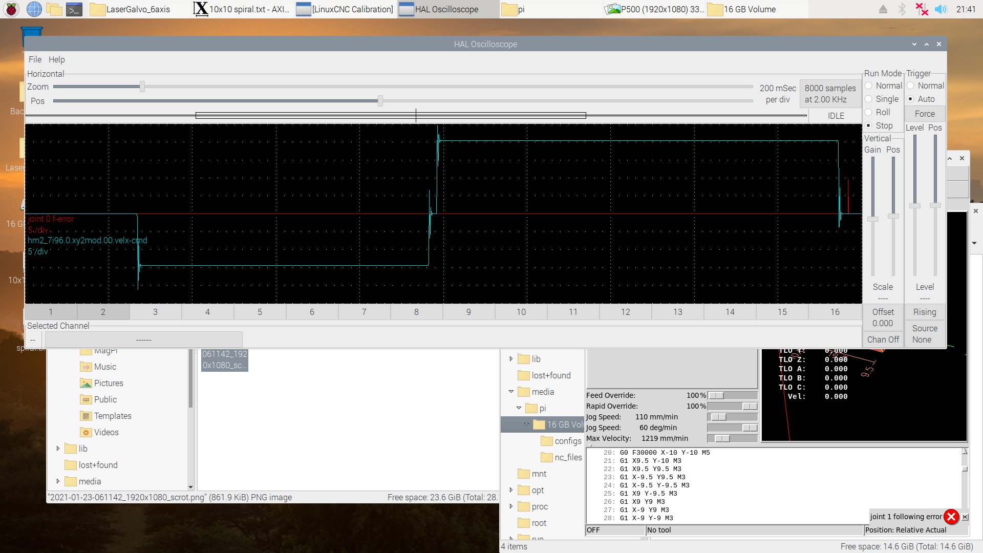

Here's a scope screenshot of the following error.
A few notes:
Both X and Y axis (joints 0 and 1) are identical setups
Max velocity and accelerations are guesses. The velocity less so as I can back out a linear velocity from the galvometer spec.
I intended on figuring out the real max velocity/accelerations based on physical limitations after I get the controller hardware up and running. By running paths at different velocities and accelerations and seeing what the machine can handle
Any thoughts on the following errors?

Replied by PCW on topic RPi4 & 7i96 XY2-100 Following Error at High Velocities
That's really odd to get a following error at 0 velocity
Can you post your hal/ini files?
Note: you can improve the control bandwidth by not setting
the DPLL write timer (comment out any line setting this value)
If you do this, FF2 can be set smaller (say 0.00025) since
this will be the approximate time between reads and writes.
Your oscillation at the suggested P values is likely due to using
the same timer for read and write, this adds a full servo thread
period delay to the feedback loop.

You would definitely want to remove or comment out this line:
setp hm2_[HOSTMOT2](BOARD).0.xy2mod.write-timer-number 1
and then set the FF2 values to say 0.00025 (this can be tuned with halscope)
You also might want to widen the ferror limits until everything is tuned
(say min_ferror = 0.01 and ferror =0.10)

OK, progress!
commented out
#setp hm2_[HOSTMOT2](BOARD).0.xy2mod.write-timer-number 1
P=2000
FF2=.00025
I can get max velocity up to 13117mm/min before it hits a following error
The galvo can mechanically/physically go faster (max rate is ~7000mm/sec), not sure whats going to be the limit of the controller?
I'll switch out the Ferror and see what it does. Will this affect the precision? Will physical errors of 0.1mm be the consequence?
commented out
P=2000
FF2=.00025

05 May 2021 21:53 - 05 May 2021 21:53 #208029
You should be able to halscope the ferror (say at .02 mm/division)
and see more clearly what is going on. The ferror limits do not
affect precision, they just determine when a following error fault is tripped.
Also note that the following error is just an apparent following error
and can be affected by residual DPLL position sample time jitter
and how well the scaling is setup to use the full 16 bit galvanometer
range.
range.

05 May 2021 22:46 #208034
OK that's a following error at 0 or near velocity
Is that an error in the command or feedback?
Have you possibly run into the galvanometer limits?
that is, are the posx or posy overrange bits set?

Replied by Limedodge on topic RPi4 & 7i96 XY2-100 Following Error at High Velocities
How do I tell whether the error is from command or feedback?
I don't have the galvometer connected right now. Those charts are dry running on the bench. I really don't think it hit the limits but I'll double check on the overrun bits
That said, the galvo's total scan footprint is 150mm x 150mm. I've been running a test Gcode with a 20mm square spiral. Crazy enough, a scale of .01 is almost perfect. I etched lines and measured with a caliper and they were only off by hundredths of a mm.
side note, once I get it up and running I'll need to calibrate a compensation file as the galvo is inherently angular being converted to linear. There will be a function of Cosine error, as you get further from center. Haven't gotten that far yet. That might even explain the slight error I measured
