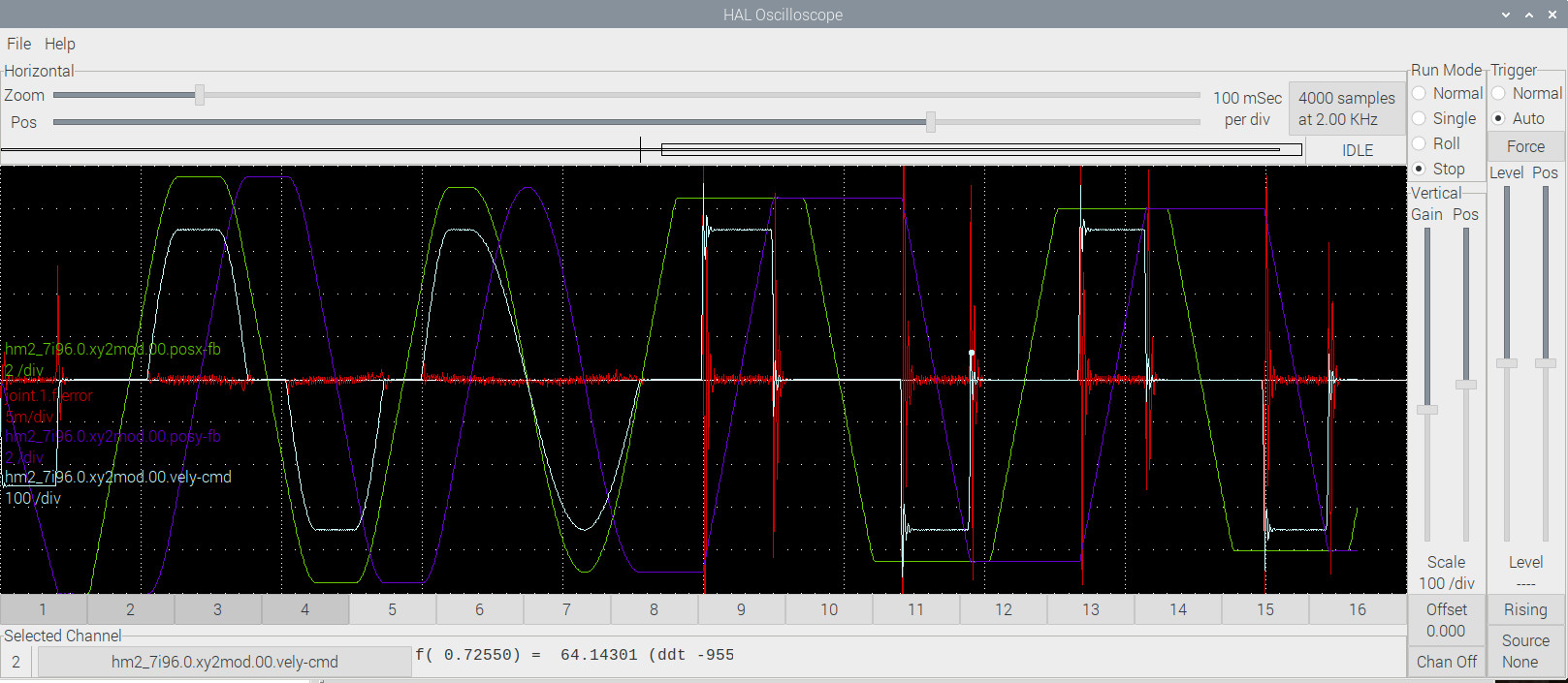

I found something peculiar in my trials and figured it's worth showing for everyone's reference. Let me know if you think I should start a new thread.
I am currently using a spindle command to M3 and M5 to signify which paths should be laser on and which ones should be non lase movements. In that way, I can use G-code to handle the on/off automatically. The spindle-on pin is wired to a GPIO and fed to the laser. pretty simple on/off switch. I couldn't figure out a better way to do this since there's not really a binary joint-on pin when the joint is being commanded. Joint-active doesn't work since it's always active. So I went with the spindle solution which does work. I just add a M3 or M5 on every line regardless of whether the preceding line has the same spindle command or not. I wrote a script that looks for G1 versus G0. Works pretty well
Example
G1 X10 Y10 M3 (laser on and move to 10,10)
G1 X-10 Y-10 M5 (laser off and move to -10,-10)
Looking at the scope of my spiral program, I noticed there is a slight pause/delay between Gcode commanded positions which should ordinary be a smooth transition.
For example:
G1 X5 Y5 M3 (laser on and move to 5,5)
G1 X10 Y10 M3 (laser on and continue the straight move to 10,10)
In the above code, there will be a slight pause (~.021 sec) at the 5,5 point
So I experimented with removing some of the M3 commands from the end of the Gcode commands As you can see in the attached image, the profile of ferror, velx-cmd, posx_fb, and posy_fb changed DRASTICALLY and I'm not sure why
This confuses me as the spindle-at-speed pin is always True so there shouldn't be a delay. I don't really understand why the left half is different than the right half just by removing spindle commands.

Wouldn't you normally use M62 and M63 for this kind of operation?
- Limedodge
- Posts: 40
07 May 2021 15:39 #208226
by Limedodge
Replied by Limedodge on topic RPi4 & 7i96 XY2-100 Following Error at High Velocities
To be honest, I didn't know those existed until you just pointed them out. Thank you!
I just tried them out and they behave the same as the "no M3/M5" chart shown above. I've got some rework to do with my ini/hal but I think I can make that work and can finally switch over to tuning velocities/accelerations.
